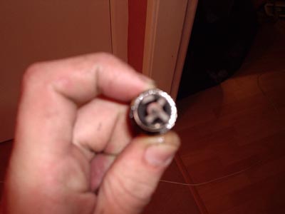

ok have just removed all spark plugs and lined up the marks and put new tensioner on, and was surprised to find the condition of cylinder #1's spark plug to be (note 2 of the prongs are still ok, one has been crushed inwards mm from the electrode at best, and other well you can see that ones gone sideways);

ok am really panicing now, was turning the belt (its on not sure if its correct yet as am in middle of panic) and it isnt making the normal tsss kinda compression noise, its making more of a wolp (lol) sound, kinda like the sound computer cames use for when swimming kinda thing if that makes sense? so am now panicing that its head gasket (reason i justified doing this swap was because old hg went, and cheaper for me to change engine than it was to fix hg)
If you have the time, best thing would be to whip the head off and have a look while it's on the garage floor. Much easier to fix there. The damage to no1 plug doesn't look good.

found the compression prob (hadnt replaced plugs after removing), timing belt fitted, new mounts fitted back and pas side, ive got the time but if i remove the head am guessing i then need a new gasket set and also need a torque wrench (and shops not open lol :p) am hoping that the #1 plug damage was just when the belt slipped then the piston (or something?) has slingshotted up and caught the plug slightly or something maybe? have got the engine crane till 4th but am thinking now, fit the engine tomorrow and get all wires in, and see if it runs ok, or if spark plug in cylinder 1 gets a smash obviously get head off and have a look (need the car 100% going by 10th as i start my new job :D)
The pistons shouldn't hit the plugs at any time - the plugs are in a fixed position and the piston travel will be the same no matter what happens. I suppose it's possible the plugs could have overheated and become damaged previously.
Fit the new plugs and see if it all turns over easily, but first you could have a look down the plug hole to see if the piston is ok. Turn the engine slightly to see if there's anything else in there of interest.
