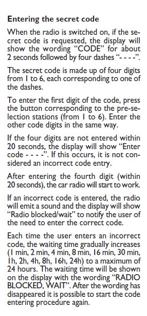

I put a lot of times the wrong code, so now it's just showing "Radio Blocked / Wait". I already have the correct code, but I do not know how to show the blanks to put it. I took off the battery and reconnect again, but it does not work.
What can I do to put the code?

The radio and ignition needs to be switched on continuously until the display shows "- - - - ". Depending on how many wrong codes have been tried, the waiting time could be up to 24 hours.

My car is turned off for more than 24 hours, but the blanks to put the code don't show up. This is the reason that I tried to disconnect the battery.
Is there an another way to put the code?
