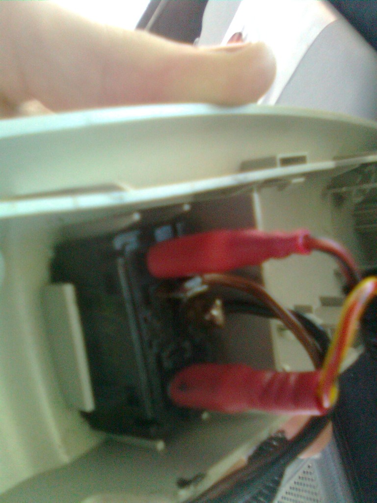

Step 2 is to check the motor, for which you will need a multimeter and a mate. (i'm doing this from memory, so it may be slightly wrong). Access the roof console, disconnect the wires from the motor and connect in the multimeter (set to voltage, 20V or more). Get your mate to start the car, then press the sunroof button. If you don't get a voltage, you've got a wiring problem. If you do get 12V, then either the motor's dicky, or the mechanism's jammed.
