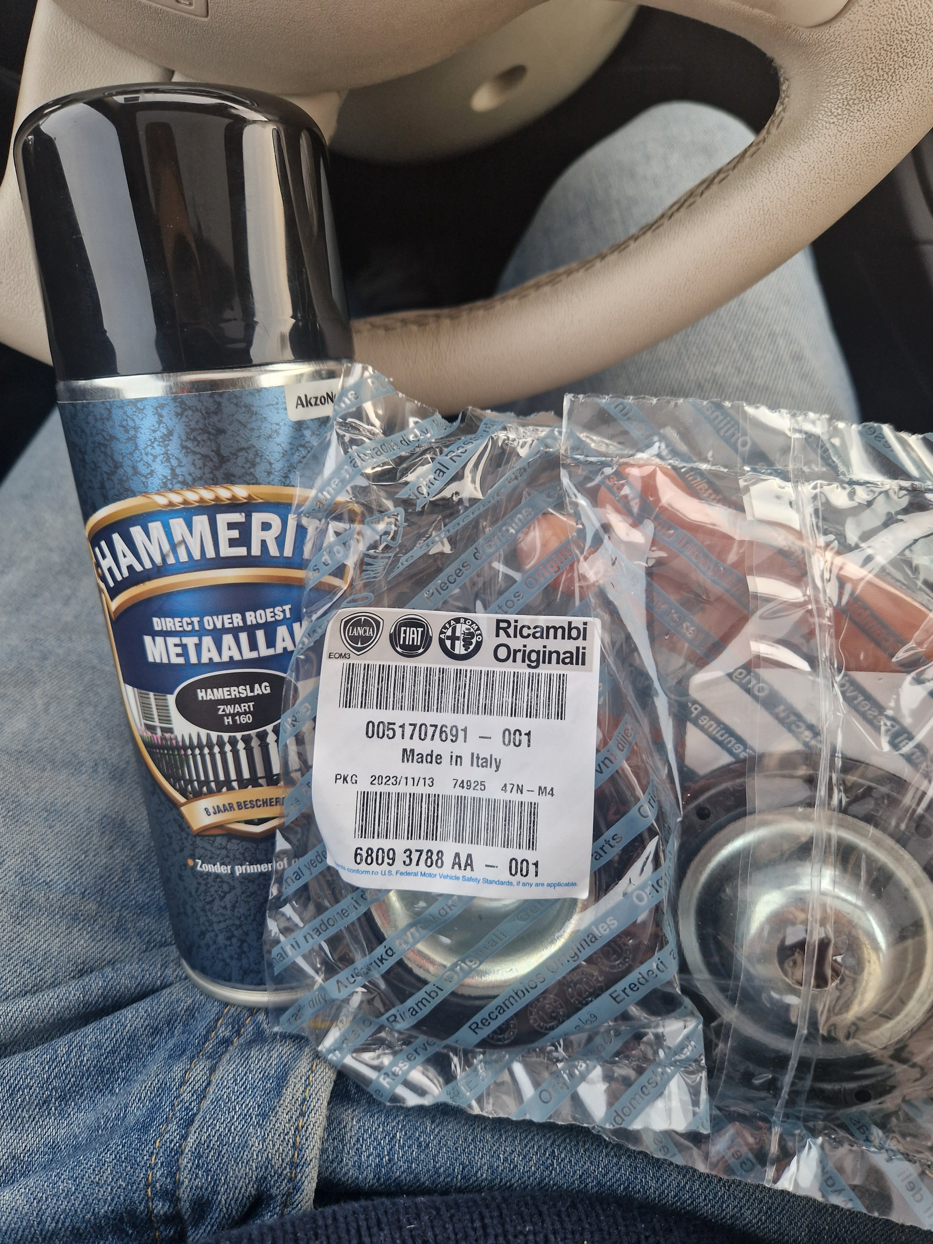

No, I need the top cups. I think I've found some quite local. He's calling me back within the hour. Thanks for the tips.
PAINT THEM WITH HAMMERITE! sorry cant help with availability!
Will be painting them tonight. I'll also slap some grease on them and seal the covers with some silicone. Thanks all!
