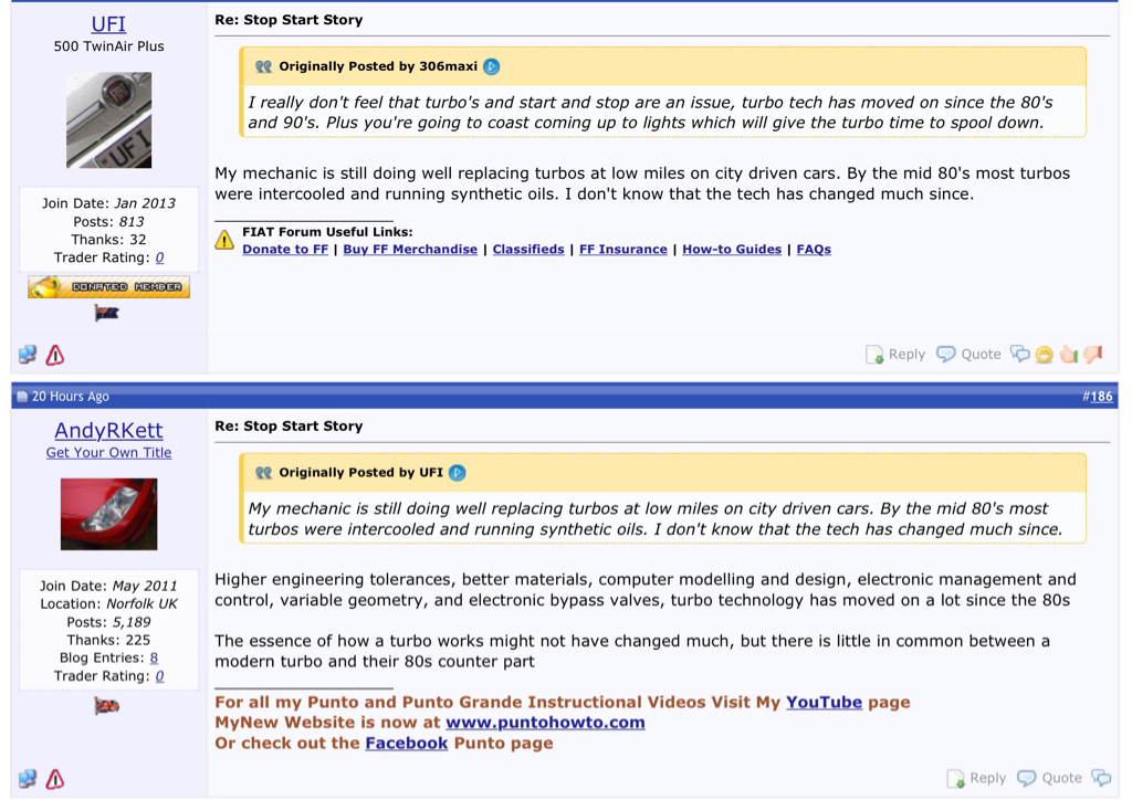

Maxi stated that technology had moved on so didn't see that S/S was going to be much of an issue to a modern turbo.
You stated that technology hadn't changed since the 80s....
The example given were of how technology had moved on since the 80s including VGTs but also materials, design, tolerances and electronic control.
Look see!
The improvements in materials, tolerances and design means that bearings are far less likely to fail on a modern turbo, than they are on a unit from the 80s, this is the sort of thing I suspect Maxi was getting at, VGTs was just an example of how turbo technology had moved on, where you were claiming it hadn't.
