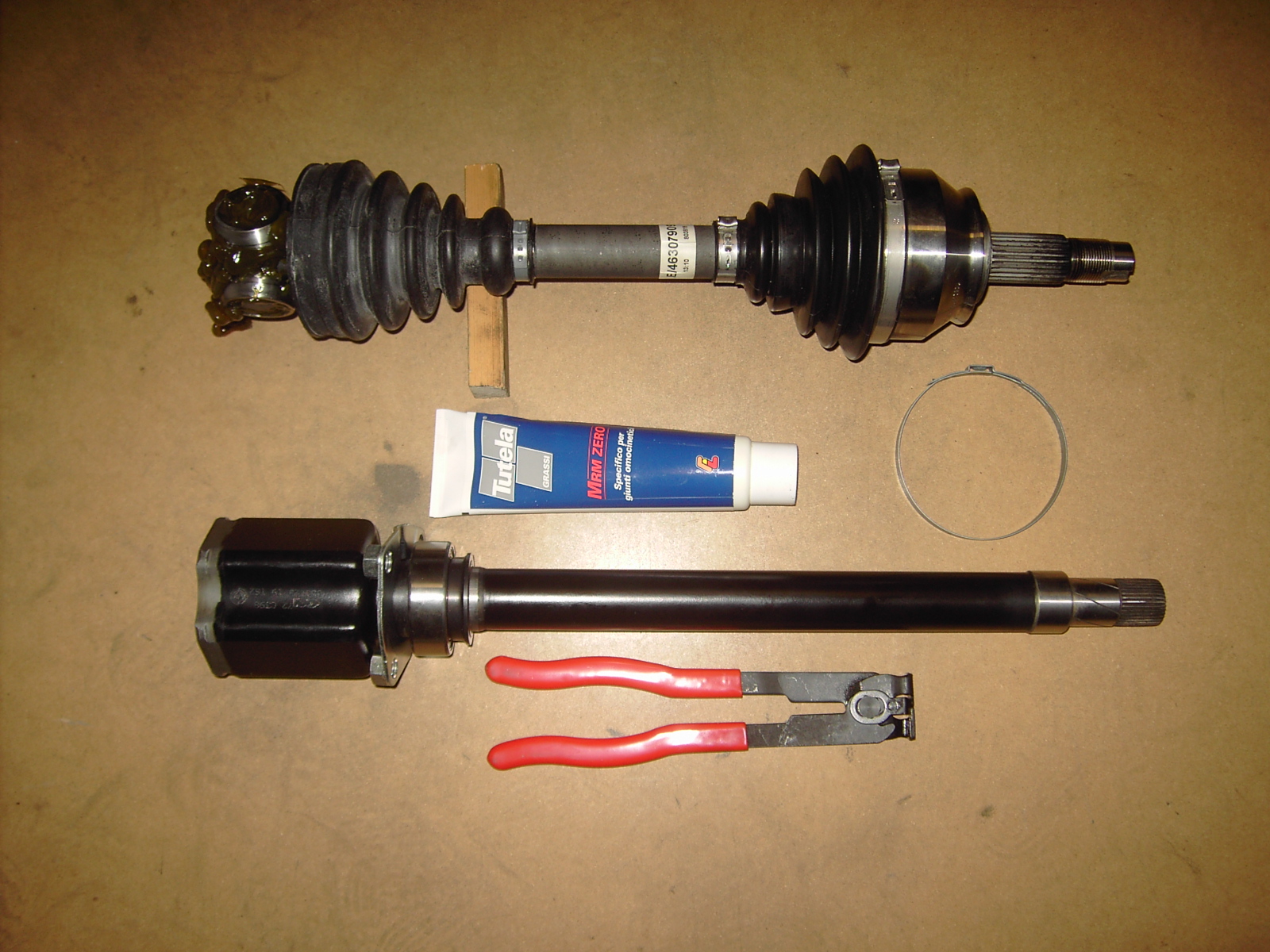

When I fitted a new O/S JTD driveshaft a few weeks ago, I used 1 full tube, plus about 15gm from a second tube, plus a bit to allow for what was stuck on the inside of the "empty" first tube. So yes, I reckon I got it within +/- 10gm.
I phoned every local motor factor for it (or equivalent), none of them had ever heard of semi fluid grease. Local Fiat dealer said they just use normal CV joint grease for the tripod joint. That may be OK for their customer's cars where it could last a couple of years before they have to take the car back and are told "you need another driveshaft but the previous one's out of warranty now", but I figured there must be a reason why Fiat specify a different grease, so I wanted the correct one for my car.
I eventually phoned Petronas (01727 811213), who make Tutela and Selenia products. They gave me a list of companies that had bought MRM ZERO from them. Northgate Garage, (a Fiat dealer in Canterbury 01227 828200) posted me 2 tubes that arrived the next day. £3.48 each + postage.
