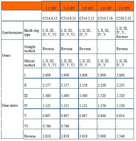

Hey everyone,
I was doing some research on the fiat stilo and its gearboxes. I saw on Wikipedia that the 1.6 although rare did have a 6 speed option.
Can anyone confirm this?
Is the gearbox the same as the smaller engined 6 speeds? Just with a different bell housing for the different family of engine?
Thanks for the help!
