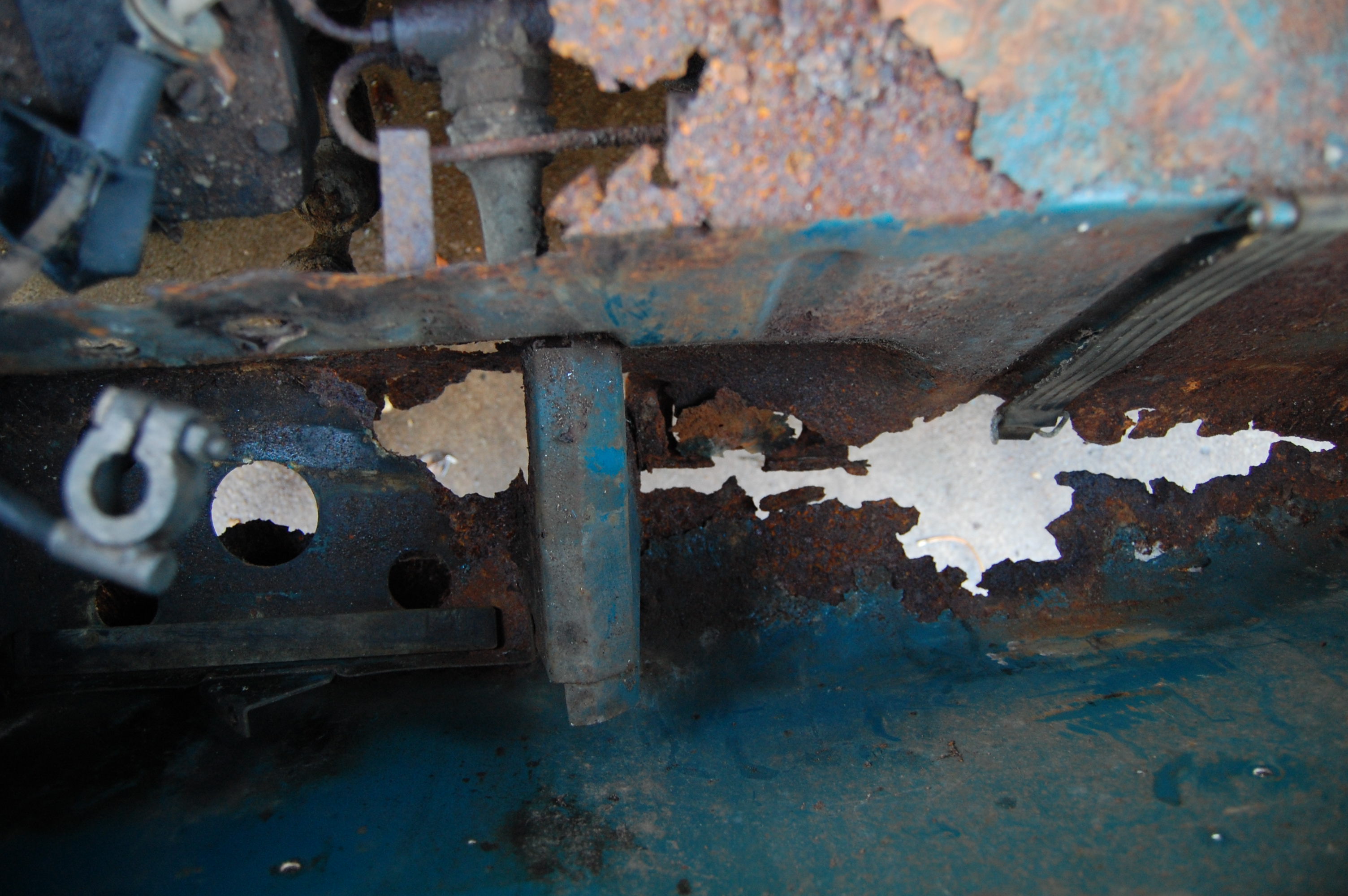

I noticed in this pic that the drain 'hole' is sealed up (on left of pic). Is this the case for most others? Mine is open, and whilst I see the need for a drain hole, I also wondered about leaving it open as it is now, and not replacing it with a hole and a removable plug.
What's everyone's point of view?
I think it has just closed up over the years Steve when the front panel was last replaced. The ones on either end are open but TBH I don't ever recall seeing any water down there but there again you can't see much with the spare in place.
The water ingress likely in the bonnet area if you have all the rubber seals in place is likely to be around the headlights chrome rings. You can buy a rubber seal to go around the headlight rings, which I did buy but it makes getting the headlights in a really tight squeeze also I came to the conclusion that they are more likely to trap water, so I took them off.
Also behind the battery aren't there holes to the outside world for ventilation of the battery? I seem to recall they are pretty big as well so I would imagine quite a lot of road spray ends up there, hence why so many are rotten down there. I would imagine with today's modern batteries there really isn't a need for them.
Tony
I think there should be three of those holes Steve. I would leave them clear. there isn't likely to be any water coming up them and whatever you do there will always be water needing to get out.
On every Fiat 500 I ever owned in the '80s, this area was always the rustiest. Having several places to exit means more chance of a puddle not building up.

TBH I didn't even know there was a third hole in the middle, I will have to investigate and see if I can open it up and slap some waxoyl around it. It probably make sense to squirt a bit around all of the well really, as you say Peter it is very prone to rust.
Thanks for the replies Tony and Peter. Here is what I have, two well defined drainage holes...
(Sorry about poor quality of pics, taken from ipad and light is not so great in the garage)
So from your replies, is the consensus that I should leave the two holes in place, or is the one on the right in the wrong place? Where is the third hole supposed to be?
cheers, Steve
Thanks for that Peter, so it's looks like they are all in the correct place, just didn't notice the one under the battery tray as the front part had closed up. I'll tidy them up.
It's good to know that they are all in the right place. :)
