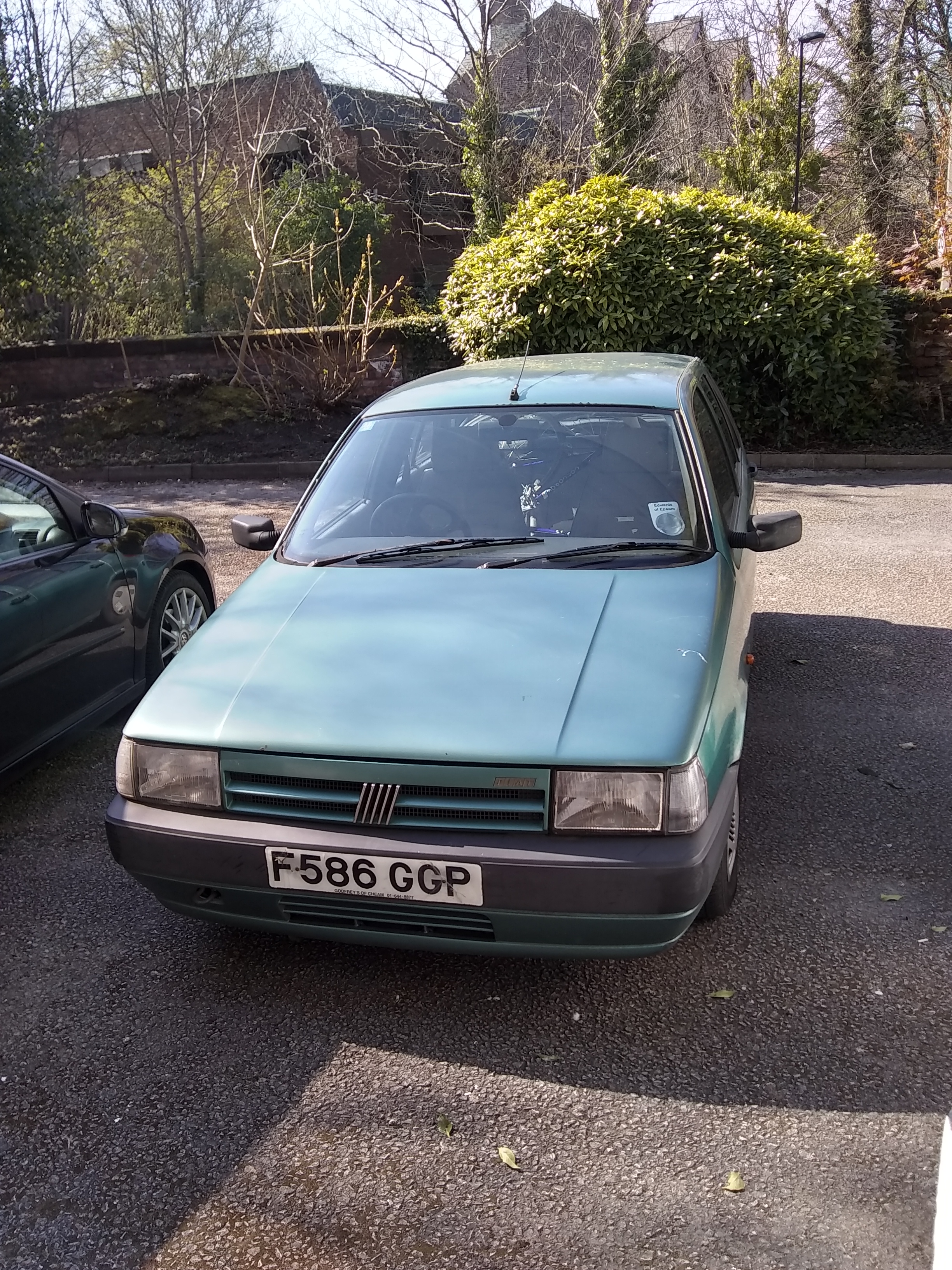

I decided to bite the over £300 bullet and attempt to save Salvo.
He's back! MOT passed yesterday.
Some light in the coronavirus gloom. At least I can see him from the window!

A small price to pay for keeping a very rare car on the road. [emoji846] Have you thought about having the entire underside cleaned off and rustproofed? [emoji846]
Yes, I'm definitely going to sort that when this crisis is over! Should have done it earlier, but life got in the way.
