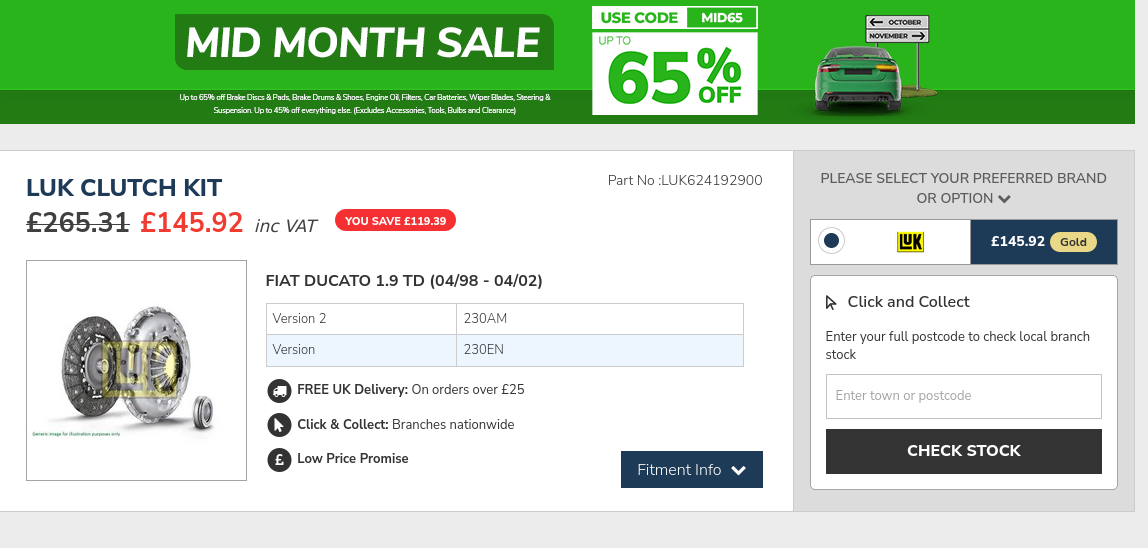

Thanks l actually found this same one on GSF parts and was going to call the garage on Mon. Not sure if they have tried the same one or not as they have tried 3 to 4 different ones. Thanks for your excellent response and solution.It may be this according to wikipedia in the bottom details, I don't know if that ties with your log book V5c details? Maybe brouse Fiat Ducato in wikipedia search and see what you think

I just put your Reg. in a GSF parts supplier and got this, is it one your garage tried, it is an LUK make? Also on eBay if an XUD9 engine there are several clutches advertised.
