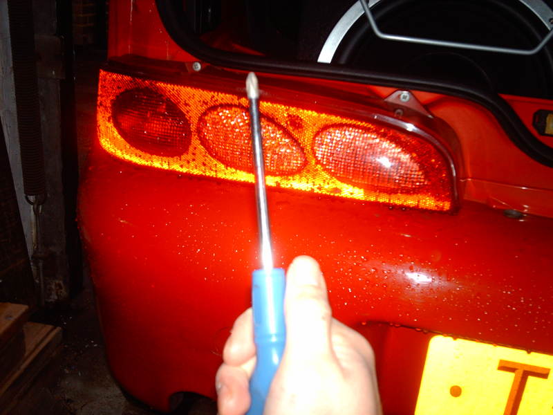

2. Proceed to unscrew the two screws you can see in the picture, on top of the light cluster.

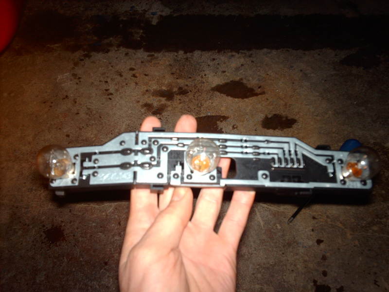

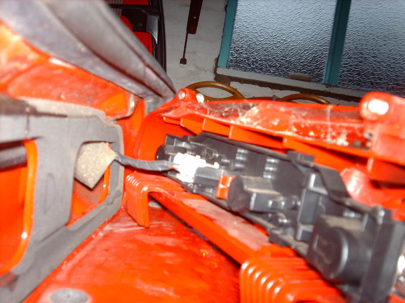

3. Unhook the light cluster (you can see where the cluster hooks are and what they hook into in the picture), before pulling the cluster fully away from the car, unclip the wiring plug by pushing in the tab on the bottom of the plug and pulling.

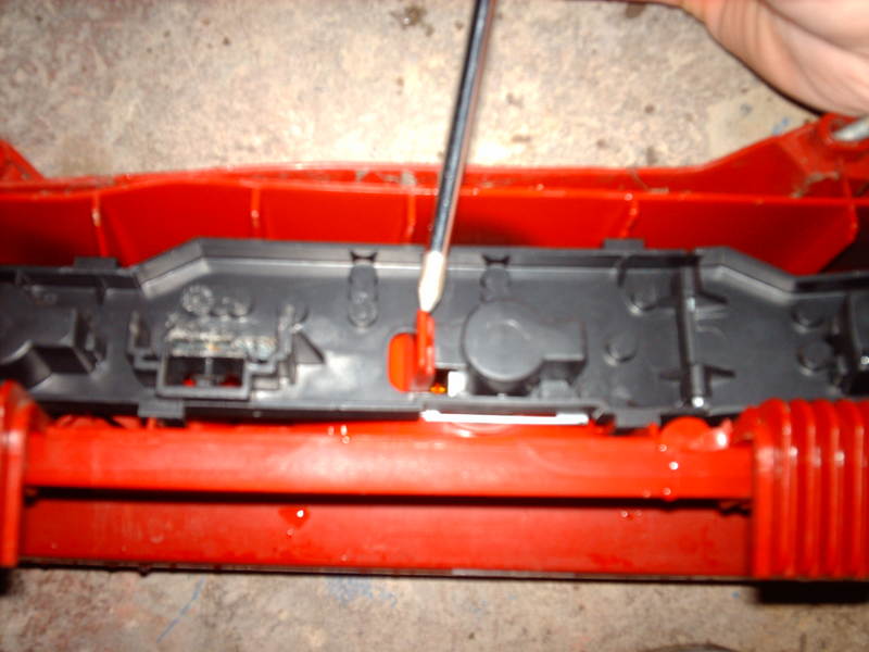

4. The wonders of FIAT design mean that all you now have to do is push the clip the screwdriver is pointing to aside, and pull the bulb holder out. If you snap that clip you are mightily screwed so be careful with it!
5. Admire/replace the bulb/s

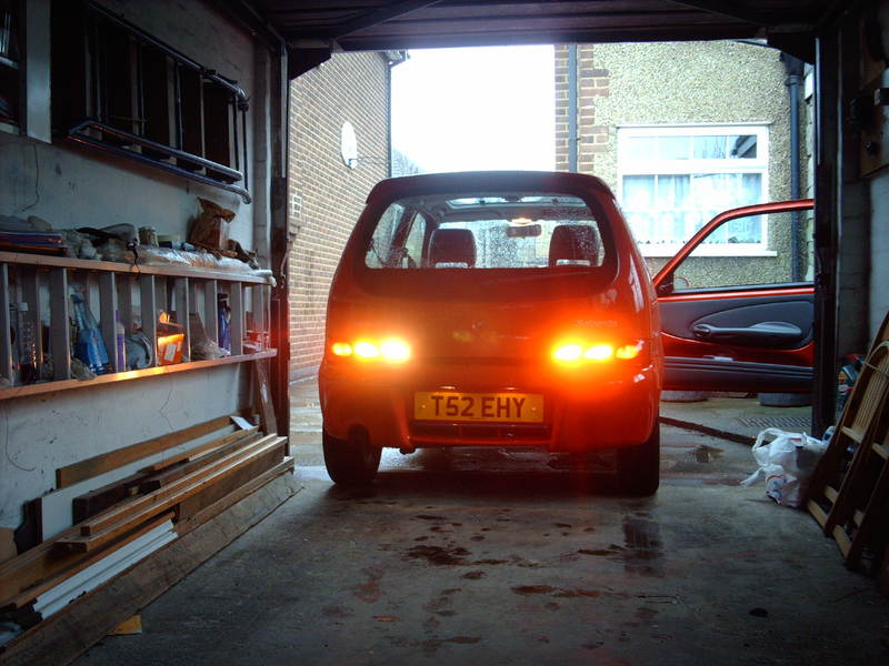

6. Refitting is a reversal of removal. Shut the boot and sing and dance as everything (rear light related) works!
