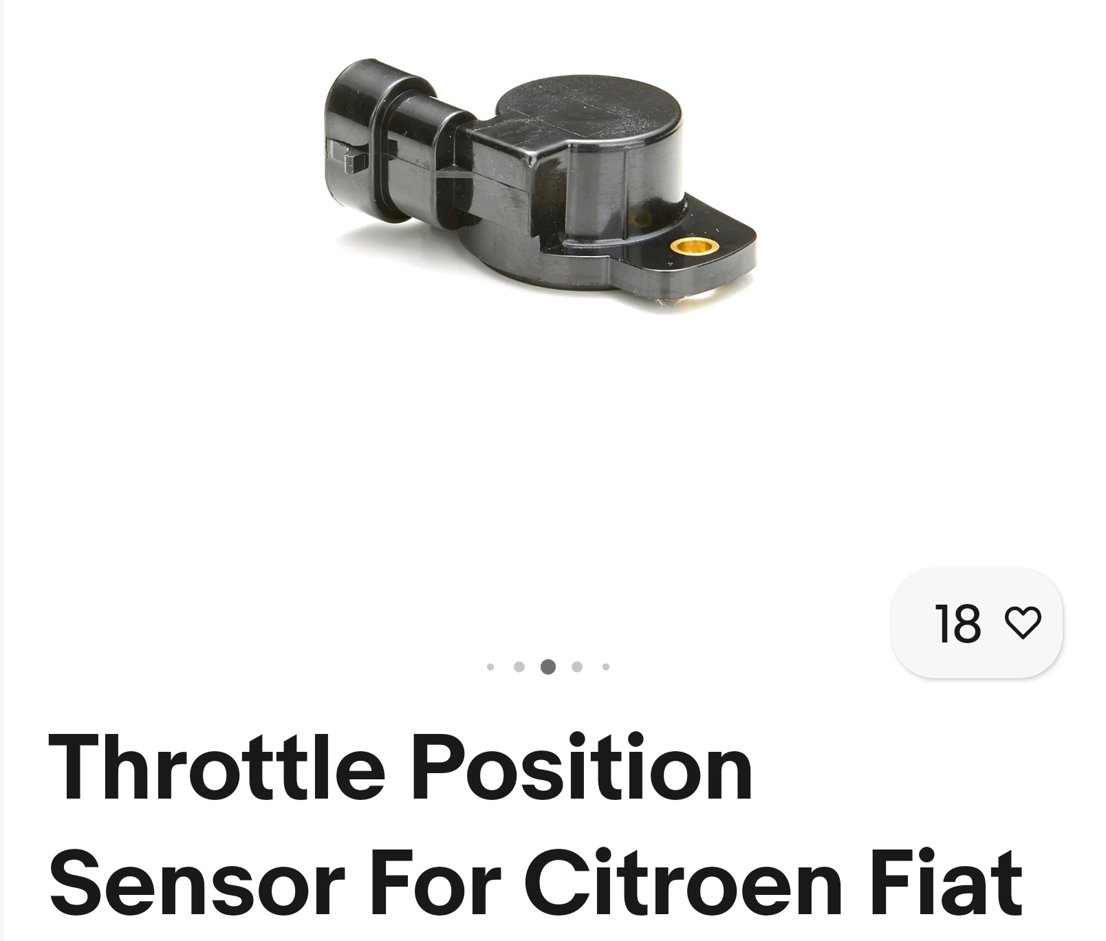

Broke down yesterday couldn't get car to go into gear 1.3 Multijet Engine Automatic Gearbox..AA Mechanic said Fault was the Throttle sensor on Engine..Had warning on Dash Saying Check Transmission See Handbook I've ordered new Sensor but does anyone know where it is located under The Bonnet On Engine or Gearbox...Thanks
So we have a dualogic gearbox that's broken down and it's a 1.3D
With according to the AA an engine sensor
And the dash saying its a gearbox error
First step would be to read the actual code
It's likely to be one of the sensors on the gearbox, there's a couple
I doubt the throttle position sensor would give a check transition error

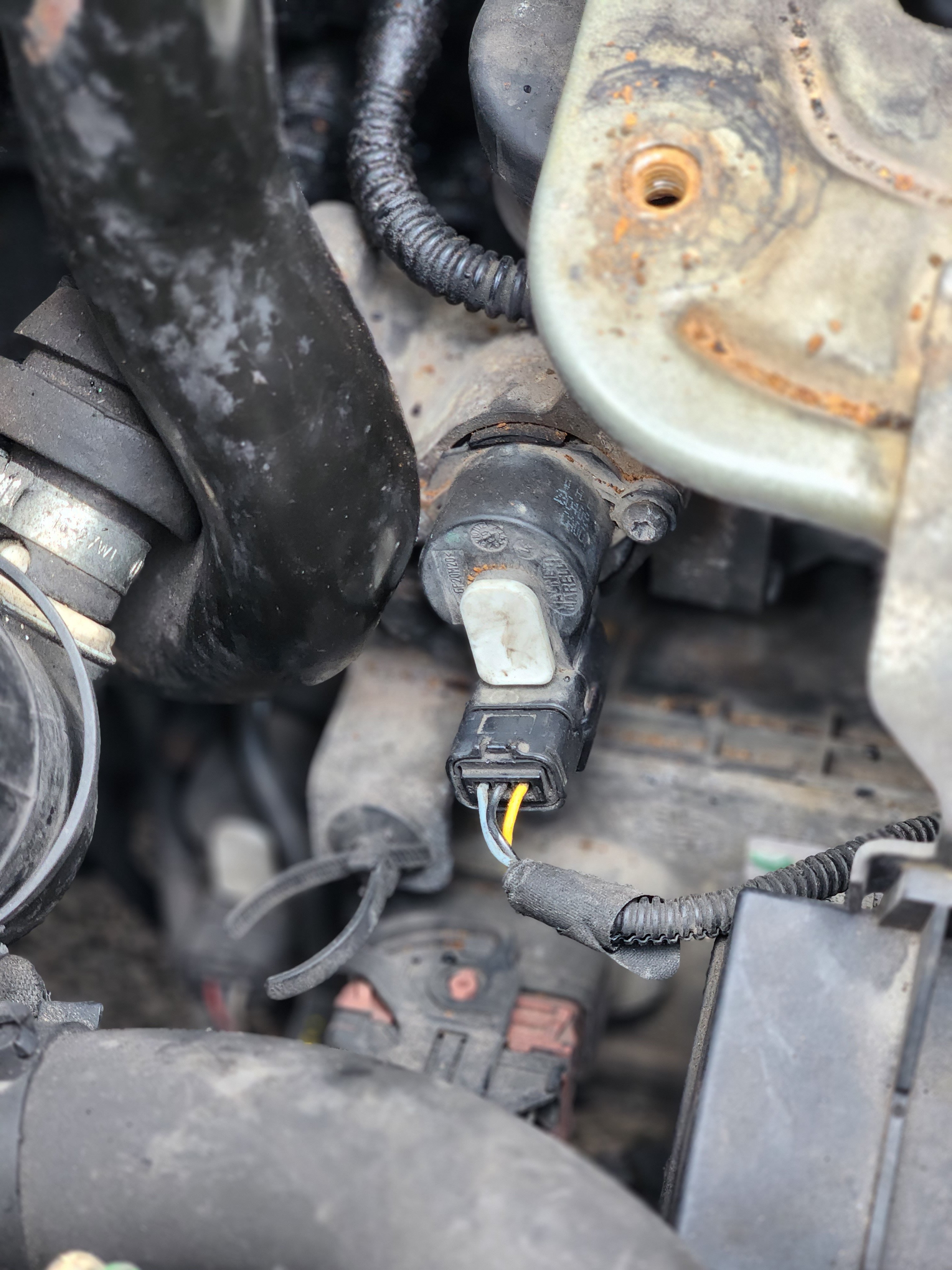

I found location I took coolant tank off it is easy to get too now

I am at confused dot com
That's the Gear Engagement Sensor
Not the same as the title or the first photo
But quite likely to give the dash error for gearbox
Scanner probable give a P0914? error
The electric connector has a latch, you have to push it down before pulling part

OK thanks very much bit confused with the proper name for it...🤣
Most of these type of sensor plugs have a toggle / latch
You have to free that latch then try a wriggle...
See if it will go slacker..
Then gently pull
If it was me.. I would wriggle the connector a little..
The reconnect the battery🤔
Turn on ignition.. See if the error has gone
As I said, sensors are pretty tough.. It's as likely to be a poor connection 😉

Hope so Thanks M8..il let you know
