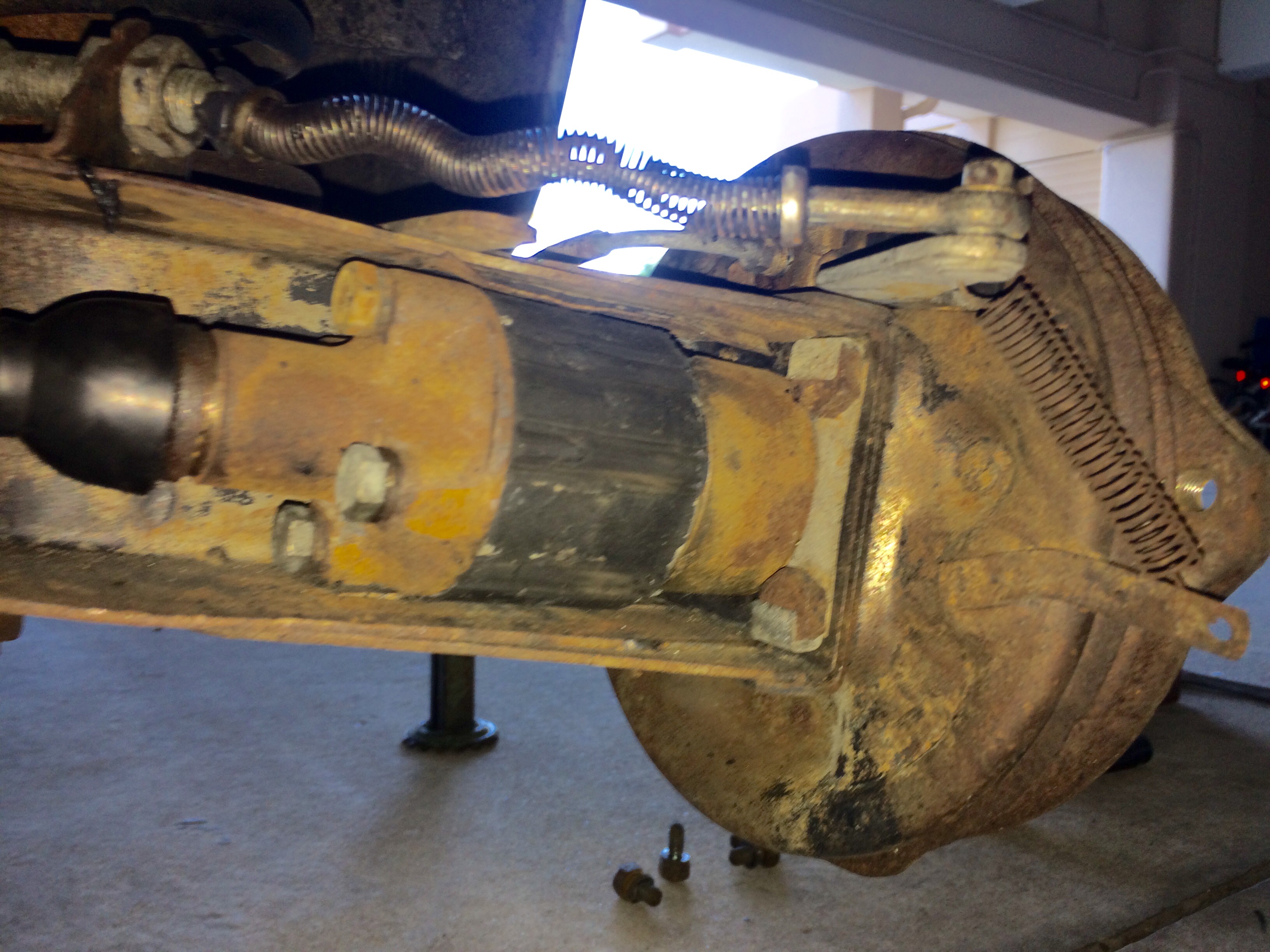

My car had a knock knock sound that was a lack of grease on the splines of the drive shafts.

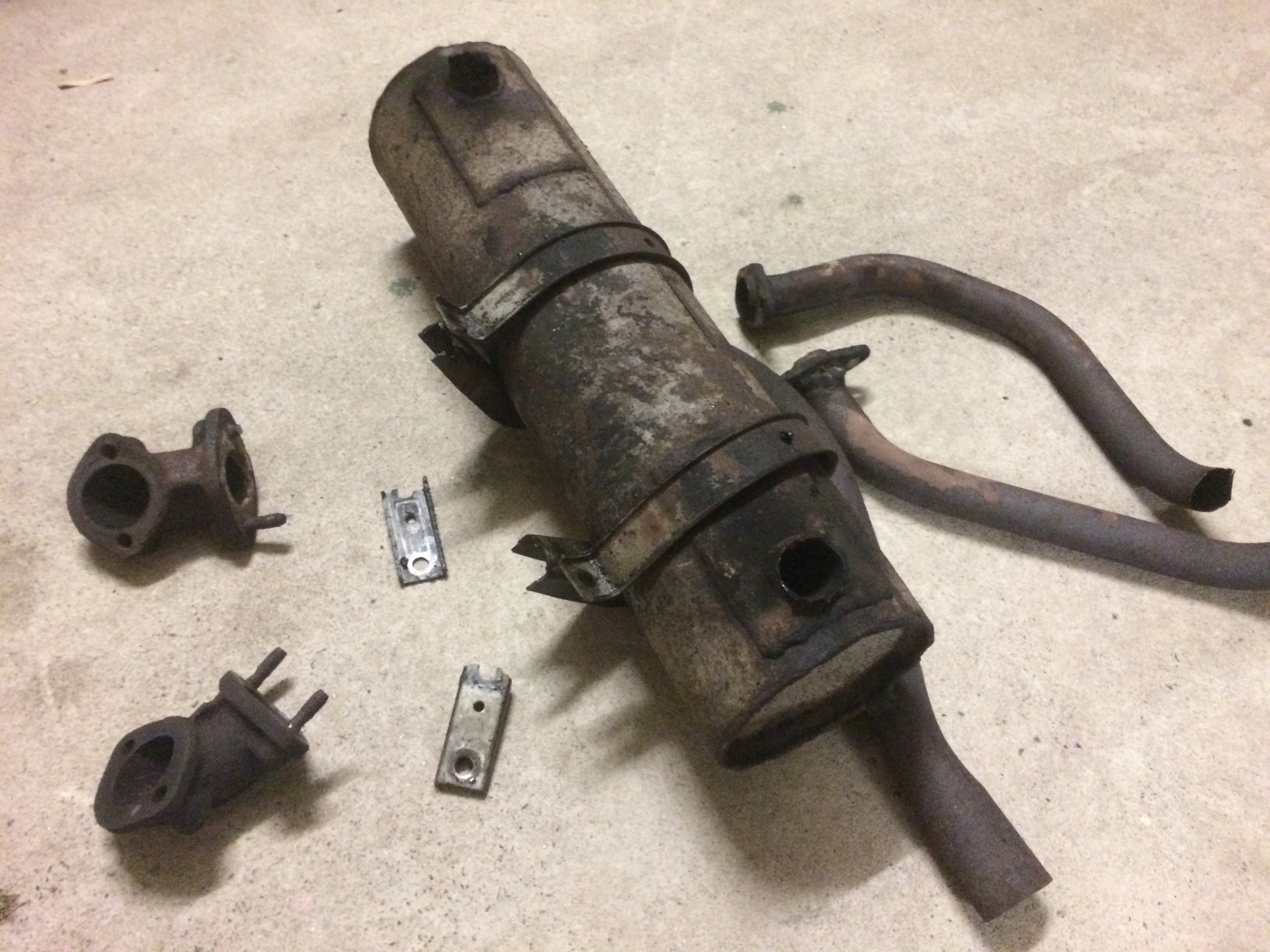

Back from travels and straight back to work. Thanks to the incredibly generous Chris Bambino I had a beautiful replacement exhaust awaiting my return.
I've just pulled off the old one and you can see how tragic it was. Pipes completely detached from muffler, and brackets both cracked. Unfortunately in the process of trying to undo the nuts from the exhaust to the manifold, the bolt sheared right off. So it looks like the shopping list will now have to include a new manifold (or 2, though the current one looks pretty good), a set of gaskets and brackets. Regardless, I'm proud of myself for getting this far given my novice status.

Now to work out where to get the exhaust stuff - a cheaper euro seller that requires patience awaiting delivery, or a local option!
In the meantime, would anyone be able to advise if I can drive it as is, just 50-100m? I'm going to have to move it from my neighbours garage soon :(
Also, I notice Axel Gerstl sells a manifold that states fits both 500 and 126. Meanwhile passione has them as two separate products.

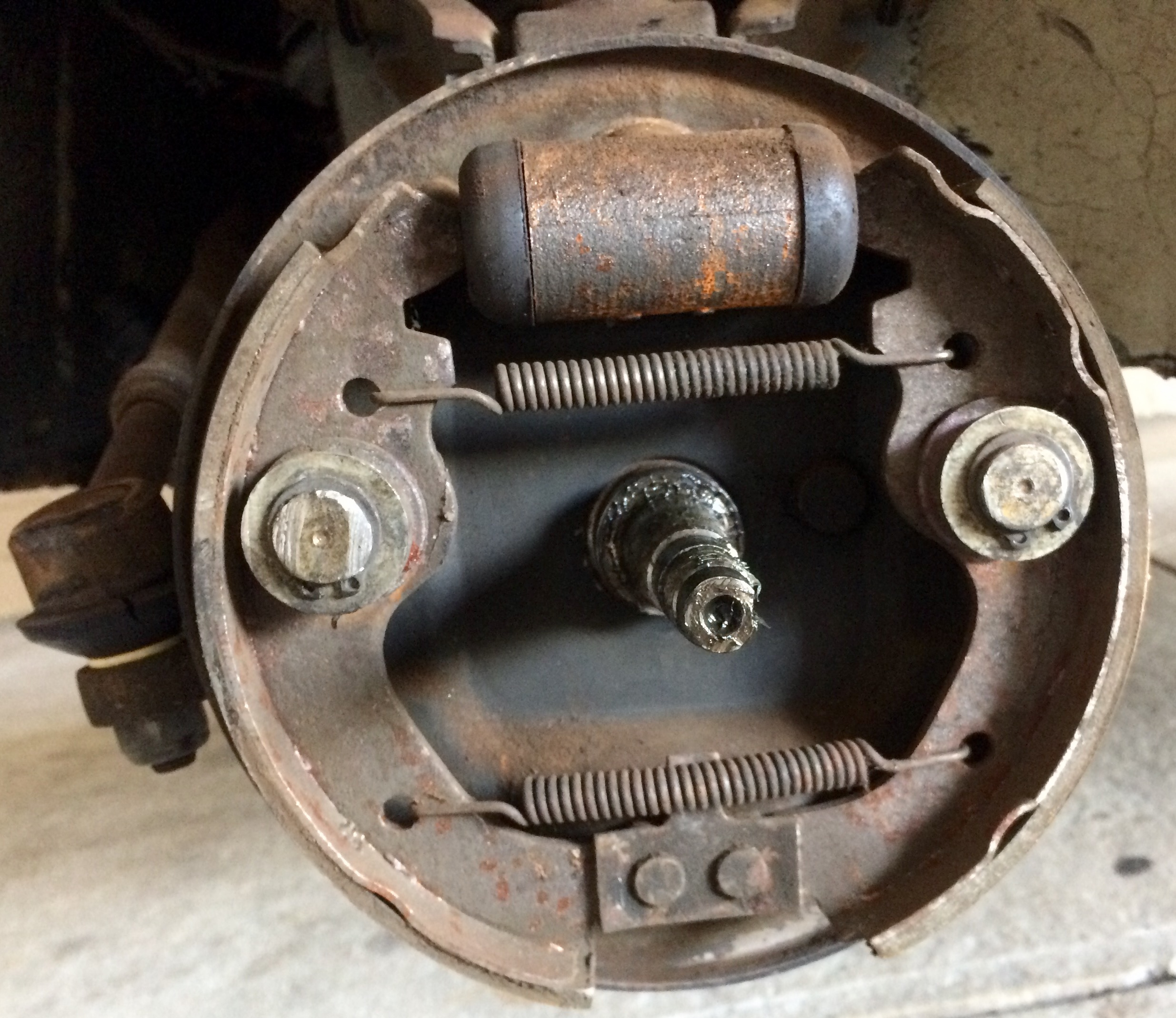

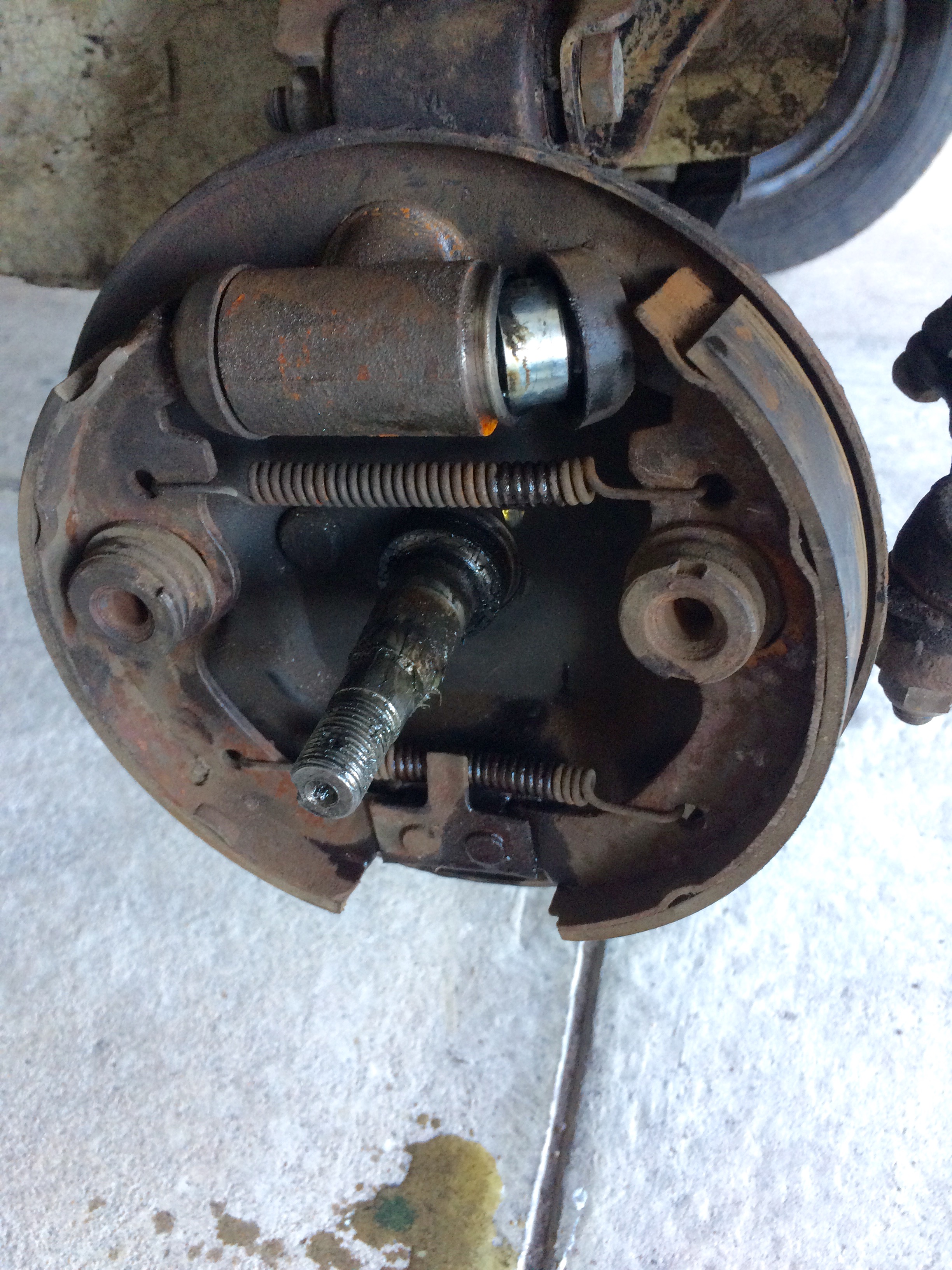

While the exhaust is off and I'm trying to find replacement parts for it, I thought I'd take a look at the brakes to see if there was anything obvious that might be causing the knocking issue - present while driving, worse when braking and oddly seems louder when riding the clutch though could just be quieter engine.
I noticed that the rubber boots over the drive shafts were off and one had no grease at all on it. At least that's what I think the first two photos are of. So as 1500500 posted that he'd had some knocking due to this, I greased them up and pulled the boots on.

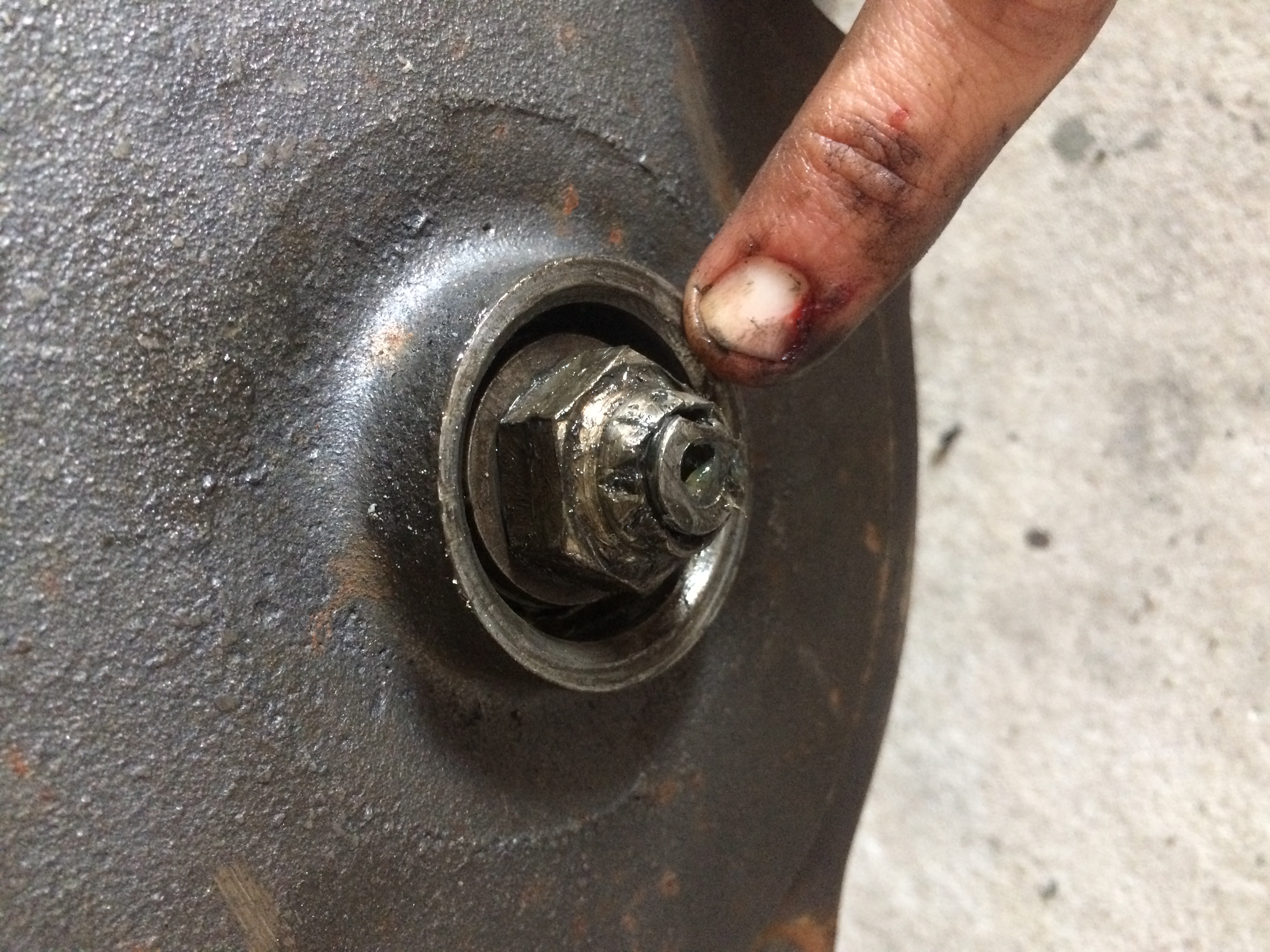

Then to the brakes. Well I think they're ok, for 55 year old pieces. I couldn't pull off one of the back ones. And then made a rookie error of depressing the brake pedal while the front was off - the shoe and part of the cylinder popped off, leaking brake fluid! Now I think I have air in there as the brakes are softer but go firmer with pumping.
Thoughts on if I just need to bleed that one brake to fix it?
One of the front brakes that seemed to be a source of knocking / grating shows some fresh looking wear on the front of the left adjuster. It can be seen in the pic, where the metal has worn down a little. I'm wondering if the shoe wasn't seated properly and that was the cause of the noise. The nut that I'm pointing at wasn't very tight when I opened it up, wonder if that could be a cause?

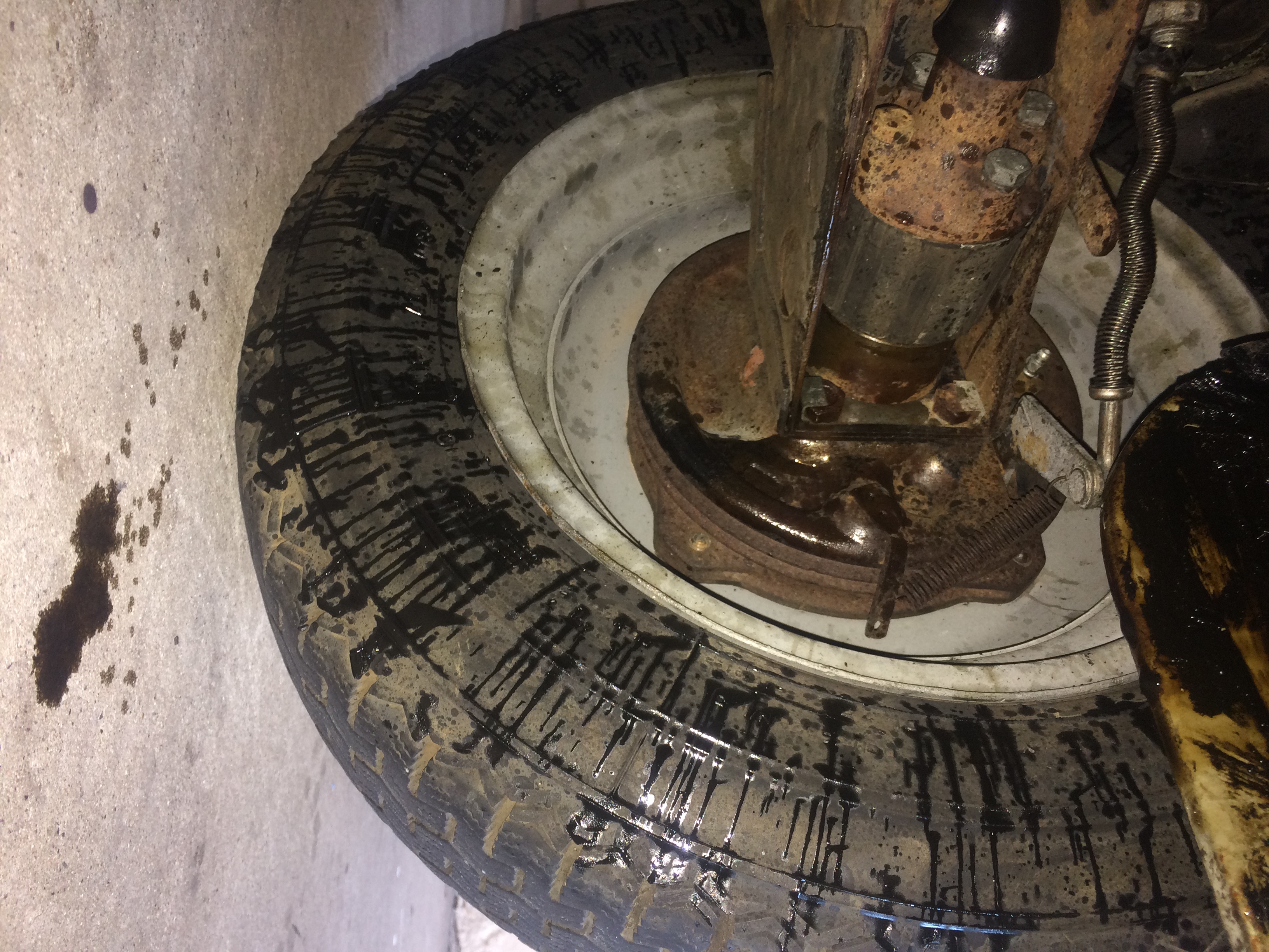

I took it out for 100m to get the brakes to self adjust, forward and reverse. And then...
Oil! It seems to be spraying from somewhere. Off to the right wheel (when looking from rear) and around the chassis basically straight through the space the exhaust would have been. Im wondering if removal of the exhaust has either opened up a space that the oil is coming through, or it has changed something internally and caused the engine to spray it?

Hi BC. That nut is not meant to be particularly tight; the important thing is that it should have been peened (chiselled?) into the groove and not be able to move from that position. If you grab the top and bottom of the brake-drum it should rock almost imperceptibly; more than that then it is loose and you will probably need a new nut.
The bottom return spring on the shoes should be under that tab rather than over it , as it is. That might make for funny noises and unusual wear under braking.
I can't see how removal of the exhaust would cause that oil leak unless it has revealed that you already had a serious head-gasket or pushrod tube issue. Chances are that it's something simple like you have disturbed an already damaged rocker gasket. Best to clean it up and run gently for a moment to try to find out where it's coming from.

Eagle eyes! Thanks Peter fiat500 I can't believe I didn't spot that. I have a feeling that's the cause of the issue, and when I reassembled it I did put the spring behind the tab and it all seemed much more secure. Yet to confirm the noise is gone, exhaust still absent but I really appreciate the help, looks reassuring.
I've run it slowly and can't see any oil leaking at idle, it must only come out with some revs applied. I'll have to pull out the 'cruise control' handle and see what happens at faster idle speeds. If it is the rocker gasket, is that a terrible job for an idiot to replace? Fingers crossed it isn't.

There's a new posting, by Phoenix1, that coincidentally might explain the reason for the oil leaking onto the right rear wheel. I hope Phoenix1 won't mind if I paste his posting here? :worship:(y)
"I had a worrying amount of oil in the engine bay on the right hand side near the coil etc. Found out because I was running without the exhaust box mounts for a short trip ,oil was squirting up the empty bolt holes. They are not blind as I thought but go through to the sump.Mounts now fitted everything now ok."
So, it would seem that, that is the explanation for BC's oil spray.
That will definitely be the problem. It didn't cross my mind because actually, they are not or shouldn't be bolts but rather should be short studs. But obviously they do unwind and although I haven't encountered that problem, Tom the hobbler recommends a little fix to prevent it happening when the engine is back running again; he might pop up and explain it. (I would just use threadlock fluid.)

Indeed there was one exhaust bracket mounted to the sumo via a bolt. The rest were all studs with nuts. So I'm guessing that one is the culprit as there lies a hole where it used to be.
