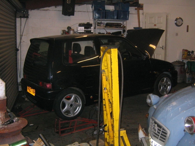

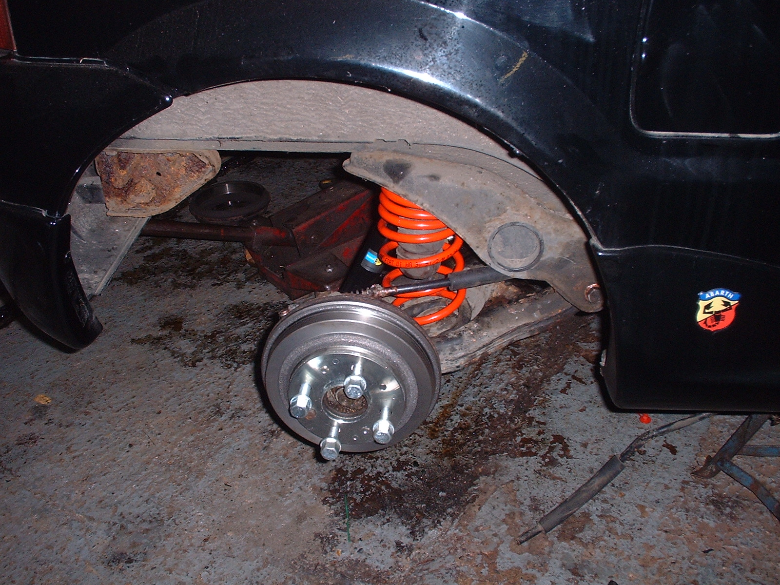

The springs are a nominal drop of 40 at the front, 35 rear I reckon there is enough clearance on the bump stops, I'll look at them again now its been run for a few miles.

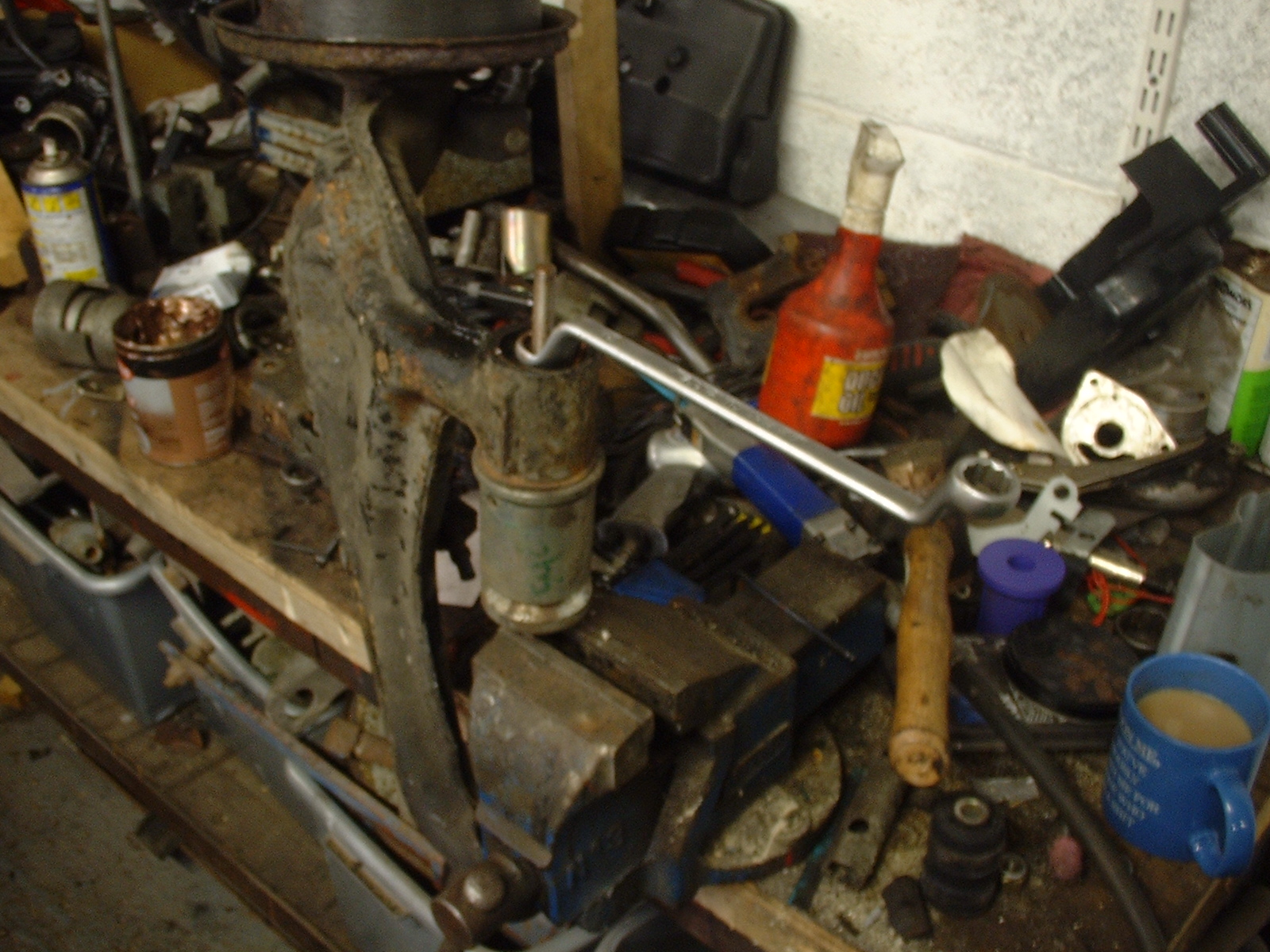

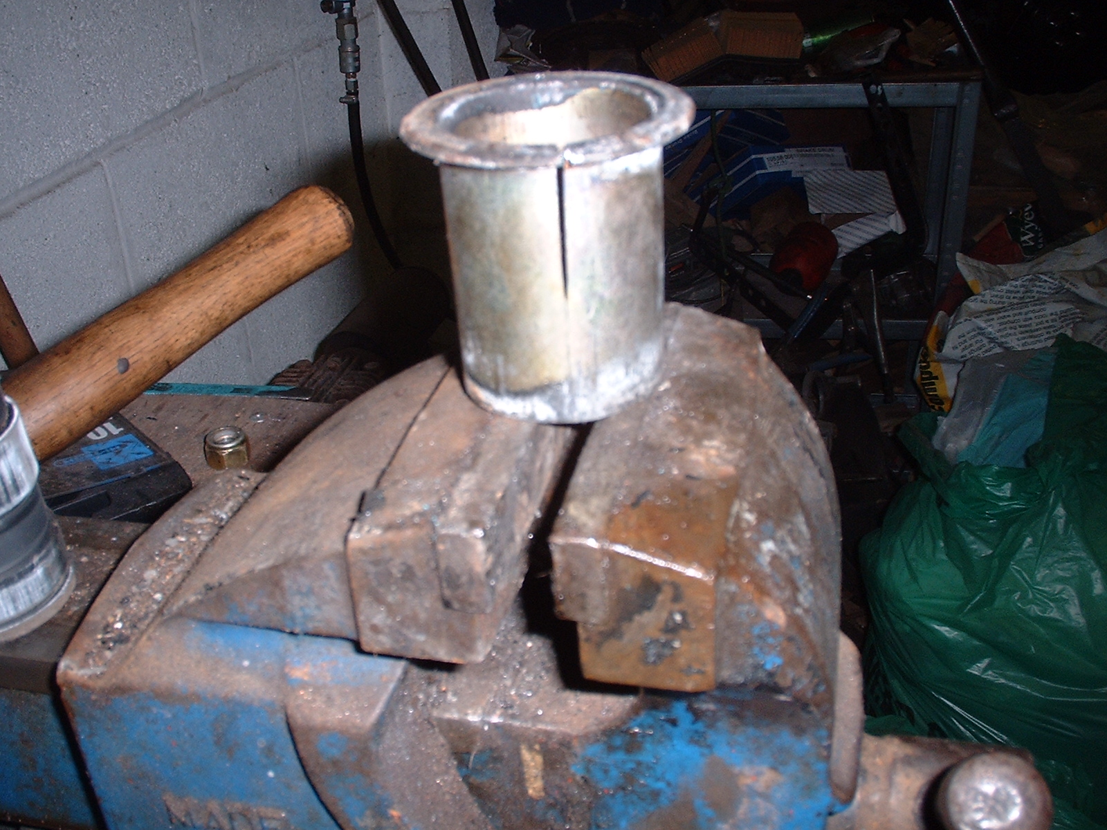

Powerflex bushes are good, the car is rumblier than before, but not noisy. There again it also has very stiff progressive springs so I altered more than one thing at once.
