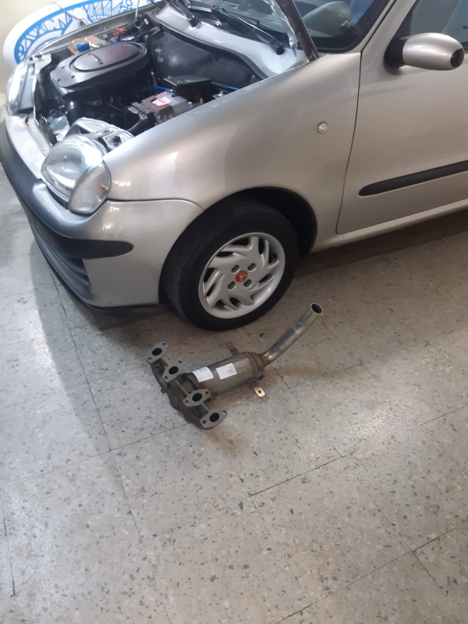

Hello again, I went to pass the MOT (annual technical inspection) and it did not pass emissions. I take it to the workshop (second workshop) they change coils, spark plugs and put injector cleaners and pre-inspection fluid and they tell me that it is ready. The next day the engine light flashed fixed.... Since I had to pass it within 15 days, I covered it up and went to the inspection, but it also stopped. Now I have bought a new catalyst. I hope that's it. This fiat doesn't want to circulate again!

Good morning, we still have problems. Changed the catalytic converter with a new one, the engine light continues to flash. I have used a co2 machine (amateur) and it continues to stop. I don't know what it could be anymore. Probes give MOT values well.

If there is a leak where the exhaust maifold/catalytic converter is fitted to engine then oxygen can enter exhaust and make the car overfuel, flooding the engine. This is one of the only things that will make the engine stall in my experience.
The labda sensors can fail - have they been replaced?
Also are the two lambda sensors connected to the correct plugs?
Also check HT leads are not failing (look in the dark for sparks escaping)
Lastly - have you left the ecu disconnected overnight to reset then see if warning light turns off? You should leave the car to idle for 10-15 minutes after reconnecting.

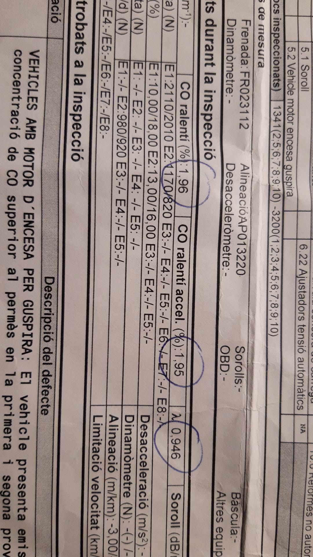

Do you mean the car is still failing MOT on emissions readings? If so do you have a print out of the failure sheet giving values and what gases and what the pass values would be in your testing area in Spain?

¿Quiere decir que el automóvil todavía no pasa la inspección técnica en las lecturas de emisiones? Si es así, ¿tiene una copia impresa de la hoja de fallas que indique los valores, qué gases y cuáles serían los valores de aprobación en su área de prueba en España?
primera inspección técnica
segunda Mot Parece que las sondas han cambiado valores de una inspección a otra. Ellos son iguales.
Aún no he pasado 3 ITV porque falla la luz intermitente... No hay ningún fallo en la máquina.
