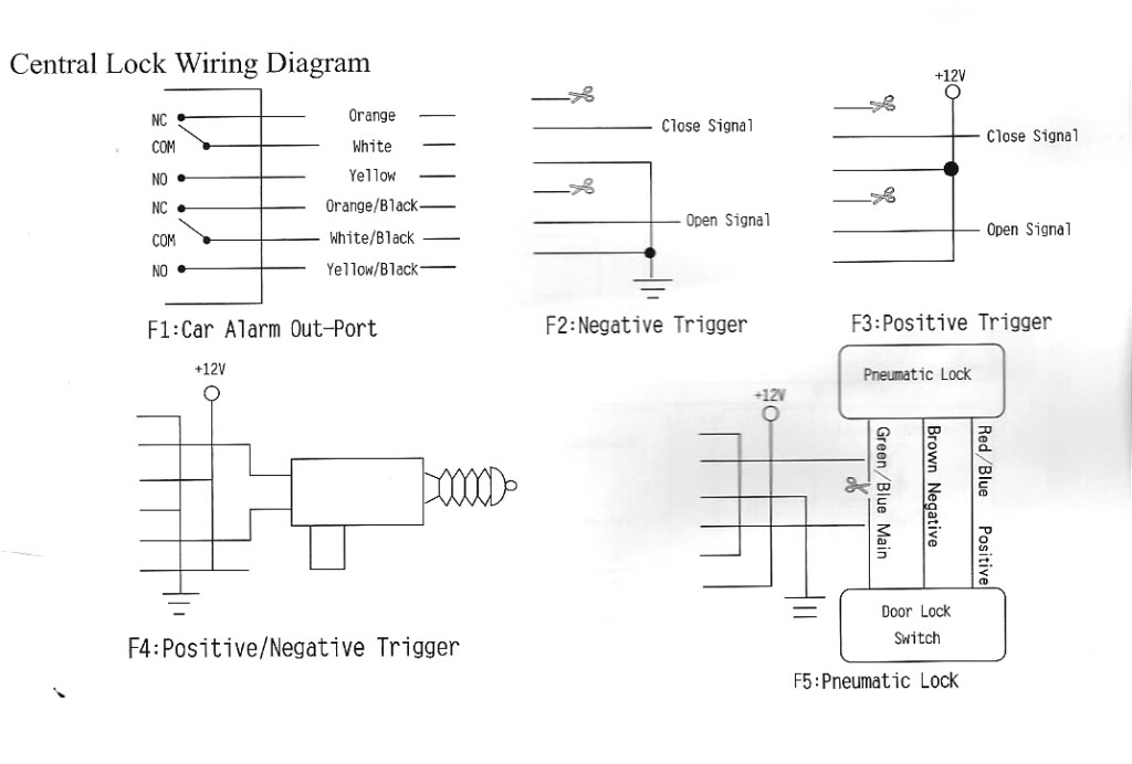

I have a Fiat Sedici 2007 model and I have real trouble wiring my alarm to the central locking. I tried both negative and positive triggering, with negative..nothing happens, with positive, fuses of the alarm outputs are blown.
I tried positive as I found two cables in the driversw footwell (coming from drivers door) that appear to have positive 12volts when arming/disarming with cars remote control/button on drivers door. Wiring is as shown in the attached pisture.
I also wired drivers door to the alarmto be triggered when opened, thinking that all doors would be connected together, but no luck..alarm is triggered only when drivers door is opened and by no other door. Where could I find a wire for all doors?
Any help regarding these 2 issues would be highly appreciated as I will finally install the alarm and have the car ready to go on the road again!
