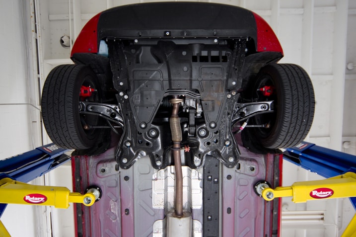

The parts for these cars are relatively cheap, but not all on 100HP as some are unique,
100hp front suspension parts are supposed to be different, and much more expensive
People have been known to use standard parts from a 1.2, as they fit. But that's not how FIAT designed them.
Some "upgrade" suspension parts improve handling, some make it worse. Some make it so uncomfortable to drive that it defeats the point of having a 100hp in the first place.
100hp wheels are prone to minor buckling, usually on the inside. Causes vibration, and sometimes slow punctures, often randomly. Replacement originals are rare and are usually as bad. Not many aftermarket wheels are correct size and offset.
