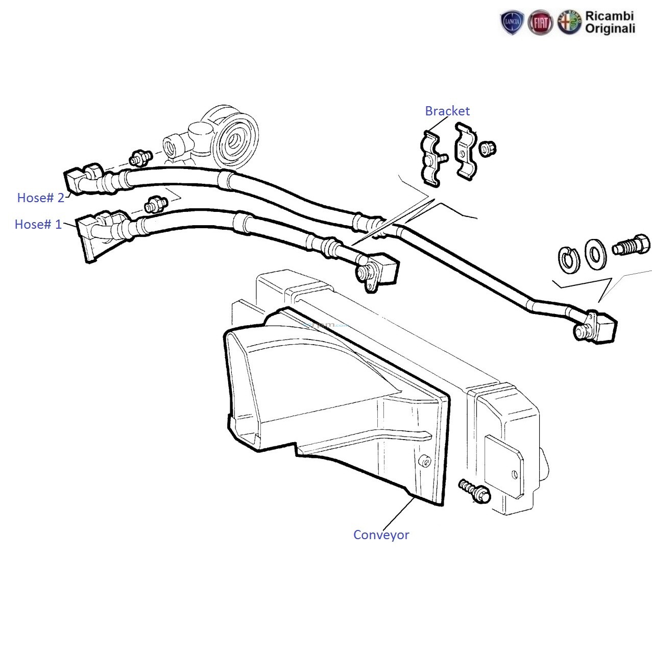

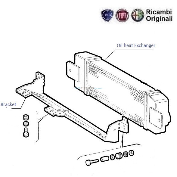

Ps: here are pictures of what the 1.9D’s oil heat exchanger looks like. Although a different model, it looks exactly the same.
