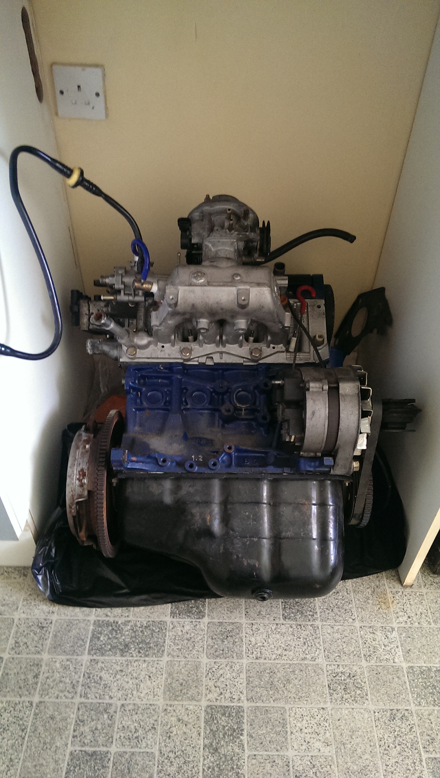

We'll today I've aqcuired another 8v 1.2 engine along with a 6 speed box :D
It will be a few months until this goes in since I have other stuff to pay for but things are looking good...

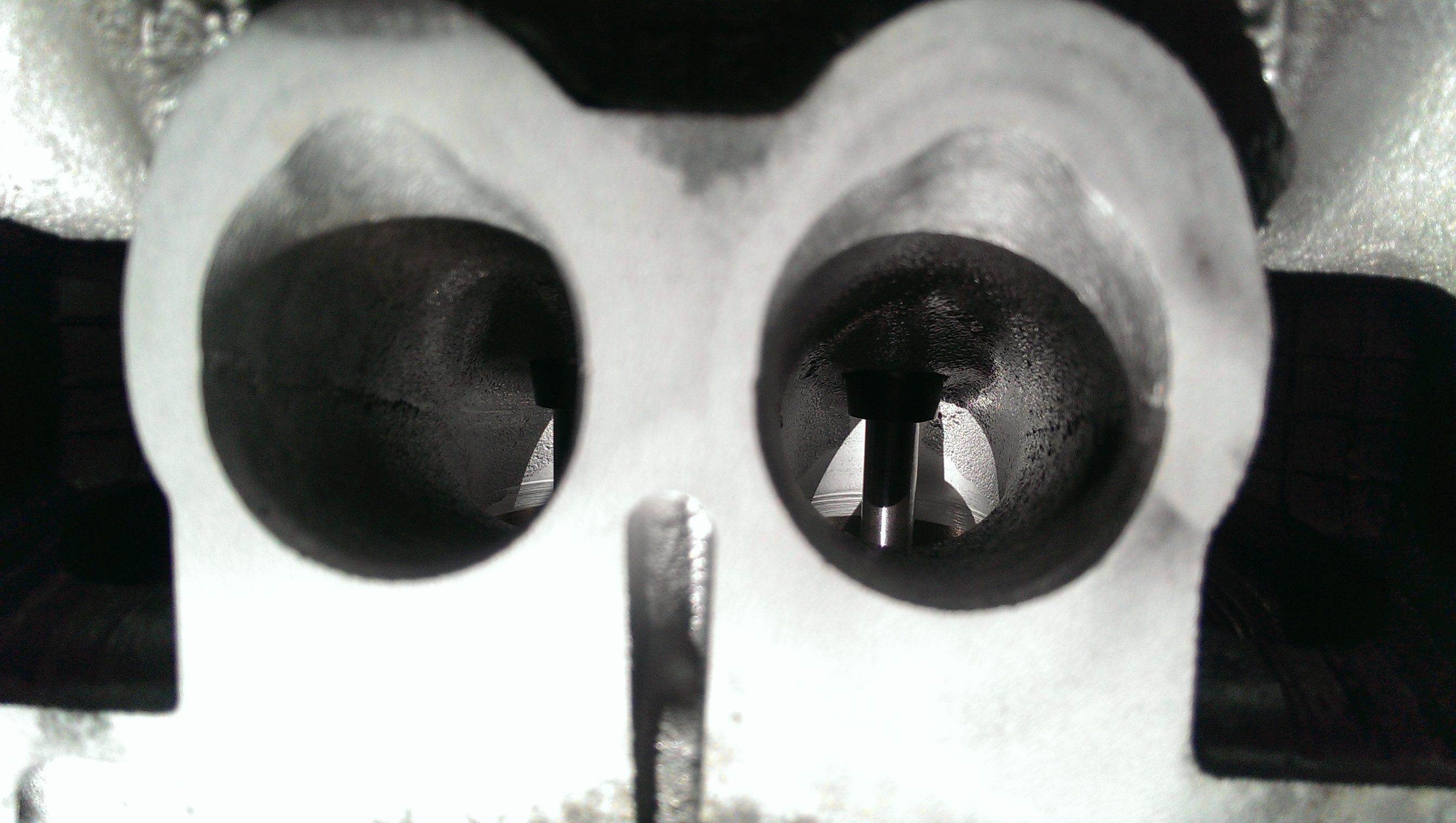

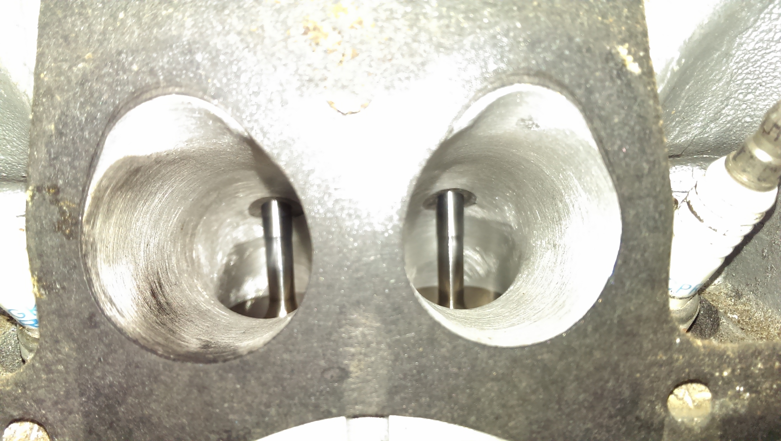

You can see in comparison to my standard P75 head this one has had a little bit of work:

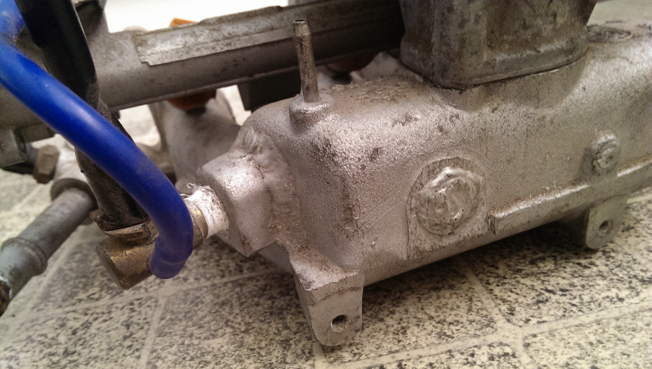

It also has had the P75 inlet that's been modified to fit properly:
Upon taking the inlet off I've noticed that most of it seems to have been rebuilt using stainless nuts and bolts :)
So far all I know for sure is that the flywheel has been lightened and the head has had some work, it also contains a reground camshaft...
It was built by Richard at Wolf Direct Racing

I wish my mum would let me have a spare engine in the house, he says brushing past the tractor radiator and moving the exhaust manifold from under his feet, only to trip over on the exhaust itself.

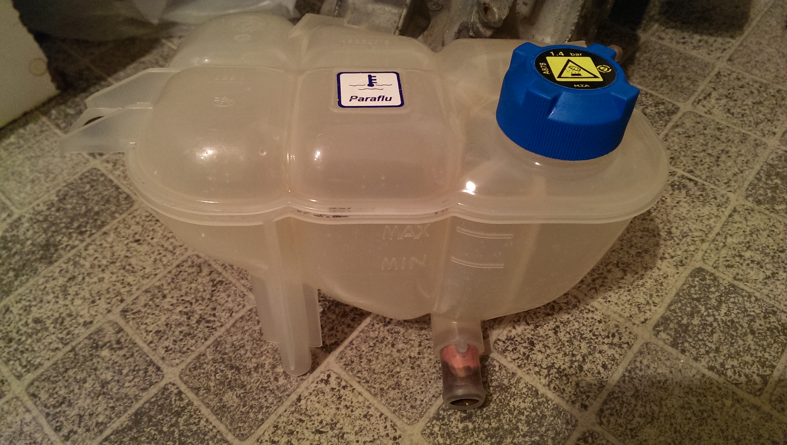

So today I cleaned up my other header tank :)

Someone has shortened the valve guides -- no-one does that anymore: you may gain a little power initially, but you loose it as they wear a lot quicker and the valves don't seal properly.

Thing is with this new engine I have no idea of how long ago it was rebuilt although the block appears to be november 2004. I won't be taking it apart to see what I've got, it will be going straight in once I've got another mpi oil pump on it and all the pulleys etc. I'm told the engine was running at one stage last year but the bloke we bought it from lost all enthusiasm for it.

That head looks exactly the same as the p75 engine I have that which came from a Fiat challenge Punto. I think it was also a wolf racing engine, stainless everything, reground cam etc.

I think Wolf Direct Racing did have a race punto themselves, I think all the P75 heads were done to a similar/identical spec. Lecook has the 8v head from a 600m engine which appears to be the same also. Whether this was another head RB put on it temporarily as it was being rebuilt or the actual head used I don't know. I have an 866 cam in it which looks to be a regrind, no idea on what spec though.
