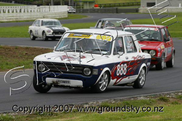

128 My Fiat 128 Sedan Circuit Car
Some photos of my 1978 Fiat 128 4 door Sedan Race Car.
Mods Include:
X1/9 1500 SOHC, bored to 88mm with Iapel forged pistons (1560cc)
Tipo 1600 8 valve head flowed to 170HP + (40mm inlet valves modified chambers)
Redline inlet manifold with 42DCOE weber sidedrafts
12.8:1 Compression ratio, PBS double valve springs
Lotus PH3 hybrid camgrind (0.430" lift, 290 duration)
Balanced and cracktested bottom end
PBS baffle plate
PBS oil pressure relief valve
Custom thermostat controlled oil cooler
Lynchbuilt 4 into 2 into 1 equal length mandrel bent extractors
X19 5 speed gearset
128 gearbox housings
Uno Turbo selector mechanism
Phil Buggee Limited Slip Differential
Dunlop D02V race rubber
Coilover suspension (front)
5 leaf reset main leaf (rear)
2" Lynchbuilt Mandrel bent exhaust
Mazda Familia Dohc Turbo calipers and rotors
Full rollcage with lots of extra bracing
too many mods to list.

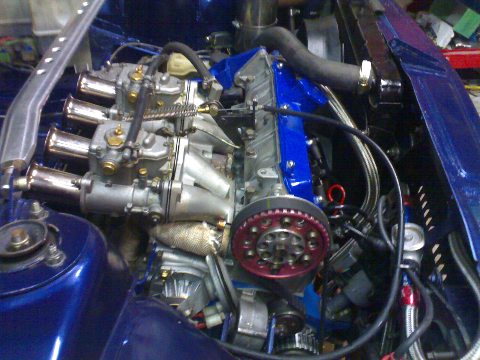

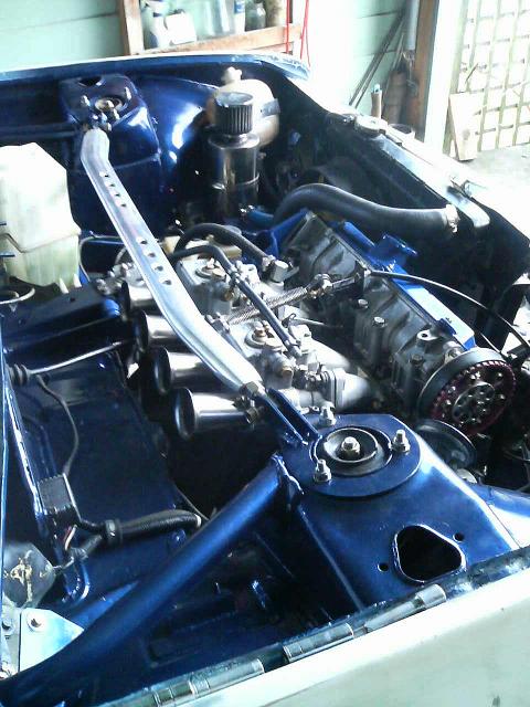

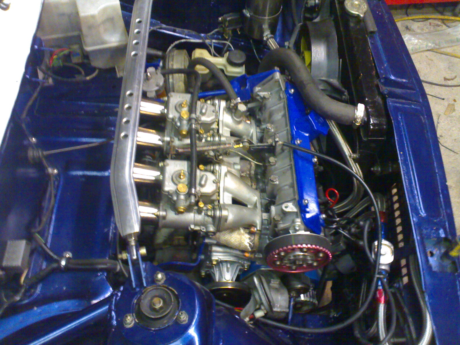

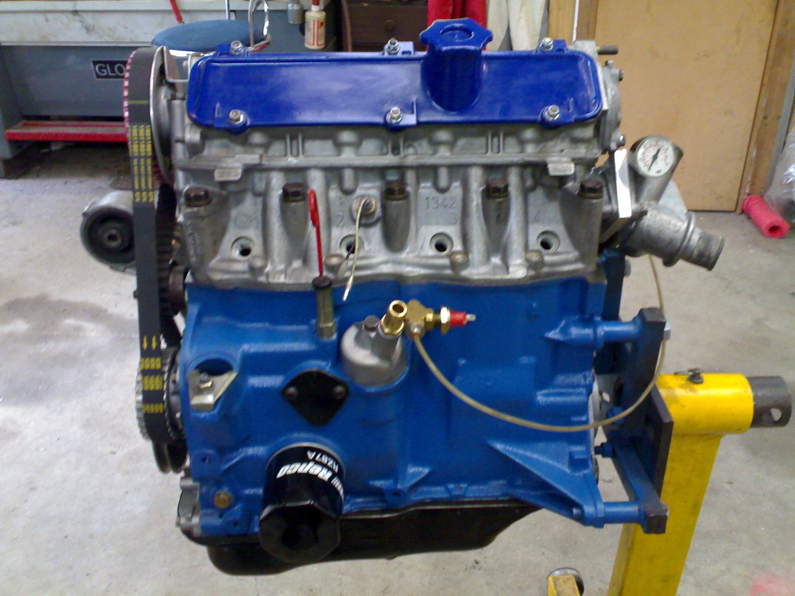

Luckily i have a few spare blocks, and my new engine is already underway - sourced a new forged piston, new valves, had my cylinder head welded and reshaped, and well into it.
I use the 1500 block because it is alot stronger around the crank tunnel, and the 1600's have a tendency to throw conrods when revved hard.
OK for street use, not really desirable for racing.
After 4 months, i have the engine rebuilt, and back in the car, ready for action next weekend.
Dyno figures pumped out 160 flywheel horsepower, and 155Nm of torque from 3500rpm through to redline on a flat torque curve.
I managed to tweak a bit more compression on this one (just on 12.3:1 with 0.060" exhaust valve clearance, and 0.074" intake valve clearance, and 0.038" piston to head clearance).
Heres some pics of motor, and car :)
Now to see what it goes like ! if i get similar figures on the track ill be stoked.
The rebuild ended up being ..
1 new forged piston
1 set of new rings
1 (steel) conrod
1 block
full gaskets
rev limiter
1 set stainless oversized valves
new PBS valve springs

Shes all sorted now ;) new motor is in and running - 160hp at front treads, 155Nm of torque from 3500RPM through to 8000RPM, peak power at 6800RPM.
It feels good, and drives strong !
