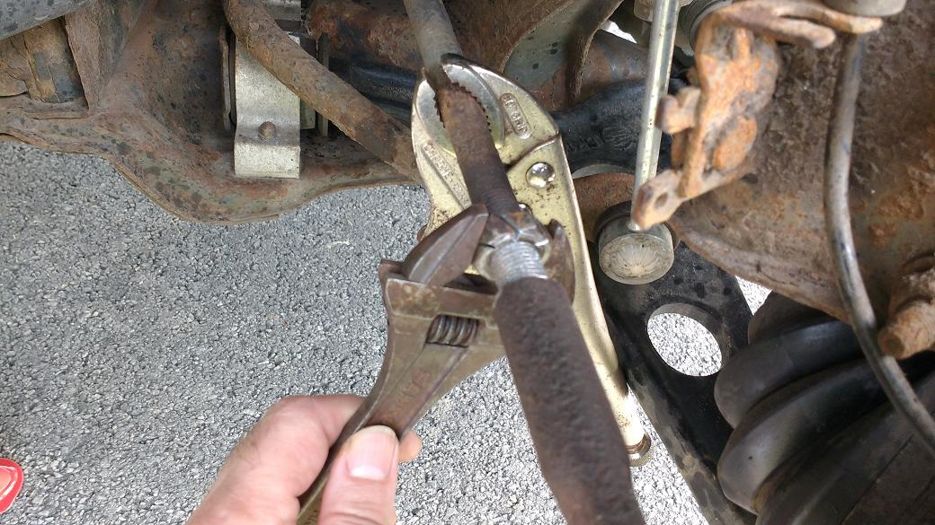

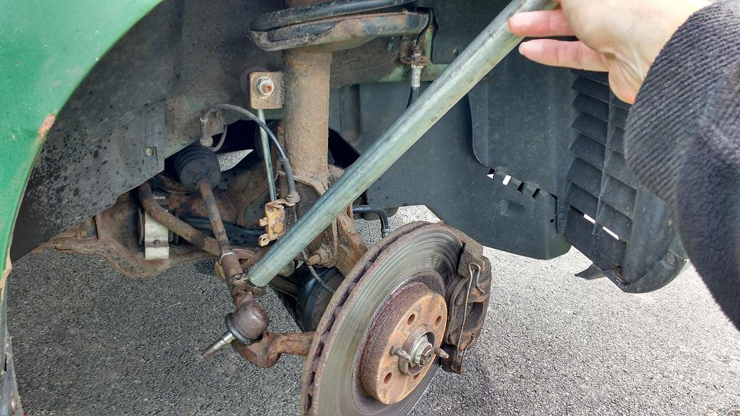

Track rod end loosen and removal: I used a junior hacksaw to saw all round/through the joint between the TRE and the TRE locknut. Not all the way through, just down a mm or so. Then liberally sprayed WD40 into the joint. I then used 2 adjustable wrenches to undo the TRE, a big one on the locknut with it's handle wedged under the driveshaft, and a smaller one (because the handle fits into the breaker pipe/bar) on the TRE flats with the handle in the end of my breaker bar/pipe (See photos). I rotated the breaker bar anticlockwise to crack the joint between the TRE and locknut.
Note: threads on the tie rod/track rod, TRE and locknut are normal RHT (Right Hand Thread) ie. "Righty Tighty Lefty Loosey" (I've just heard this expression today believe it or not), or turn right to tighten, turn left to loosen. Same on *both* sides of the car. O/S and N/S TRE's are *identical* ie. not handed.
Tip I got from a YT video: When unscrewing the old TRE from the track rod, count the number of complete turns it takes to completely unscrew the TRE from the track rod. Then when installing the new TRE on the track rod, screw on the TRE using the same number of turns to get the tracking roughly correct. Tracking by a professional will still be required later. FYI: Both my TRE's required 18 complete turns to undo.

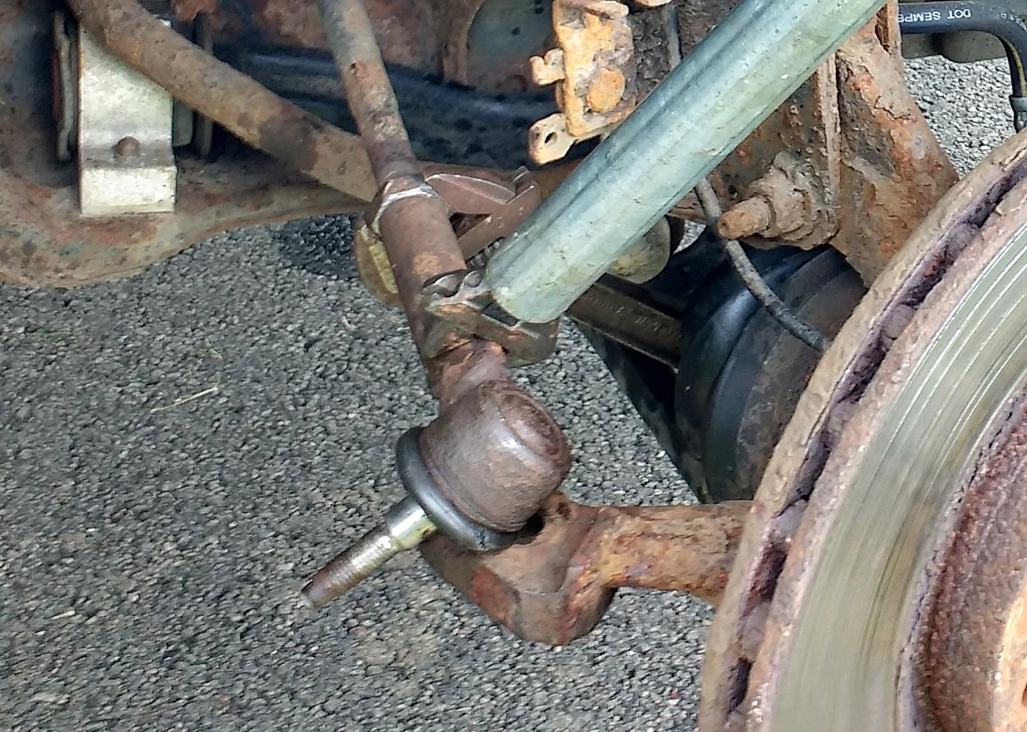

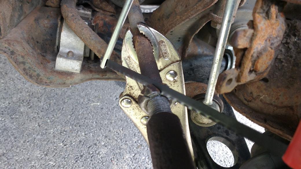

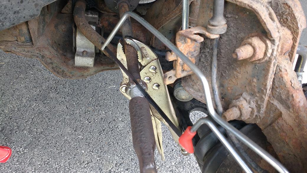

TRE locknut loosen and removal: No amount of banging and cajoling would loosen the locknut, so I carefully sawed through 3 adjacent locknut flats almost to the track rod threads. To assist with the sawing I screwed the old TRE back onto the track rod and put the ball joint pin back into the steering arm to steady the track rod and locknut while I sawed. Sawing completed, to loosen the locknut I grabbed the track rod on it's flats/hexagonal section with large mole grips, handle wedged against the suspension arm to stop the track rod turning, as I applied anticlockwise torque to the locknut with an adjustable wrench to loosen it (See photo). Sorted. No need for blow torches etc.

- 1 Removal of track rod end using 2 adjustable wrenches and a breaker bar/pipe
- 2 Ditto (close-up)
- 3 Removal of locknut (sawing through nut with junior hacksaw)
- 4 Ditto (close-up)
- 5 Loosening locknut using adjustable wrench and molegrips

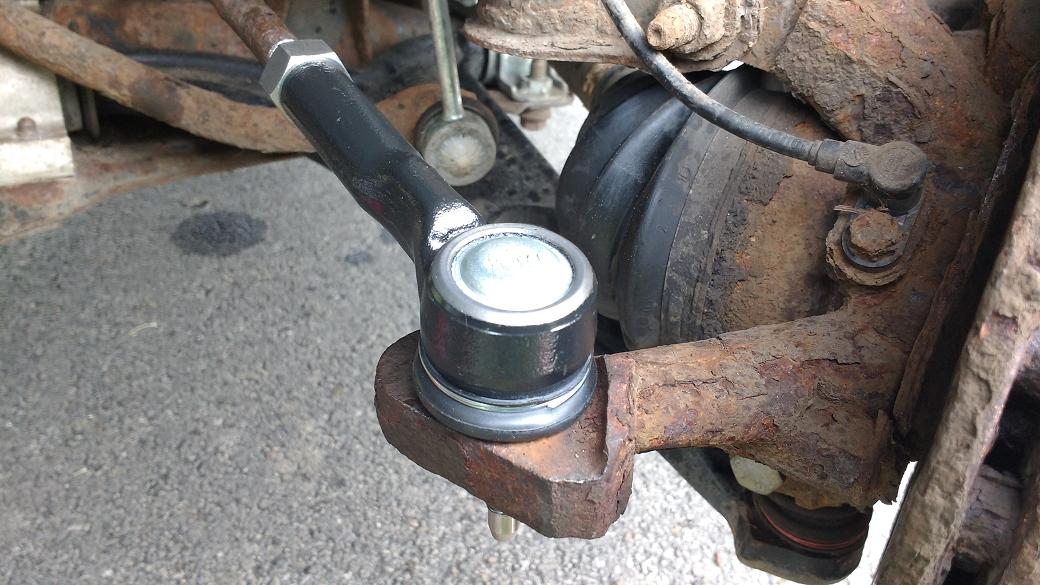

- 6 New TRE installed (with new locknut).
