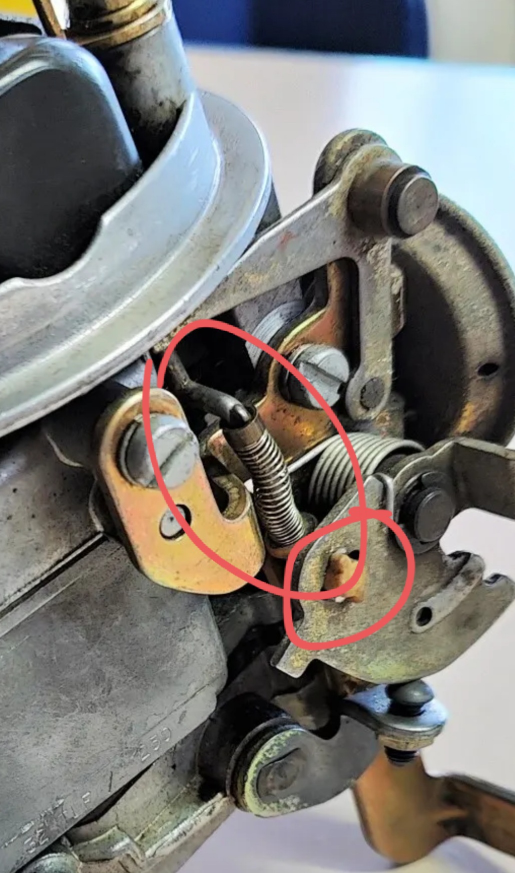

I checked again and saw this choke rod spring too loose, and also my the plastic that holds the rod is broken.
Don't know where to get these 2 because it doesn't exist on any Weber 32tlf build kits.
Glad your compressions are all good, it means that what ever is the cause is got to be a lot cheaper to fix:).
It may not be your problem but a small bit of locking wire should hold the plastic clip in place until you can get a part.
When engine is cold and air cleaner is off, actuate the choke lever /knob all the way out (if manual operation) press the accelerator down once to allow choke flap to fully activate and then gently press the choke flap at top of carb, you should feel a spring loaded resistance that you can overcome but that isn't floppy.
This is so when engine starts and needs more air the choke flap will move against the spring pressure and allow more air in.
The reason for pressing the accelerator initially is to allow the choke flap to close as far as it is meant to and allow the "fast idle" position so the engine doesn't stall due to the restriction of air flow by the choke flap.
You can see what I mean if you activate the mechanism manually with air cleaner off and engine switched off too.
Not your problem in this case but only press the accelerator pedal down once, some people press repeatedly causing the accelerator pump jet to flood the engine.
Before most cars went to fuel injection as an apprentice in the late 1960s and early 70s we were always having to reset auto and manual chokes. mechanisms.
