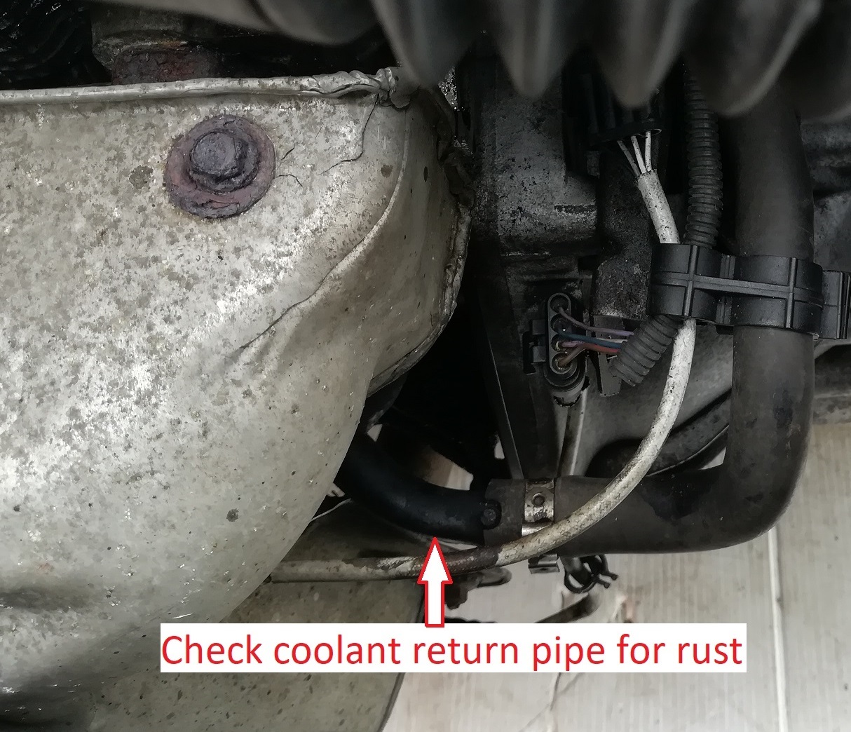

- coolant return pipe across front of engine

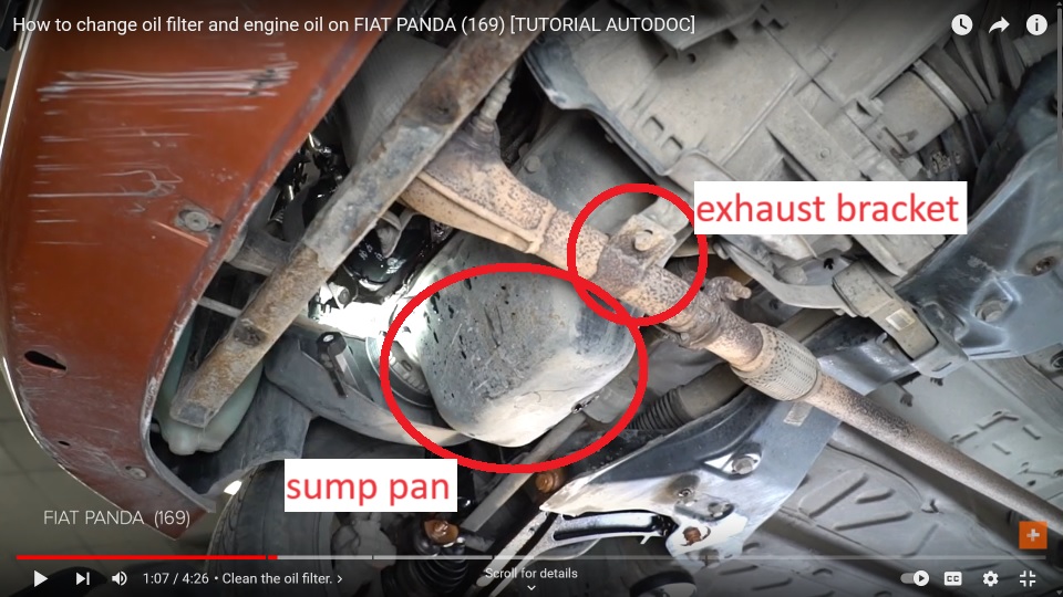

- engine sump pan

- exhaust bracket below cat
