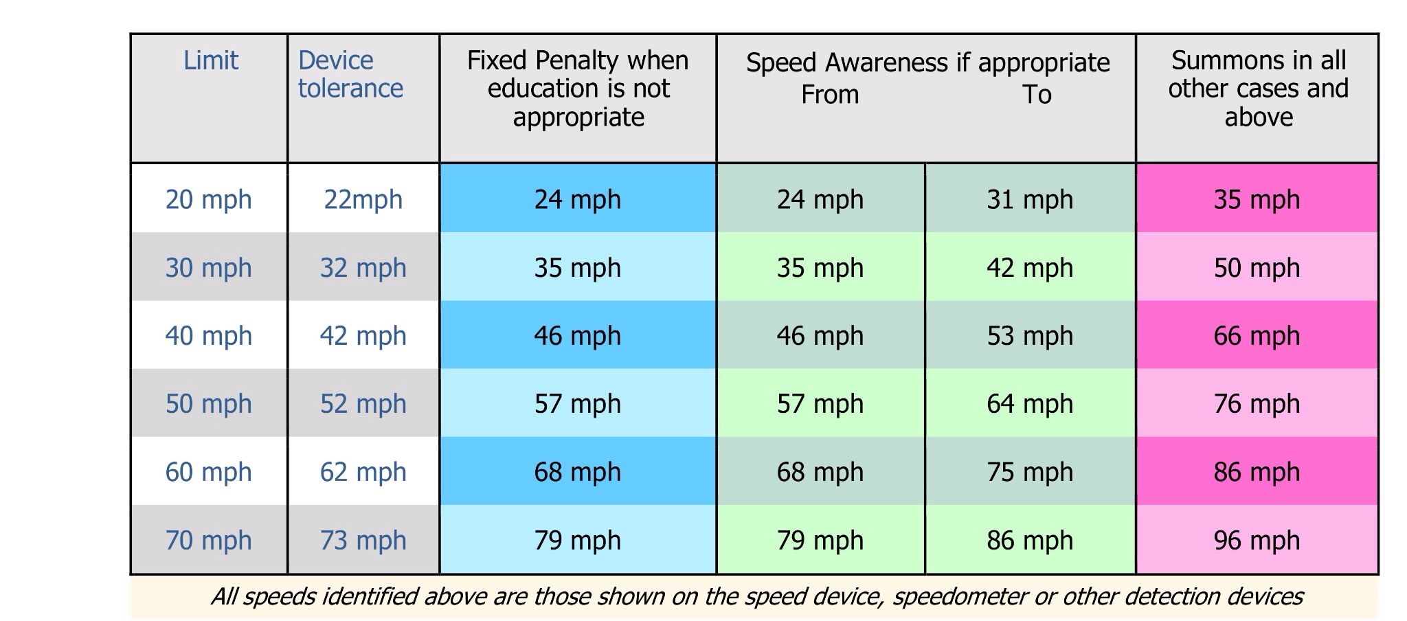

On the assumption that motorway speed enforcement occurs at 10%+ 2mph = 79mph, what do you guys think is the highest speed one could set cruise control to without being stopped/ fined? 83mph?

So that's about 5%, I have read circa 6%-8% elsewhere for other speeds.
%age calculations for speeding fines were binned years ago even in patrol cars.
Yep, the 10% thing is an urban myth. 71mph can be a fine/speed awareness course.
I have no idea if this is still current but it certainly WAS the official Police guidelines
Yeah, I think 79 is about right. I've said before ive used a few bmw's over the last few xmas' in which I travel about 1,000 miles mainly on the motorway. Have set the cruise to 8% over and have never had any issues.
That said if I'm on the M40 after the traffic clears around Thame (J5) on the way to Birmingham there's a lot going far quicker than me.
The 10% + 2 was in the ACPO Speed Enforcement Policy Guidelines 2011-2015. The criteria was also qualified with respect to matters such as dangerous driving, road conditions, traffic etc.
Technically doing 70.0000001mph in a 70 limit is breaking the law for which you can be fined/prosecuted, however clearly there is some common sense that needs to be applied. The guidelines were designed to address this and produce some form of national uniform approach. Police officers have the ability to make a judgment call hence some people getting warnings for some offences, like 1st time cannabis, bad language/swearing at an officer, stopping on double yellow lines etc.
The full legal details of the April 2017 speeding penalties can be found here:https://www.sentencingcouncil.org.uk/offences/item/speeding-revised-2017/
With the new April 2017 changes to speeding penalties I've not seen or heard of any changes in ACPO Guidelines. Also there have been no mass stories in the papers of people complaining for being done at 1mph over a speed limit although they could fined for doing so.
This article http://www.express.co.uk/life-style/cars/806313/Speeding-fines-2017-UK-10-percent-allowance-rule-explainedsuggests the 10% +2 is still the "Rule of Thumb" being adopted by National Police Chiefs' Council (NPCC). Suggest reading the whole article as it talks about "discretion" and practical issues.
To further confuse/confirm/deny anything the Government Crown Prosecution Service website has this current (not redacted) information/guidance: http://www.cps.gov.uk/legal/p_to_r/road_traffic_offences_guidance_on_fixed_penalty_notices/#speed
There is no myth in the "guidance" and there is no "myth" that you can not be prosecuted for doing 1mph (or less) over a speed limit. What is true is that you will playing the lottery for exceeding any speed limit :)
