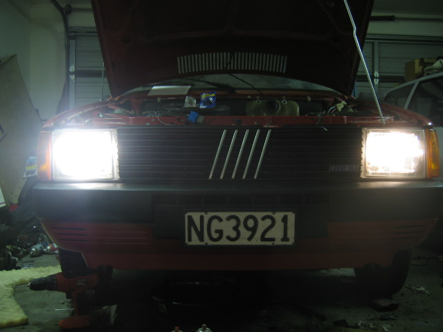

The last time I fitted relays to headlights was years ago and I can't find the photos - except one (below) that shows the result - one of these headlights has the relay fitted, and the other uses the standard wiring.
I shall turn this thread into a guide - with pictures - when I next carry out this modification. In the meantime...

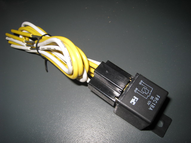

What is a relay?
A relay is an electrically-operated switch (the Italian term, Teleruttori, is a little more emotive, rather than the English that means a torch-passing race). There is a coil of wire inside the relay that forms an electromagnet. The switch contacts move (they are influenced by the magnetic field) when a current flows through the relay coil.
There are usually at least four terminals on a relay:
- two terminals (numbered 85 and 86) provide the power to the relay coil
- one terminal (30) has power connected to it. This is the moving contact.
- one terminal (87) is the other (stationary) contact. This becomes live when the relay turns 'on'.
- sometimes, there is another terminal, often numbered 87a. This may either become live at the same time as terminal 87, OR it may be live when the relay is off and become 'dead' when the relay turns on. This latter possibility is known as a 'changeover' or 'cutout' relay, useful for reversing the direction of a motor (e.g. electric windows https://www.fiatforum.com/uno-technical/81347-electric-windows.html?p=899346) or turning something off when something else goes on.)
The picture below shows a standard relay. Usually these are black but they can also be grey, green, red, blue, white, etc. The colour doesn't reliably indicate the type or function.
Sometimes, the relay is a taller or wider shape and has extra electronics inside to turn the relay on when there is a special signal on extra terminals, or after a certain length of time. Examples include fuel pump relays, central locking control relays, interior light delay relays, and others. You could say that the additional electronics make each of these 'relays' actually a 'relay plus control circuit', but people still think of them as relays (and get confused). Just think of them as 'control units' instead :) The rest of this article talks about only the standard relay.

A typical relay, with mounting tag and socket base, is shown below.

For the photo there were 60/55W halogen both sides, but the dim side had some serious wiring/fusebox problems that dropped the voltage to 9.5V at the bulb. I could have probably improved it by cleaning connections but decided to fit relays instead. The bright side had a relay fitted and thus 12.3V (14V with the engine running). I had to play with the camera exposure a little (i.e. turn the exposure down) so that the camera could sense the difference in brightness. In real life, it was obvious, but to a camera, everything tends to look 'bright'.
I remember driving that car at night once both lights were done and (sorry Jai) the difference was night and day. The grass was green (on the other side of the fence) and you could see every stone in the road. It was incredible - roadsigns were visible over a kilometre away and blindingly-bright at close range. The irony was that the lights far outstripped the 58bhp-performance :eek:
A few years back, I was approaching a roundabout at night - and seeing a car coming, I thought "man, those lights are as dim as standard Uno lights" - by the time I'd finished thinking that, it drove past, and it WAS an Uno - which was kinda funny. I reckon they must be some of the dimmest lights on the road - doesn't help that many of them still have those silly "big round bulb" things!
The funny thing is, the situation all changes when you put a decent light source in - because the reflector area is LARGE, the Mk1 lights give great illumination. My 166 with its low-set projector lamps was dismal - they cast shadows in the road!
I hope to be doing this again next week, all being well, with the Uno 45 that's in the garage at the moment. Logically I should do it to my Turbo, since that goes faster :rolleyes:
