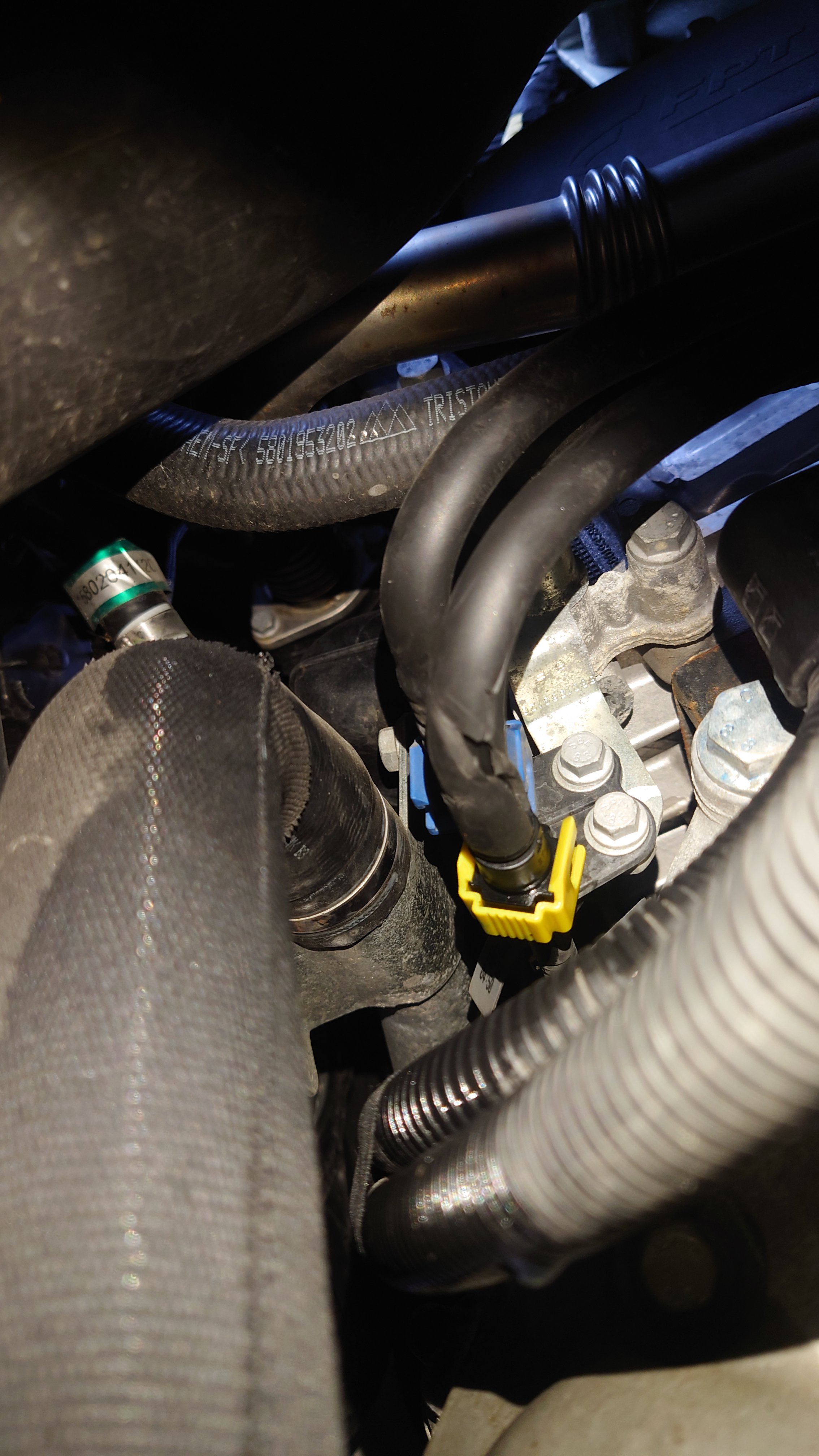

My immediate thoughts having read many other posts is to look for wiring harness abrasion and cut wires.
Open the bonnet. As you are standing looking, on your right ( vehicle left) fixed to the bulkhead is the diesel filter.
Look at it's lower bottom and find the wiring harness, it's known to catch here, not sure if it's brackets or a bolt. I've read of vibration damage here.
The other typical general fails is water getting in the the fuse box area in this same zone.
