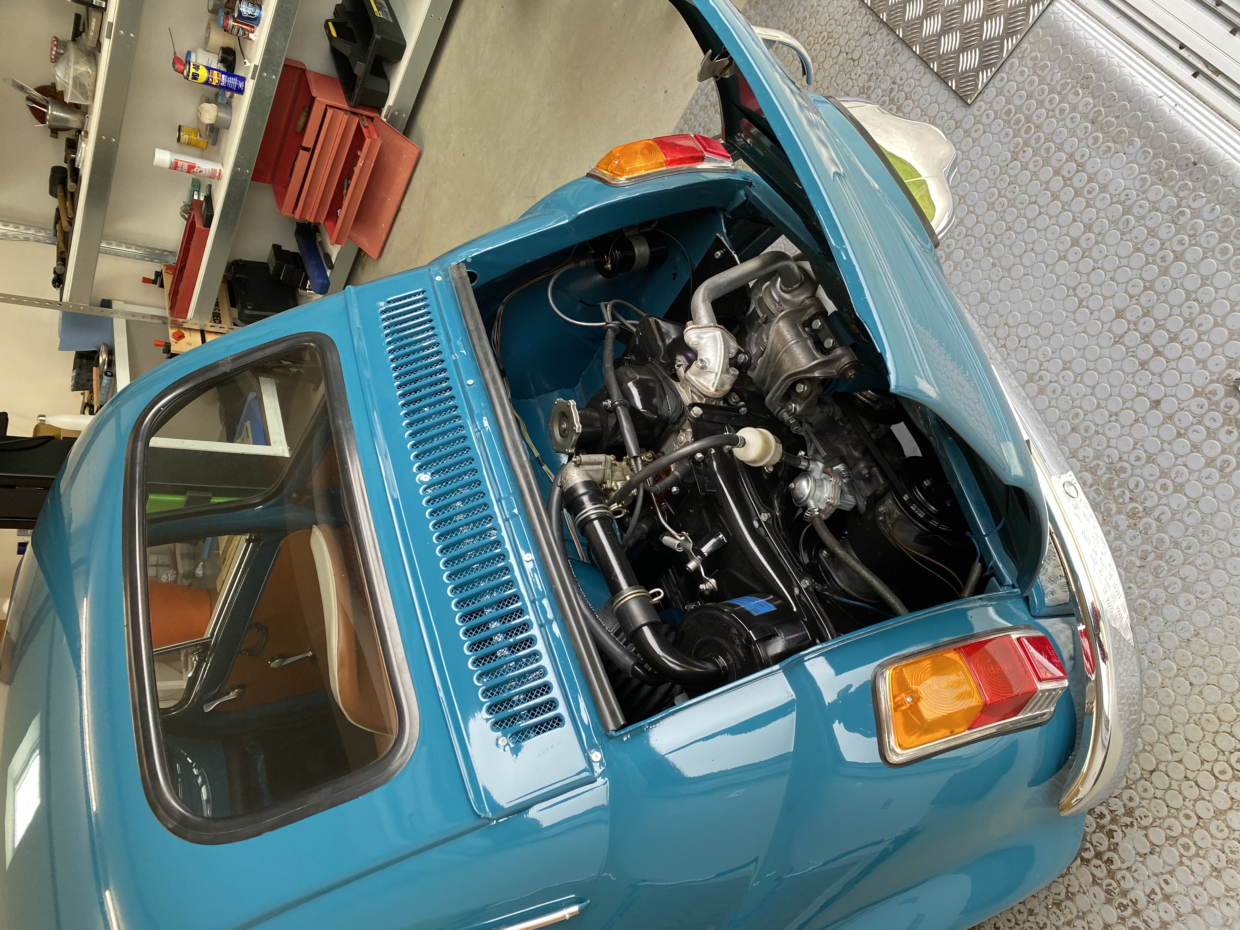

Hi everyone,
New member here with a 1970 500F, I have only just purchased the car and after a short drive (10 mins) the oil light comes on. I have replaced the oil pressure switch and an oil change with Duckhams mineral 10W40, and after the same 10 minute drive the light comes on again. It begins to flicker, and goes off with hard acceleration but eventually after around 15 mins of driving it is on and stays on. Any suggestions to fix this? The engine does not seem hot and no nasty smells. It’s just been restored and is in very good condition. Thanks in advance.

Unfortunately nicely painted parts do not necessarily mean that the engine internals are in such good shape. Car looks very nice but what you describe are classic signs of the bottom end (ie crankshaft & bearings) showing signs of wear with the loss of oil pressure when warmed up. I had exactly the same problem when I bought a car which the seller assured me was perfect. Unfortunately he had gone to great lengths to hide the problem by fitting the wrong switch and actuall destroying the warning light bulb in the dash. Guy was a magistrate by the way !
If that is the case I am sure that you will be gutted but don't panic yet. With those symptoms it is not a complete breakdown but early signs of advanced wear and on an engine that has not had a catastrophic breakdown whilst there will be some wear on the main bearings it is normally the big ends that start to go first. With my engine I removed a big end bearing by just draining and dropping the sump which can be done in situ, check the size from the big end shells and fit a new set. I got shells from a local motor factor for just over £20. That restored the oil pressure on mine. A full bottom end rebuild means an engine out total rebuild and is expensive.

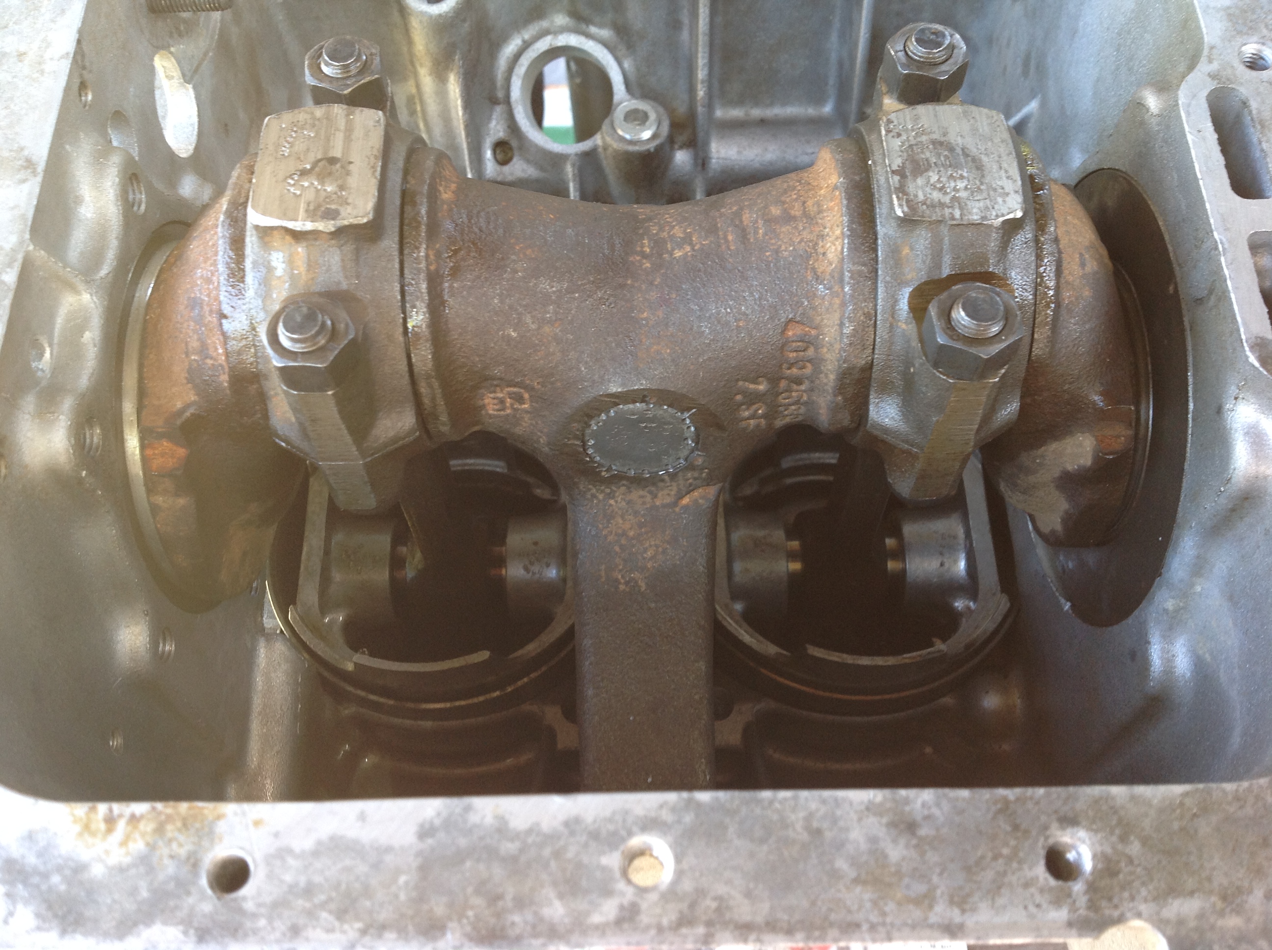

Thank you, I'll be sure to replace the fuel filter! Do you have any pictures when the sump is removed to show me what kind of wear I should be looking for?

Will it be you working on the engine ? It is always useful to know a little about a persons technical abilities & knowledge when offering advice. As for wear you are talking about a couple of thou with the symptoms you describe so most likely nothing is going to stand out. With bad wear you can get roughening of the bearing surface on the shells and scoring & ovality of the crankshaft journals. Fiat 500 Haynes manual is a must have, pretty comprehensive and easy to follow. Also worth getting an original owners handbook if you can pick one up. They actually tell you about your car, driving it and how to get the best. Often owners get these cars and never work out how to use the heater or realise that they have a hand throttle.

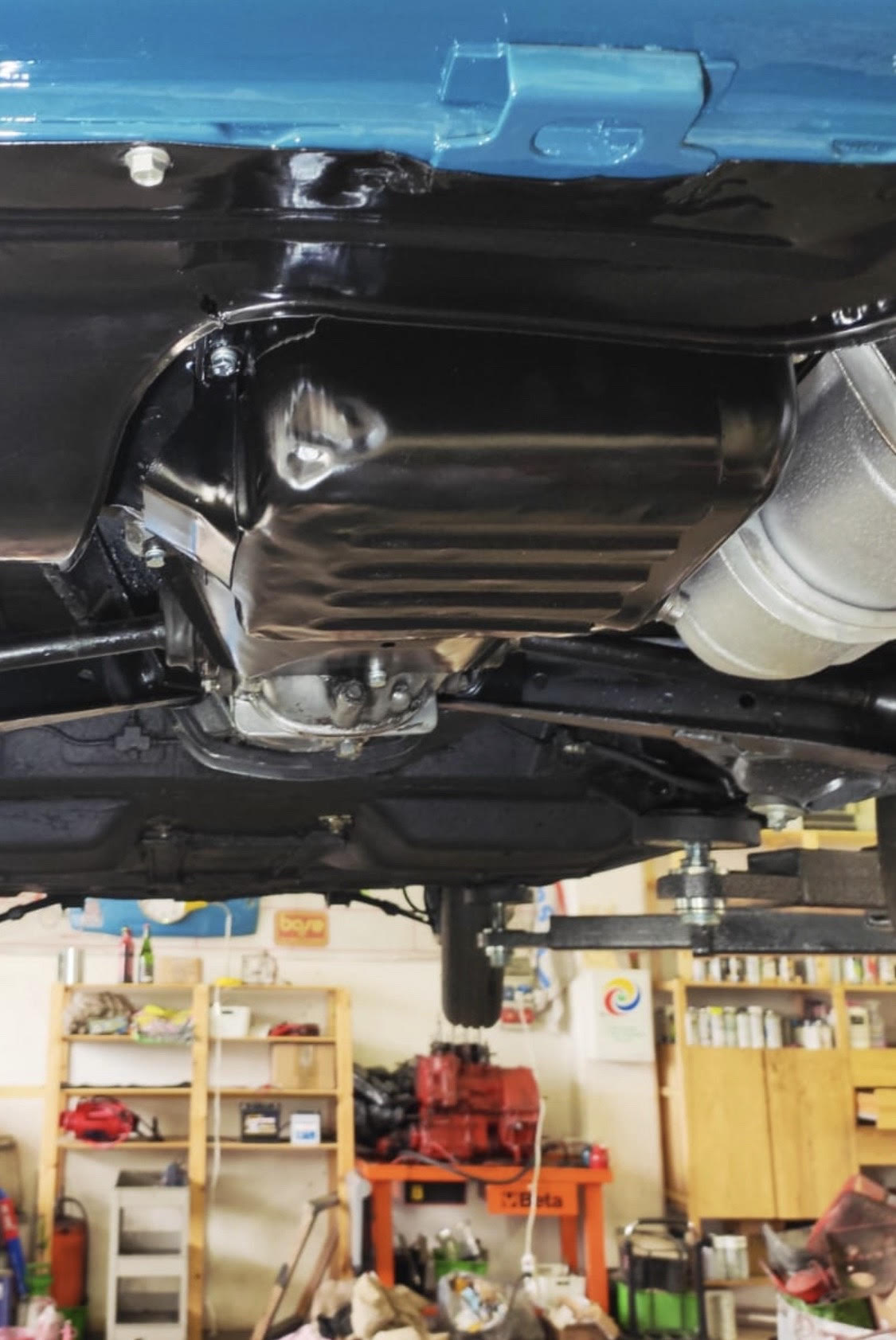

I bought the car with the sump looking like this (dent), would this be a cause of pressure issues?

Extremely unlikely as the corners of the sump are not near the oil pick up. It is a rare thing these days to find a used sump that has not been dented to some degree.
