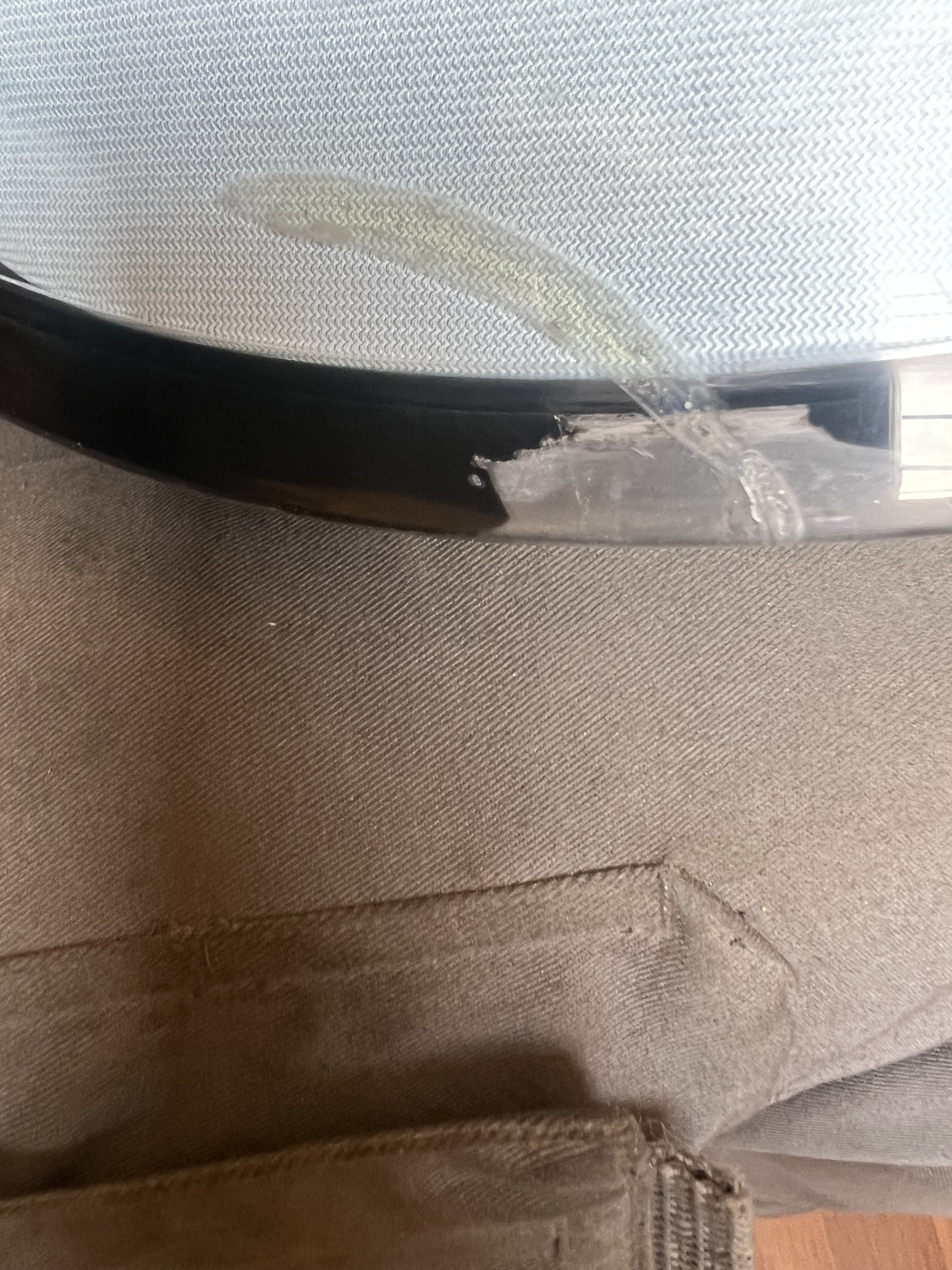

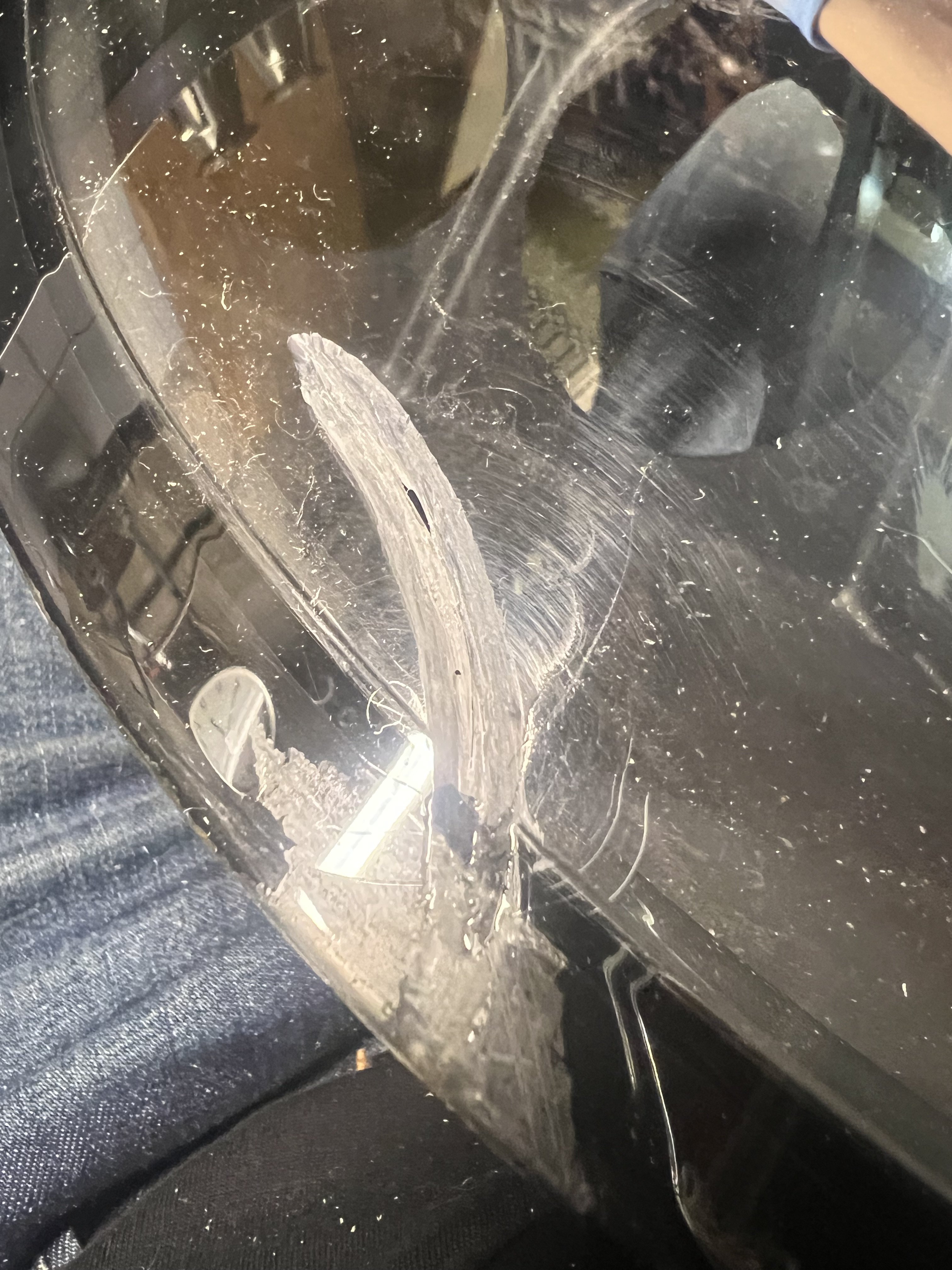

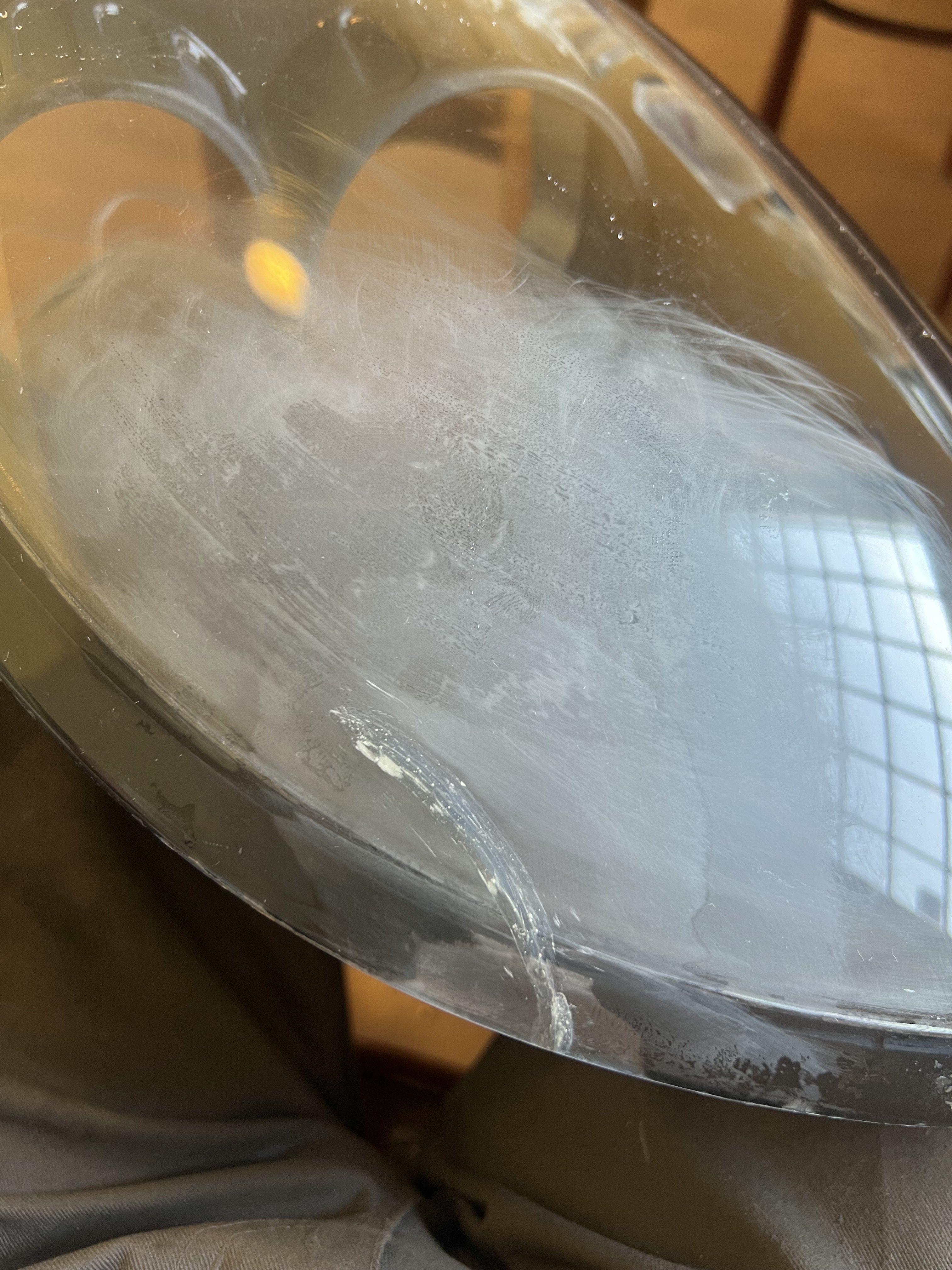

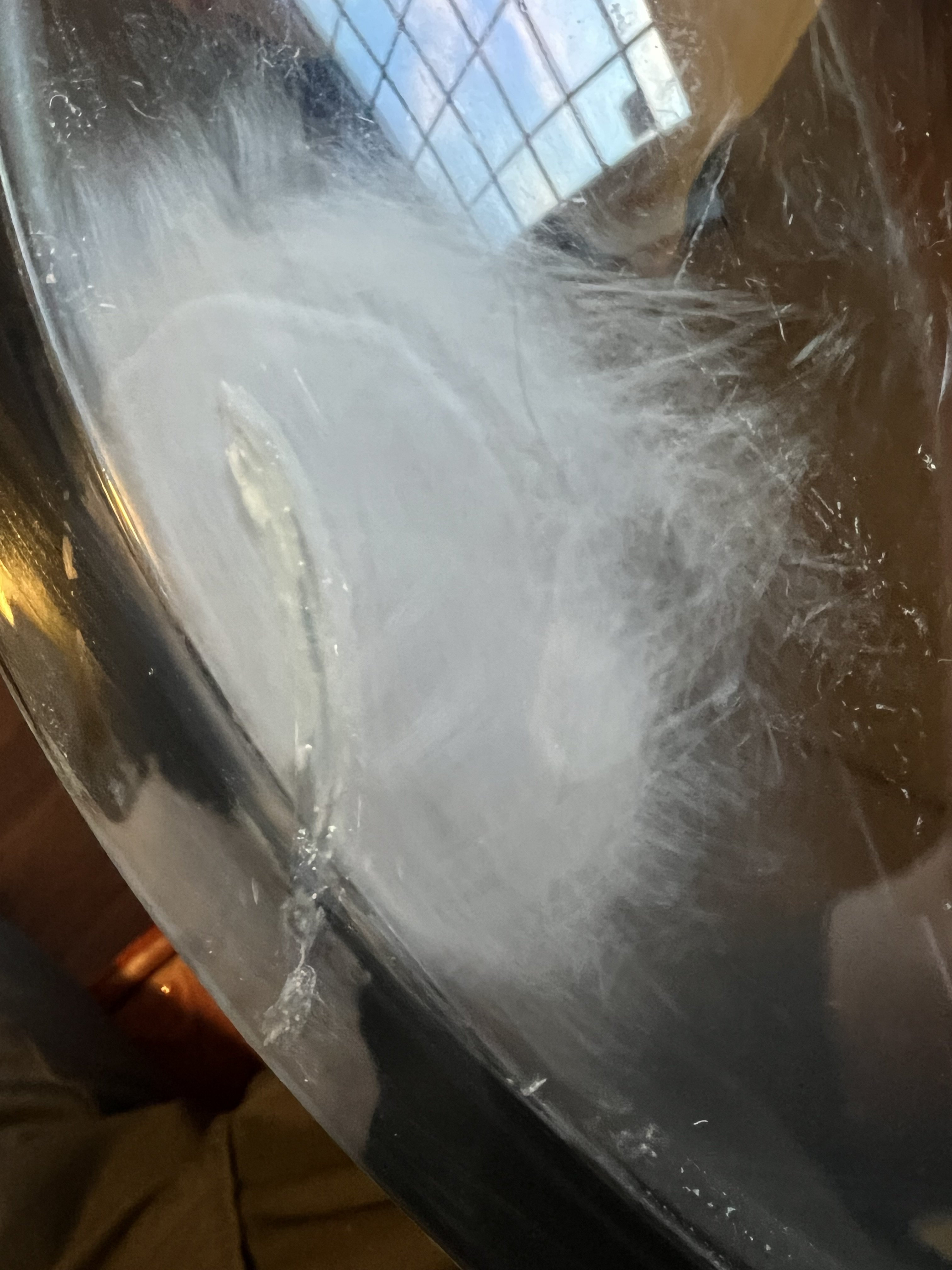

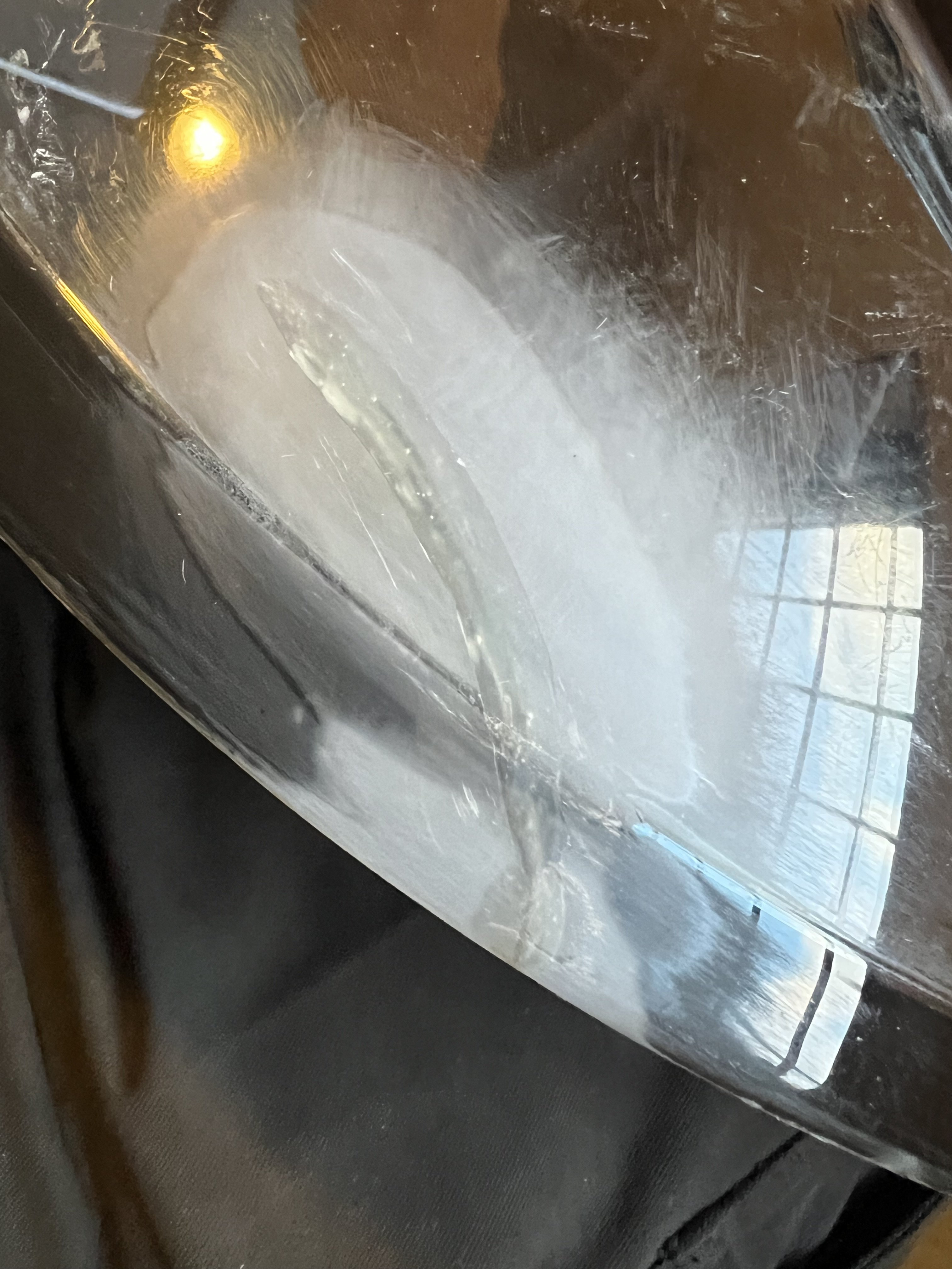

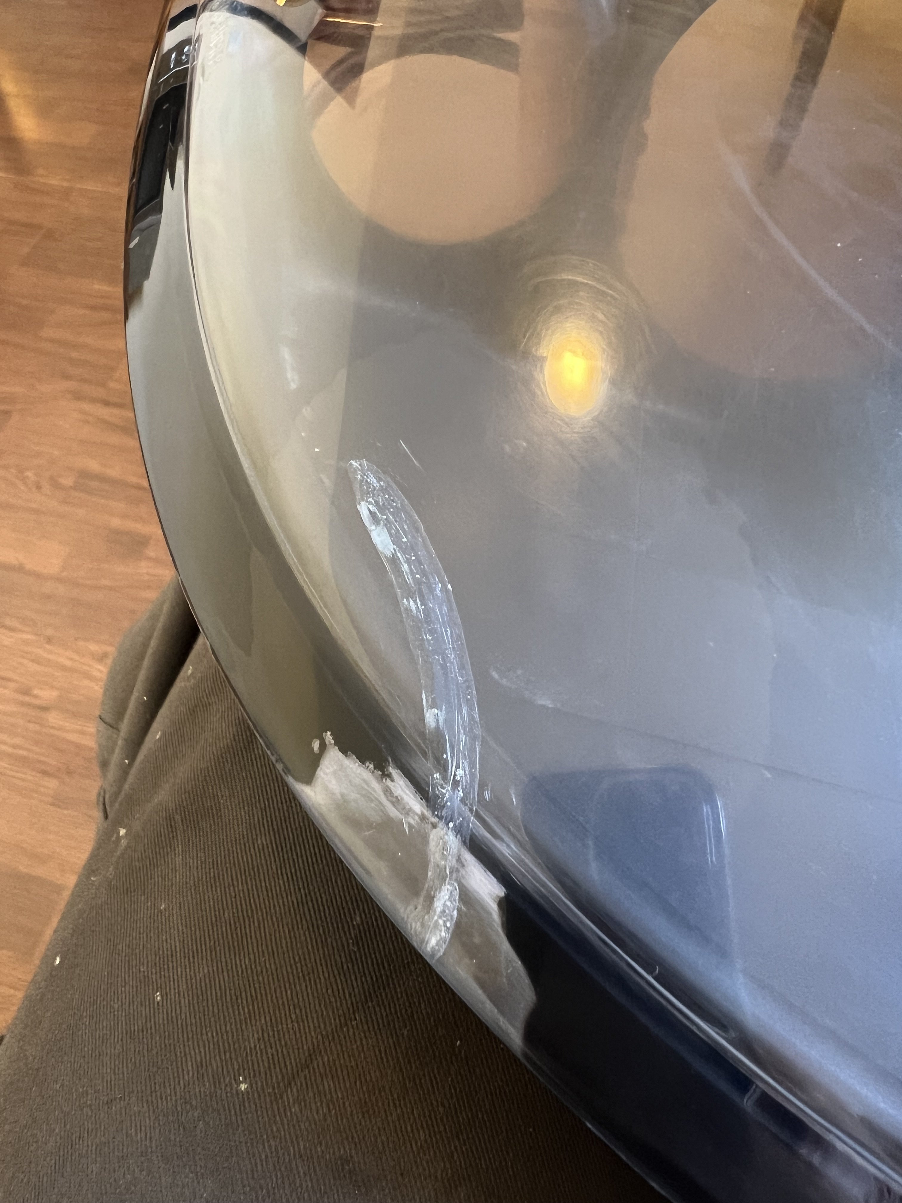

Sorry to say; I was right, and here’s adding to what not to do:
A few hours of grinding, glueing, polishing, waxing, and it looks… worse. 🤦‍♂️
The UV-glue is excellent to work with, but in larger amounts turns a bit rubbery (after hardening) and has a slight yellow tint. See pictures.
If I had to do it again, I would 1) get a real windshield repair kit that, with the help of vacuum and pressure, can draw UV-glue (for plastic) into a hairline crack or 2) dremel/grind out more of a Y instead of a true V (even less fun to grind on the inside also) plus put more effort into cleaning the surfaces before adding glue and working out air bubbles before having it harden.
Hairline crack (don’t ask)
Dremel
Glue
Wet Grinding 400
Wet Grinding 800
Grinding 1200
Grinding 2000
Polish and wax
White background showing yellow tint
Sad “final” result and reason to return
