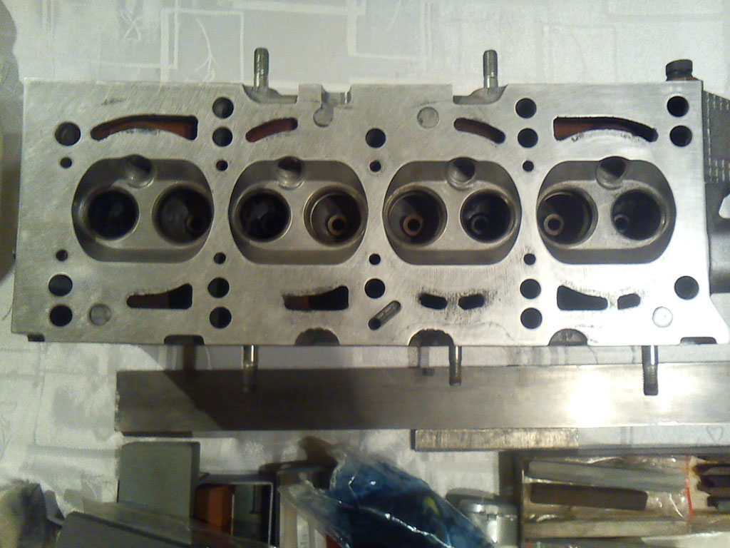

32. Resurfacing progress, almost done (about 0,02 mm out of flat).

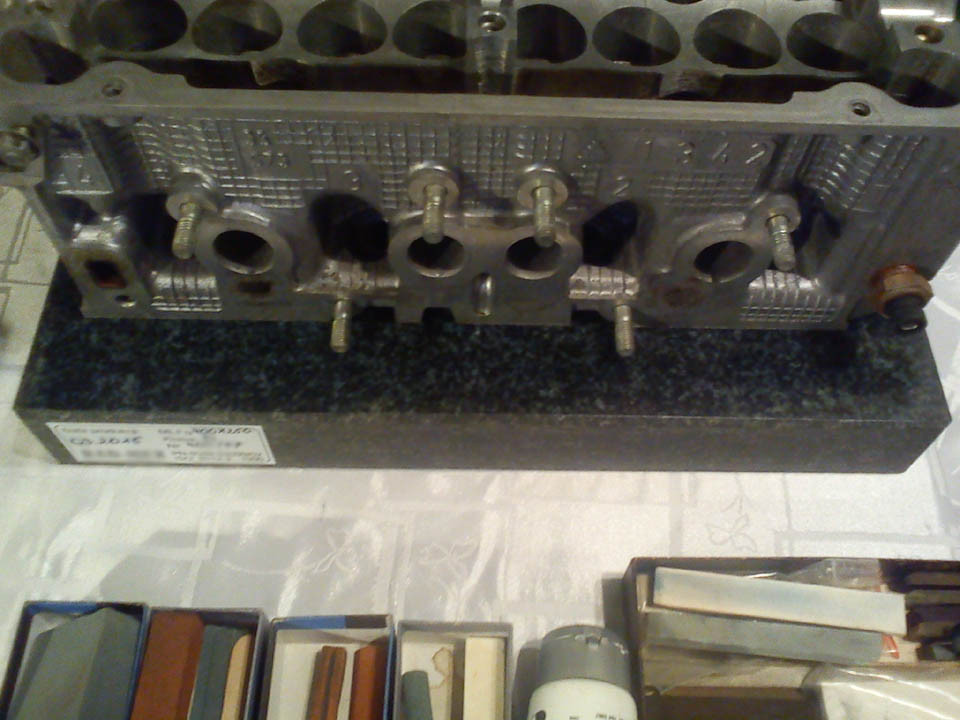

33. You can "read" the surface, where are high and low spots. You knock off the high spots, smooth area, clean, measure/check, and stone again. That's it.
34. If you understand what's going on here, you don't need any Guide. But just to let you know, best stones are die/mould making ("finishing") stones. Other, general purpose/sharpening stones are not recommended.
35. Almost done, about 0,01 mm out-of-flat condition. Good enough for this engine.
36. Areas not covered with blue, are in contact too, there are tiny traces/whiskers. So it will seal.
37. Flat, but not pretty (there's no "WOW factor"). It's not a beauty contest.

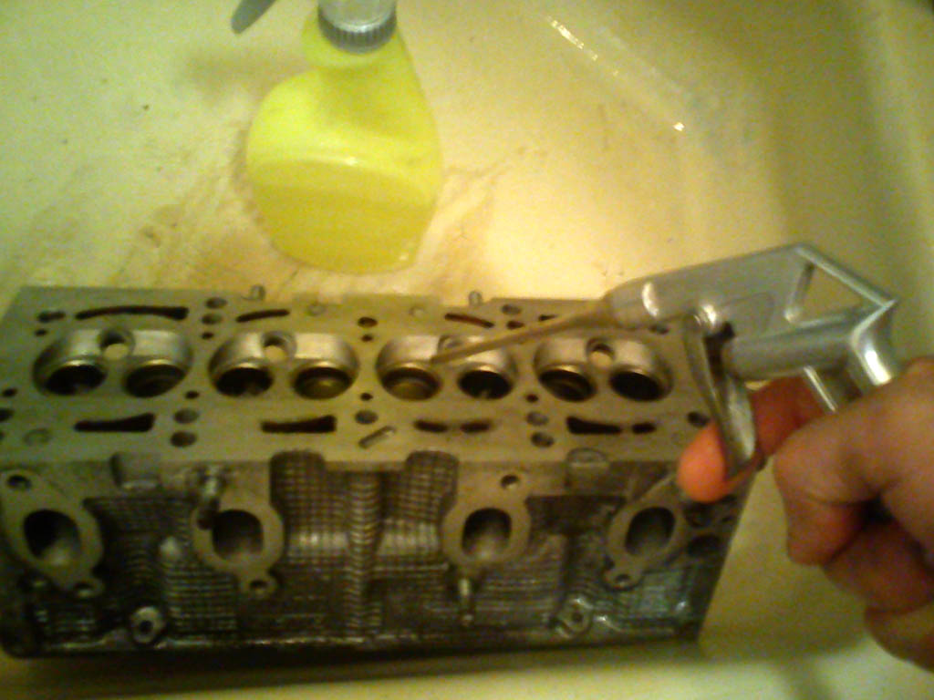

40. Clean the engine block, flush cooling channels if necessary. Limit use of abrasives. Oil contamination is a number one engine killer. Oil change is obligatory after such job.
41. Clean the threaded holes. Degrease the block, gasket and head surface.

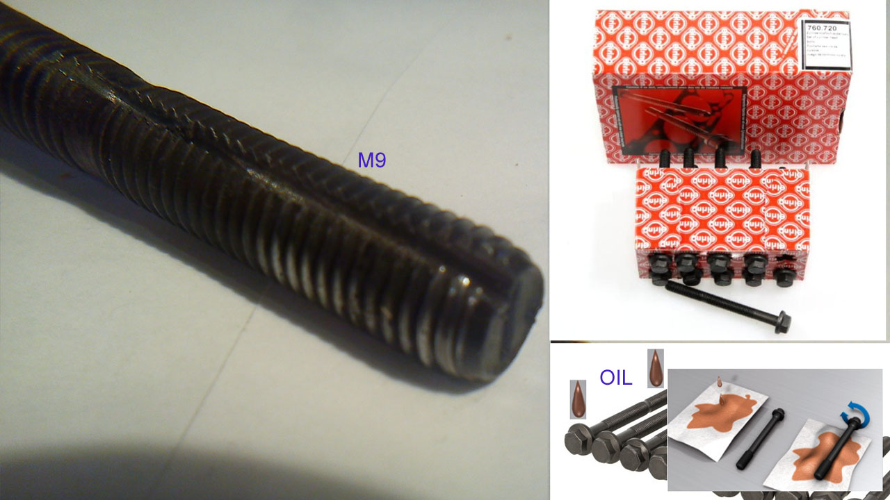

42. Torque and angle specs. Do not "eyeball" the right angle(s). Important.
43. Threaded holes in the block can be cleaned also with "thread chaser" DIY, from old bolt. New bolts should be lubricated lightly, drop of oil on the thread and on (under) the bolt head. Remove excess (paper towel).
https://www.victorreinz.com/en/service-downloads/practical-information.aspx
