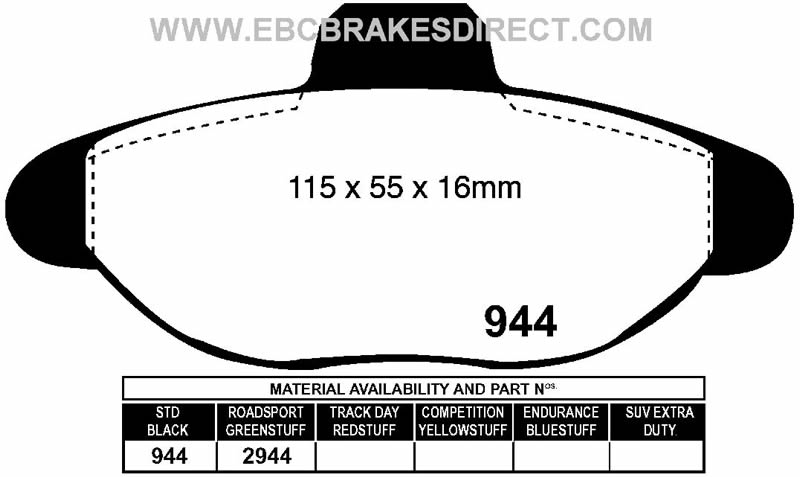

Apart from disks, new pads, 14" wheels and brake fluid, no.
