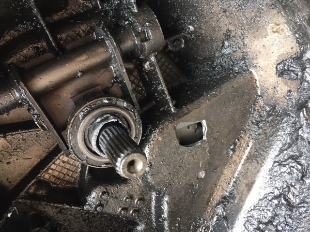

I looked through the inspection hole on the top of the gearbox and at first glance there is plenty of material left on the clutch plate and it looked dry inside.
As well visual, rub your finger on the inside and see if it's wet on the inside

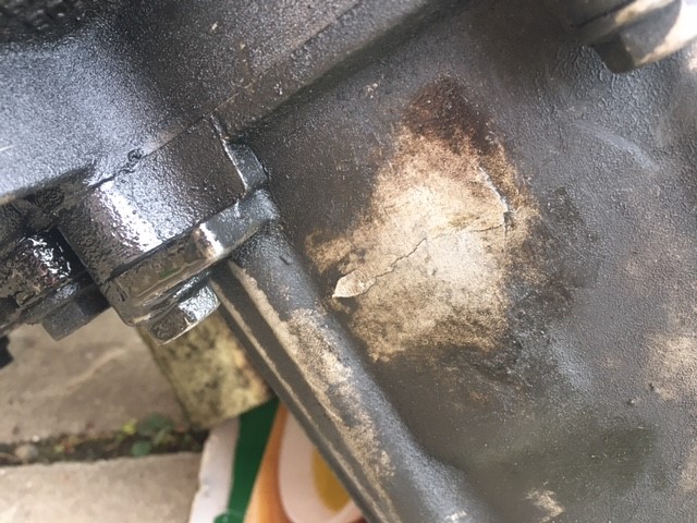

Underneath the car there is evidence of oil leaking where the gearbox meets the engine but it is hard to determine if it is engine oil or gearbox. .
I can't tell the difference any more, I opened a bottle of new gear and engine and sniff tested them, seemed close to identical to my nose
The bottom of the bellhousing is the lowest point so both engine and gearbox collect here

When starting the car in neutral leaving the clutch up you can hear a slight whine, which can come from the input shaft or the release bearing just touching the pressure plate. When you press the clutch the sound goes away.
When putting it in first or reverse gear and slowly letting the clutch out without any throttle it slips first with a whine than 9 out of 10 times you feel and hear a bang/kloink before it fully grips and you take off. The release/engage moment sits very high on the pedal. This is a mechanical clutch adjustment but looking at the cable it adjusted properly.

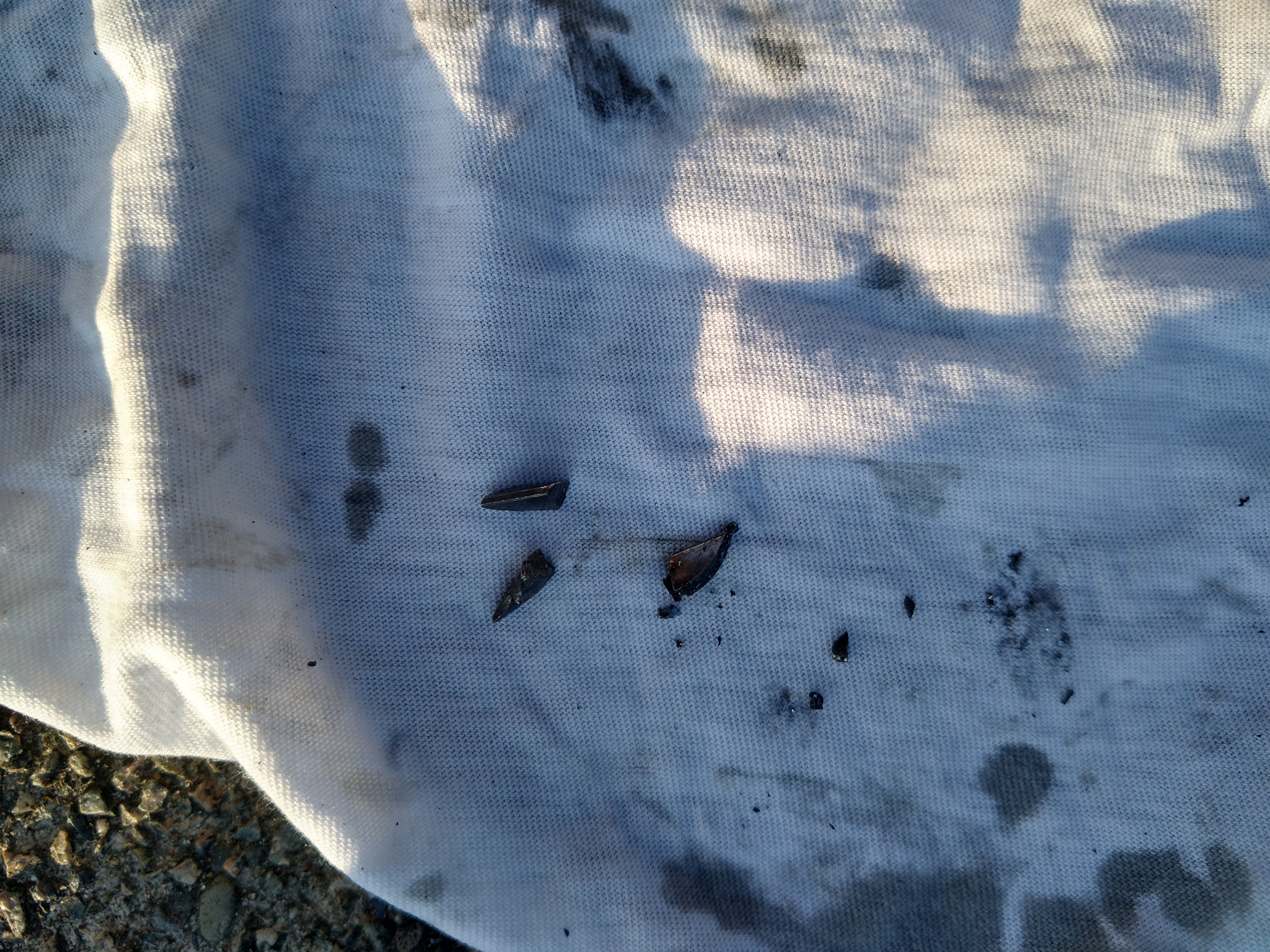

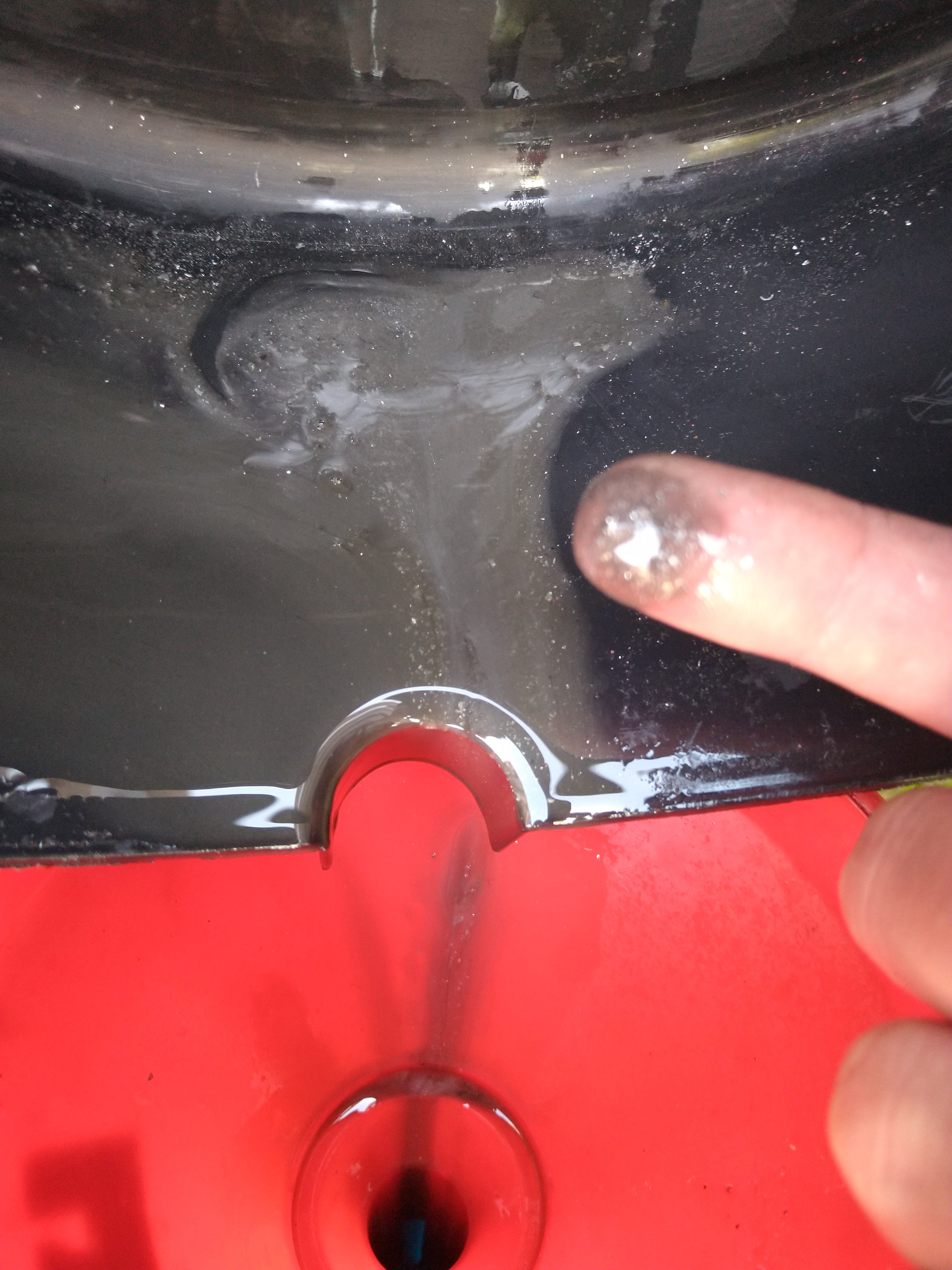

Against better judgement I drained the oil this evening. Does not looks promising. The big pieces do look a lot like gear teeth. So gearbox is coming apart.

Ouch !
Same thing happened with my brother’s grande punto, clutch oil seal died and he did not notice at all, bearings seized and every gear/synchro/fork wore out until it started making a horrible grinding noise … I had to fit the car with a spare panda gearbox I had lying in the garage but the final drive is much higher and the poor gp struggles a bit but at least is running again.
I think they are gear teeth and not from the housing. The chunks only have one edge that shows like it is broken off something. The other edges are smooth and the color of the material is the dark gray like the gears.
