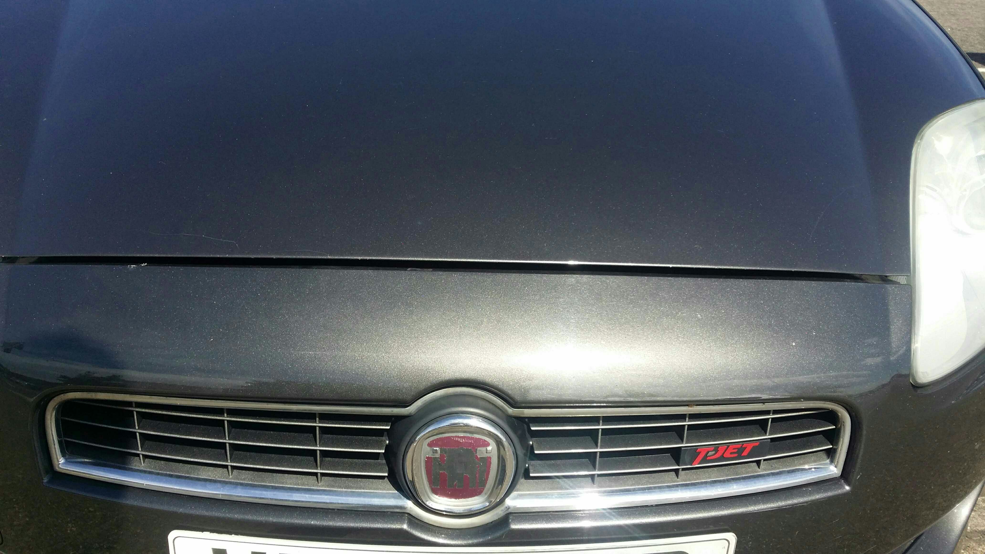

D dino166 New member Joined Jul 11, 2011 Messages 15 Points 6 Jun 13, 2017 #1 Hi any advise on how to change front fiat badge on bravo tjet car. It seems to me as I have to remove all front bumper to gat there.

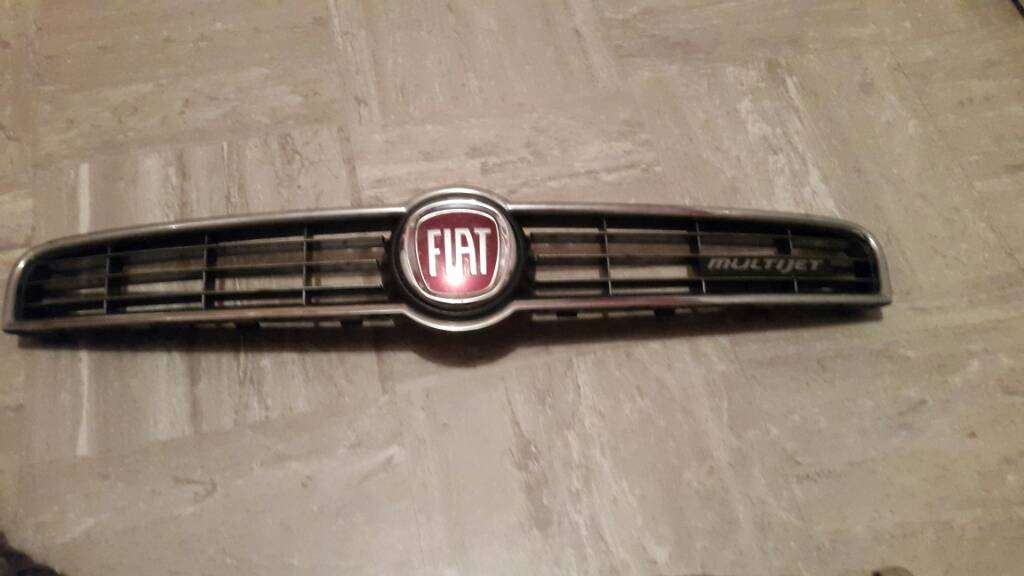

K kieran86 New member Joined Oct 12, 2015 Messages 4 Points 0 Jun 13, 2017 #2 The plastic grill pulls out, just give it a good tug lol.
OP OP D dino166 New member Joined Jul 11, 2011 Messages 15 Points 6 Jun 13, 2017 #4 kieran86 said: View attachment 181414 Click to expand... Thanks kieran Hope I won't damage it
K kieran86 New member Joined Oct 12, 2015 Messages 4 Points 0 Jun 13, 2017 #5 It's just on little plastic tabs, I think I pulled one side first then the other then the middle.
OP OP D dino166 New member Joined Jul 11, 2011 Messages 15 Points 6 Jun 13, 2017 #6 kieran86 said: It's just on little plastic tabs, I think I pulled one side first then the other then the middle. Click to expand... Ok cheers

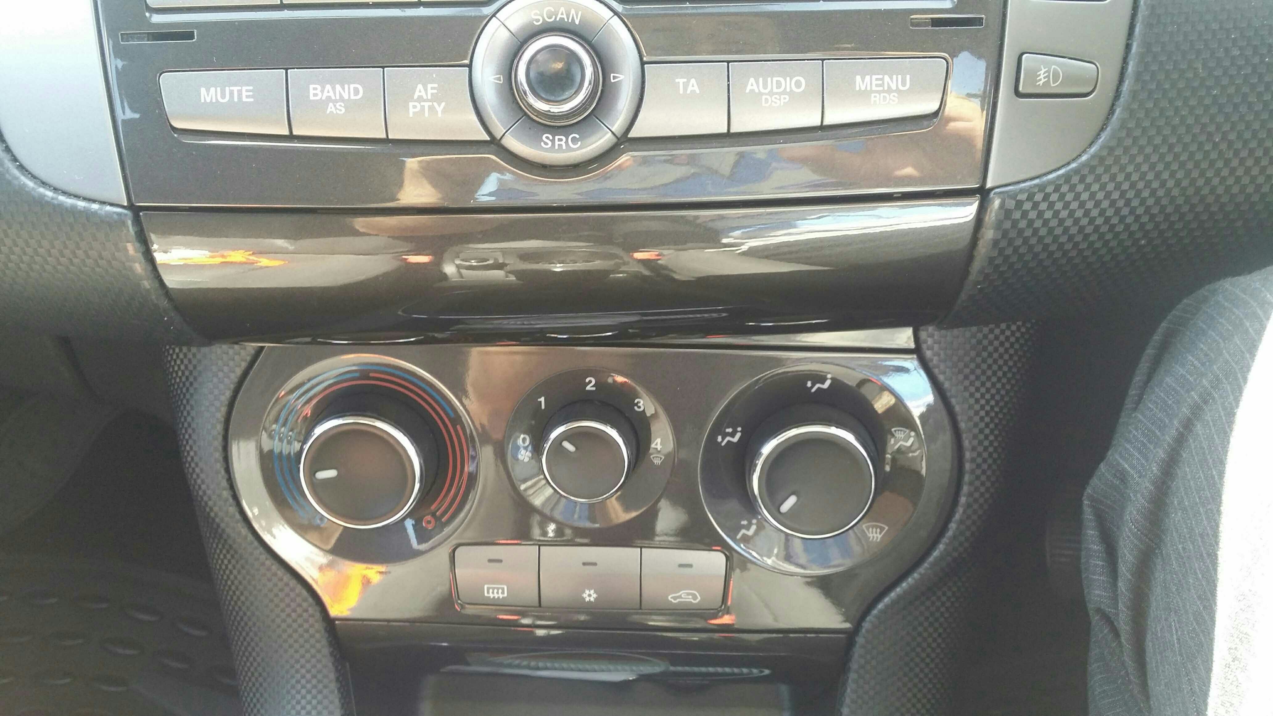

OP OP D dino166 New member Joined Jul 11, 2011 Messages 15 Points 6 Jun 13, 2017 #7 Any advise also how I can change the bulbs behind the heating knobs in fiat bravo. I attach a picture as well. Regards.

D Donniehun New member Joined Apr 23, 2010 Messages 12 Points 1 Jun 18, 2017 #8 Hi Dino, it's in the guides. https://www.fiatforum.com/bravo-guides/308785-replacing-failed-bulbs-heater-control-panel.html

OP OP D dino166 New member Joined Jul 11, 2011 Messages 15 Points 6 Jun 24, 2017 #9 Donniehun said: Hi Dino, it's in the guides. https://www.fiatforum.com/bravo-guides/308785-replacing-failed-bulbs-heater-control-panel.html Click to expand... Hi, thanks for your information .it's so helpful I successfully changed the bulbs after ordering them from the dealer which arrived after three days.
