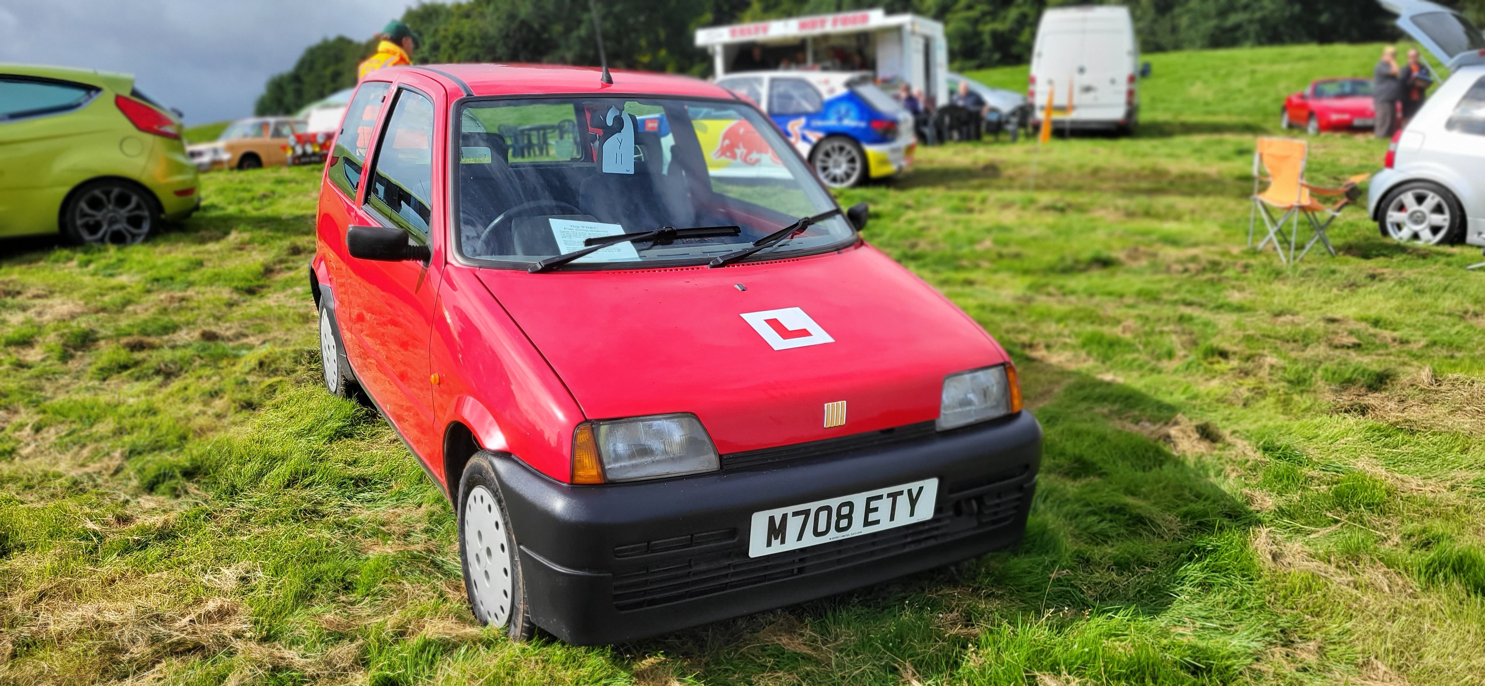

At the Wigton Car Club Classic and Motorsport day at Dalemain House Yesterday
