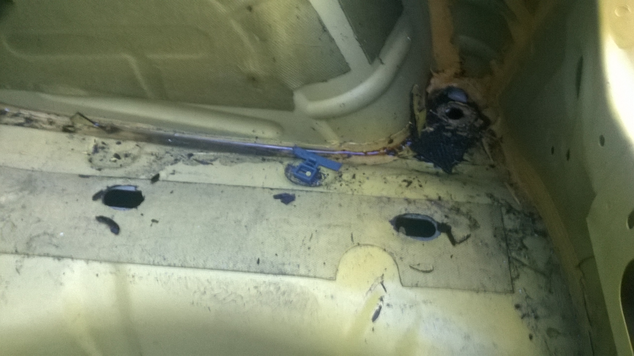

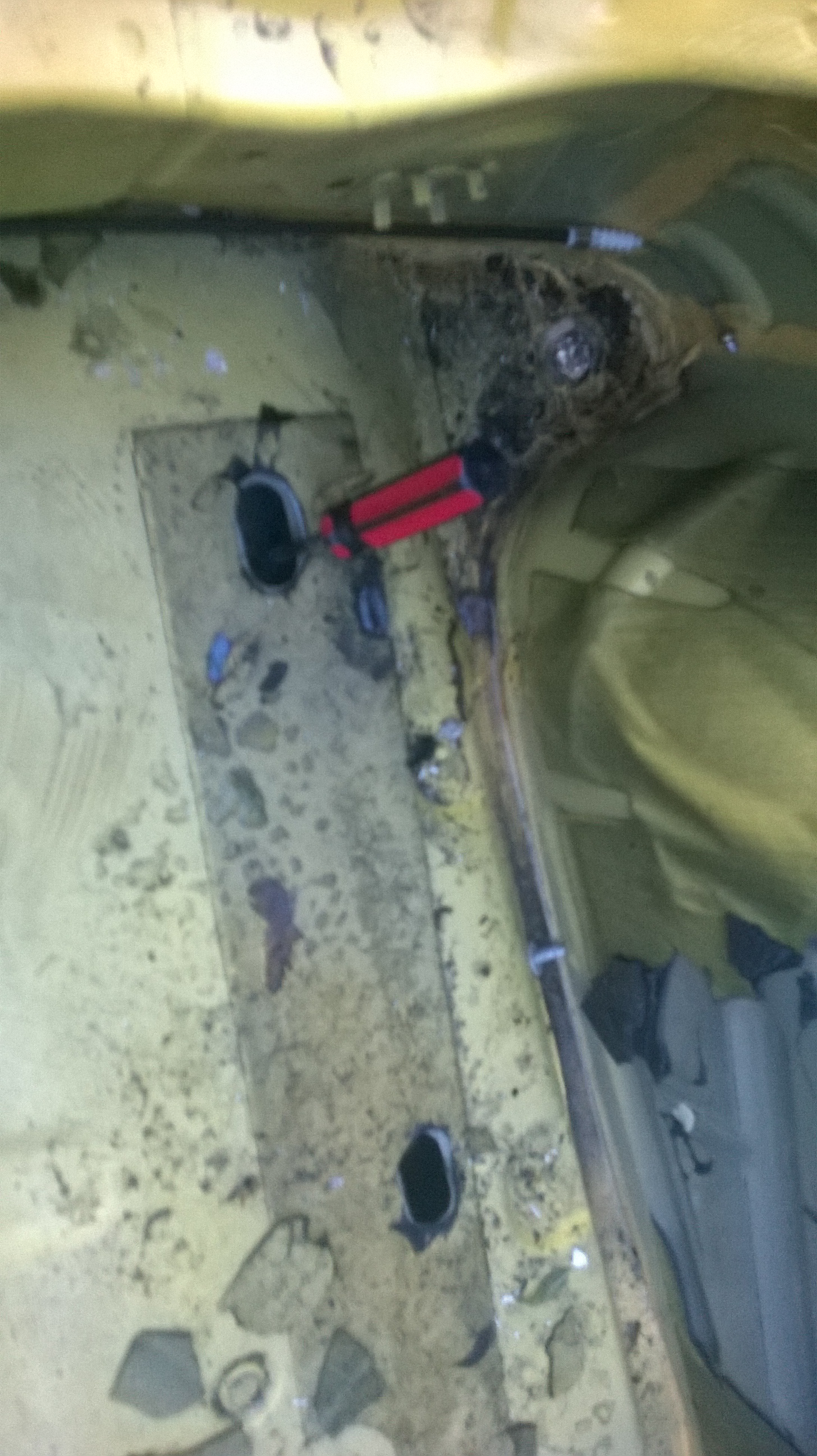

look in boot floor, you will see painted style protective tape.
press on it and it will reveal 2 oval holes per side,
this is where you drop in the special square lockers,
look in corner,drivers side rear, you will see gromit. (wheres wallace?)
anyhow this is where you feed up wiring from towbar into lights,
remove bumper,
lower exhaust back box, no need to remove, but support it, dont bother with rubber exhaust mount just undue 13mm bolt and lower bracket down this has two plastic locaters,
pics here may help.
