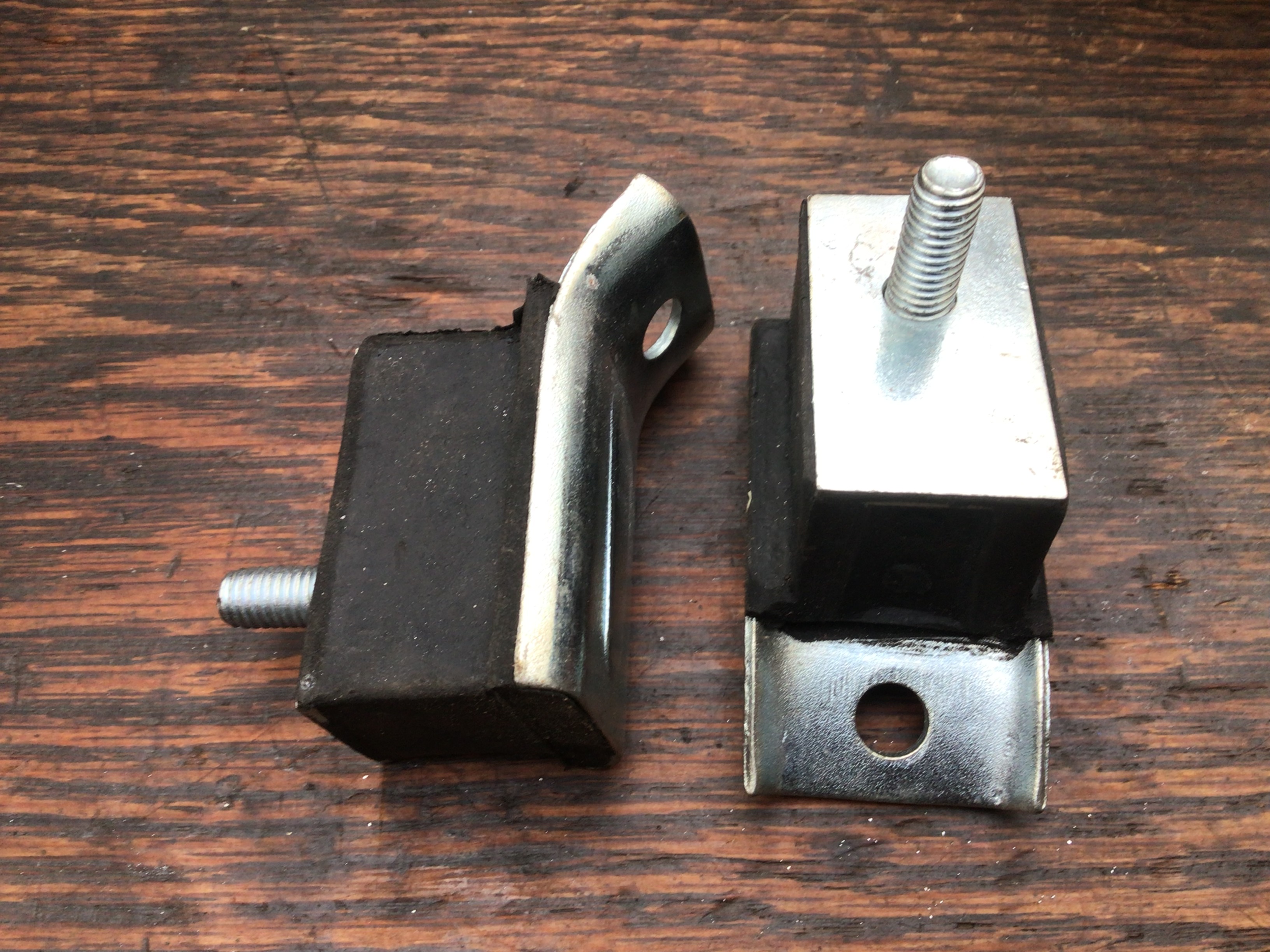

Without a video, it is difficult to diagnose, BUT it could possibly be that a broken gearbox mount is allowing the gearbox to hit the body as it moves around during a gearchange, or when you press the clutch pedal. The top of the gearbox runs close to the underside of the bodyNot really. It’s is a banging noise.
Do you by any chance have a part number or picture of the gearbox mount?Ok. Thanks I will check that out
Thanks,View attachment 392490Got a new pair on the table right in front of me

The mounts for the 2 gearboxes are the same---1 mount per side. They bolt onto the side of the gearbox (at the front of the gearbox) and fit between the gearbox and the small cross-memberI forgot to mention my 500 has a Fiat126 engine. Does that affect the Gearbox mount?
