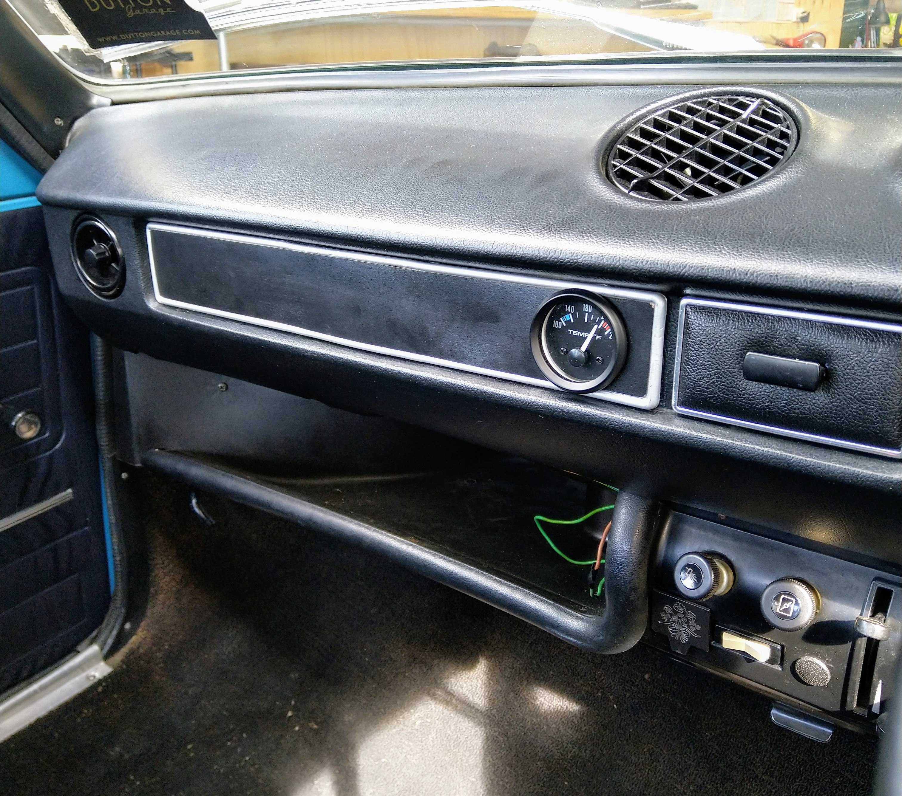

Well, finally, after a ridiculous amount of effort, I removed the old, broken steering wheel. We are obviously in total lockdown here so had to make a puller tool (not strong enough) and a second puller tool (just strong enough and no more) and it finally came with an almighty bang.
I can't get the self cancelling indicators to work though. The ring with the hole in it just spins and only very occasionally catches so I'm assuming some sort of adjustment is required.
New 128SL wheel fitted and, if we ever get out of lockdown, I reckon it'll be nicer to use.
Also my mechanic fitted a water temp gauge and my brother in-law and I made a new dash panel as the original one had been cut to fit a tiny speaker and looked awful. You may notice the high temp reading which is not right. So we have a new Celsius gauge on order.

Nice job on the dash panel (y) It's probably a very good idea to have a water temperature gauge on a 128. If I might make a suggestion - whenever I've fitted accessory gauges, I try to angle them towards the driver if possible. You might be able to cut a short length of black pvc? plumbing pipe at an angle to fit between the gauge and the dash panel i.e. straight cut end fits against the gauge, angled cut against the dash panel, might have to slightly 'ovalise' the dash panel hole to suit.

good idea about angling the gauge toward the driver. I will do that.

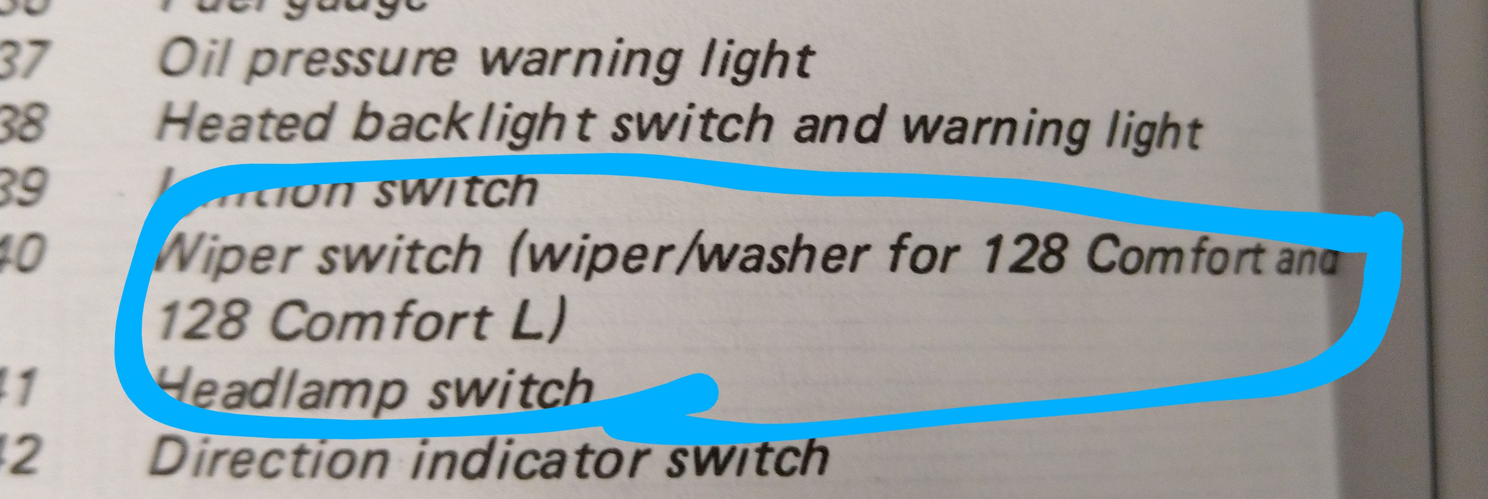

I had a sift through the Haynes manual and discovered a green and black wire that runs an electric washer motor on the UK only 128 Comfort. My car is fitted with the factory vacuum washer but I wonder whether this is what the wire was for but never used? No 128s were fitted with electric washers here.

Oh wow, that's exactly the same, and cheap. So it does seem the extra wire is for an electric washer.
Here's the Haynes manual description that references a verde/Nero wire on the corresponding diagram.

Sorry I missed your post #30 while I was looking up the column switch on Car Builder Solutions and composing my post #31 . So, the mystery has now been solved. (y) I wouldn't be surprised if you now started thinking about converting your screen-washer to electrically operated, even though you were quite happy with manual operation up to now. :D
