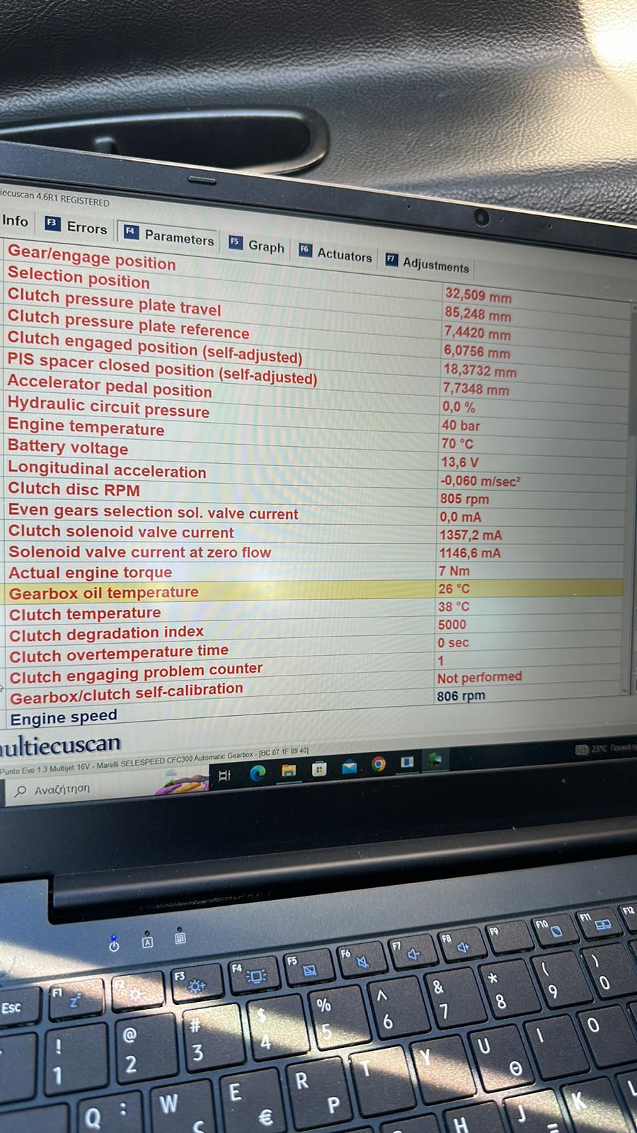

Hello I have a Fiat Punto evo 1.3 mjt 95ps with dualogic (selespeed) gearbox, before 50.000 km i change the clutch and bearing also, everything is ok but before 1 month the car when put 1st or reverse gear kicks 4-5 times and get error about gearbox I’m trying with multiecu software and give me error about gearbox subsystem , when execute calibration of Clutch every thing works again for a little time and when drive again get some error and stop works any idea ?
