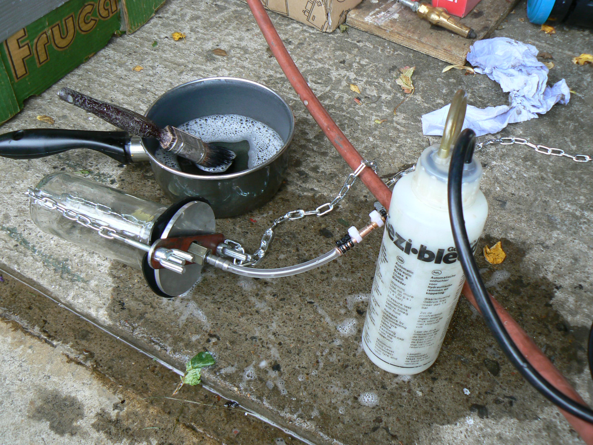

So, thought I'd have a go at making one. I've actually been thinking of doing this since I realized a nice dished aluminium "washer thingy", which had been part of the transport securing fittings on an old washing machine, would be a good starting point. I have a box of various fittings which I rifled through and between that and some brake stuff I came up with this:
The hooks are actually a M6 turnbuckle cut in half and the big seal is a circle cut from an old inner tube. You have to remember that because it was a turnbuckle one of the screws tightens clockwise and the other anticlockwise - I can live with that. Talking about "life" I'm not too sure how well the rubber seal will fare. The brake fluid is going to attack it but I'm banking on it not giving in during a quick bleeding operation. If it proves to be problematic I've heard of a type of rubber sheeting used in roofing which will resist it - I've a friend who's a roofer!
The proof of the "pudding" is always in the "eating" though isn't it? So having cobbled it all together it was time to pressure test it. I had to cut the original end off and join it to the pressure vessel:
It's all a bit Heath Robinson and I wouldn't have been surprised if it leaked all over the place, but I didn't want to spend much money in case it didn't work - I was particularly concerned over whether a seal could be achieved on to the master cylinder. So, how to pressure test it? Just by chance I had a curry mix jar in the glass recycling which had a neck size similar to the Honda's! So I coupled it all up and hauled Twinkle's spare tyre out to use in the time honoured fashion:
I started off at 5psi and worked up in 5psi increments to about 35psi checking with soapy water for leaks every time.
I was a little worried about the jar maybe blowing up so I kept it covered with an old sheet each time I made the new connection but it was fine. (wonder how much it could take?) Gunson recommend that you not exceed 20psi and I actually blew a reservoir off the master cylinder once by trying to force things! so I think if it can stand around 35psi it's going to work just fine.

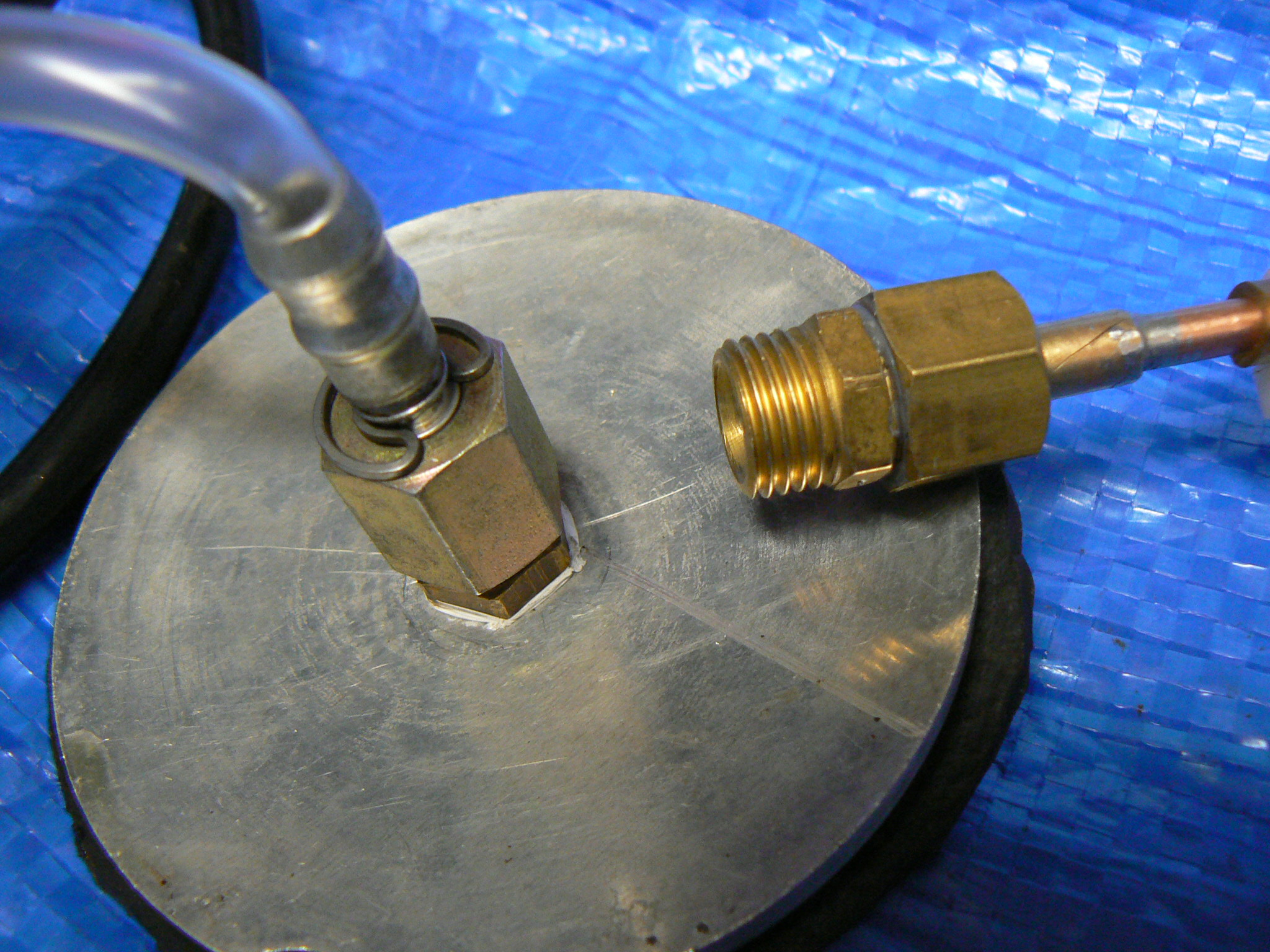

I left the original entry "hanging" a wee bit because I hadn't completed adapting the original cap adaptor to fit the new end of the pipe from the pressure vessel :confused: Hopefully the following pictures will help clarify what I mean by that.
I got as far as this with it before breaking off:
Now my brain is rested I've changed it a little bit from my original idea which would have involved two cable tied connections. It now has only one and the new bit is soldered to a short length of brake pipe which is secured into a connector suitable for the taper type connector on the universal cap I've already made:
To change over from one to the other all that has to be done is slacken that big nut on the top of the universal adaptor and screw it onto the end of the one I've just completed. You can see that the seal is made by the tapered end on the connectors - I've included a spare connector in one of the shots so you can see how the tapers go together. I do wonder how often I can swop them over before the taper fails to seal? But as I'm only using this on an occasional basis maybe it'll outlast me?
