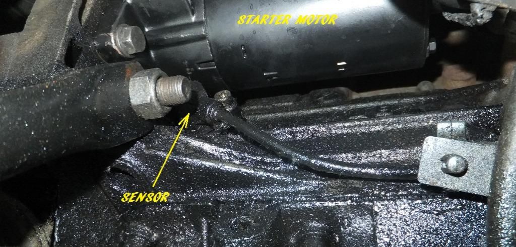

I picked up a replacement Sensor from my local GSF shop, £22.
I was expecting an integral lead, judging from my searching on the 'net, but this one (referenced against Reg) is just a Sensor, with a two-pin socket (was expecting a 3-pin connection). I'll get underneath later/tomorrow and take a look at mine.
Nice piccies BD (y). Shame that you got the wrong lead though. I must admit, the only sensors I've seen being sold as suitable for the JTD Multi all have the integral lead. Where did GSF get their info?
No idea, just gave them the reg and that's what came up.
Could have been in the wrong box on the shelf, or labelled wrongly I suppose.

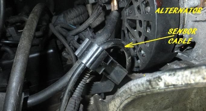

New Sensor fitted, just have to wait and see if it's sorted the Starting problem . . .
What is it with car designers, why do they feel the need to have a different locking method for just about every electrical connector on the car?
It seems the more inaccessible they are, the more complex the locking method is as well, this one might as well have been one of those chinese puzzles for all the hope there was of me disconnecting it with one hand :bang:
Took off the plastic support in the end, just one bolt, so no big deal really, but had to destroy the locking mechanism on the plug attached to the loom itself, to get the whole thing out . . .
