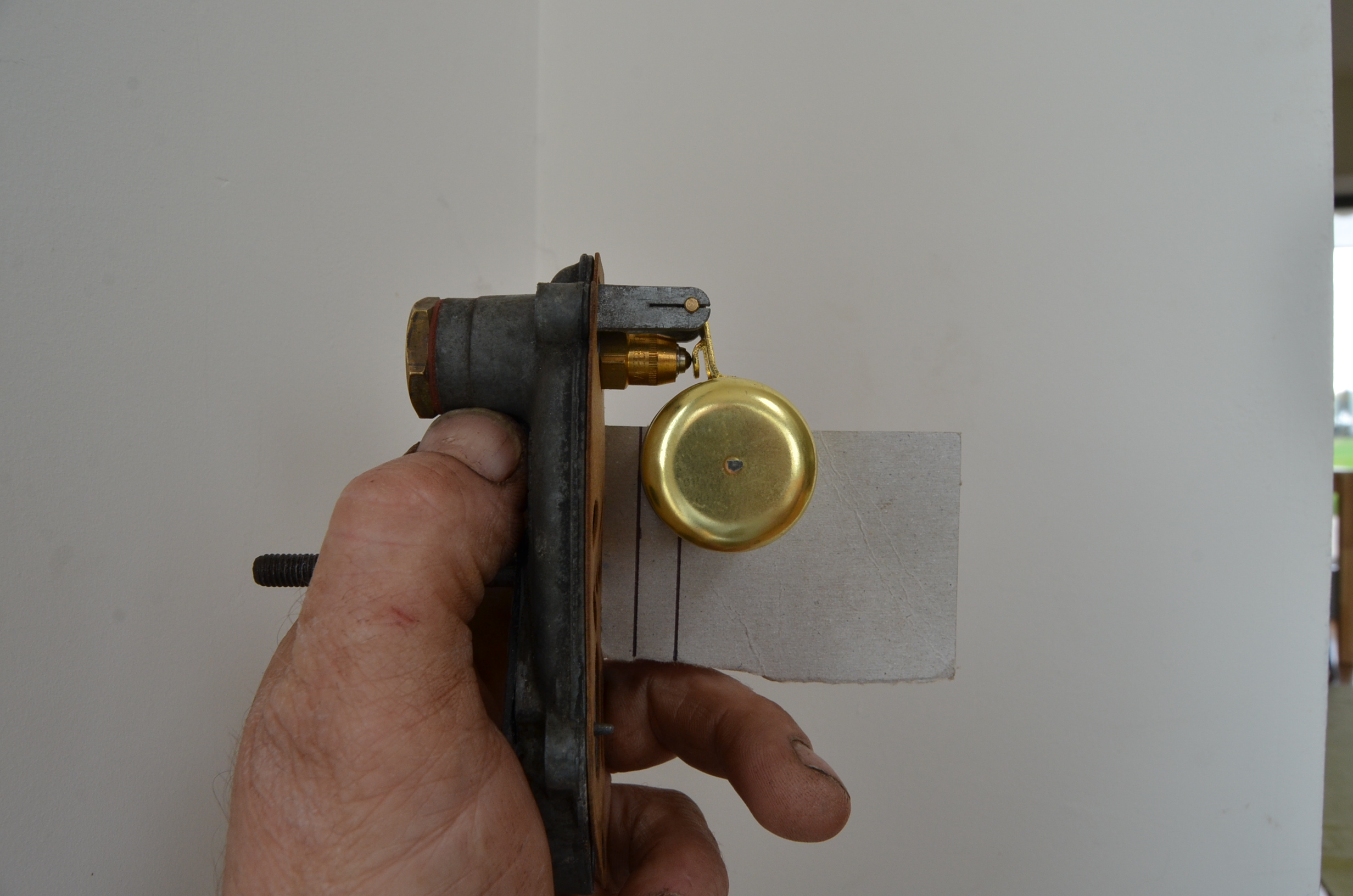

To measure the float hieght, hold the carb top VERTICALLY so that the float is just hanging down. The easiest way to measure the float hieght is with the bare shank of the appropriate sized drill (7mm) between the body of the float and the carb-top gasket (the gasket must be in place)---much easier that trying to actually measure it.
Another way to do this; images posted previously from 2014.
