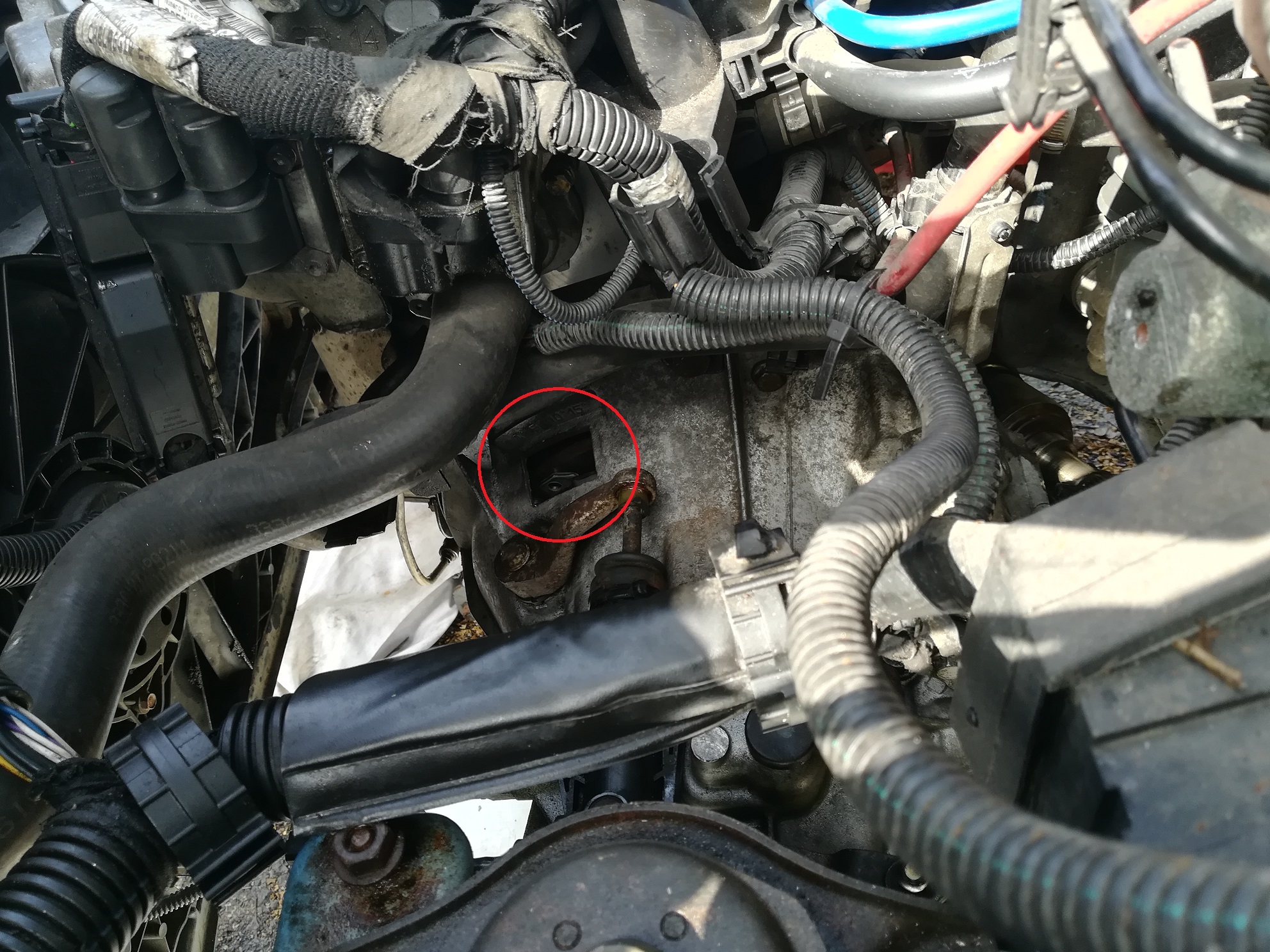

You can check if the bearing has failed by sticking a finger through the inspection hole in the bell housing - with the engine off!
It'll be filthy inside, but should be dry and dusty. If it's wet and black and smells of transmission oil then the bearing has caused the seal to fail and leak.

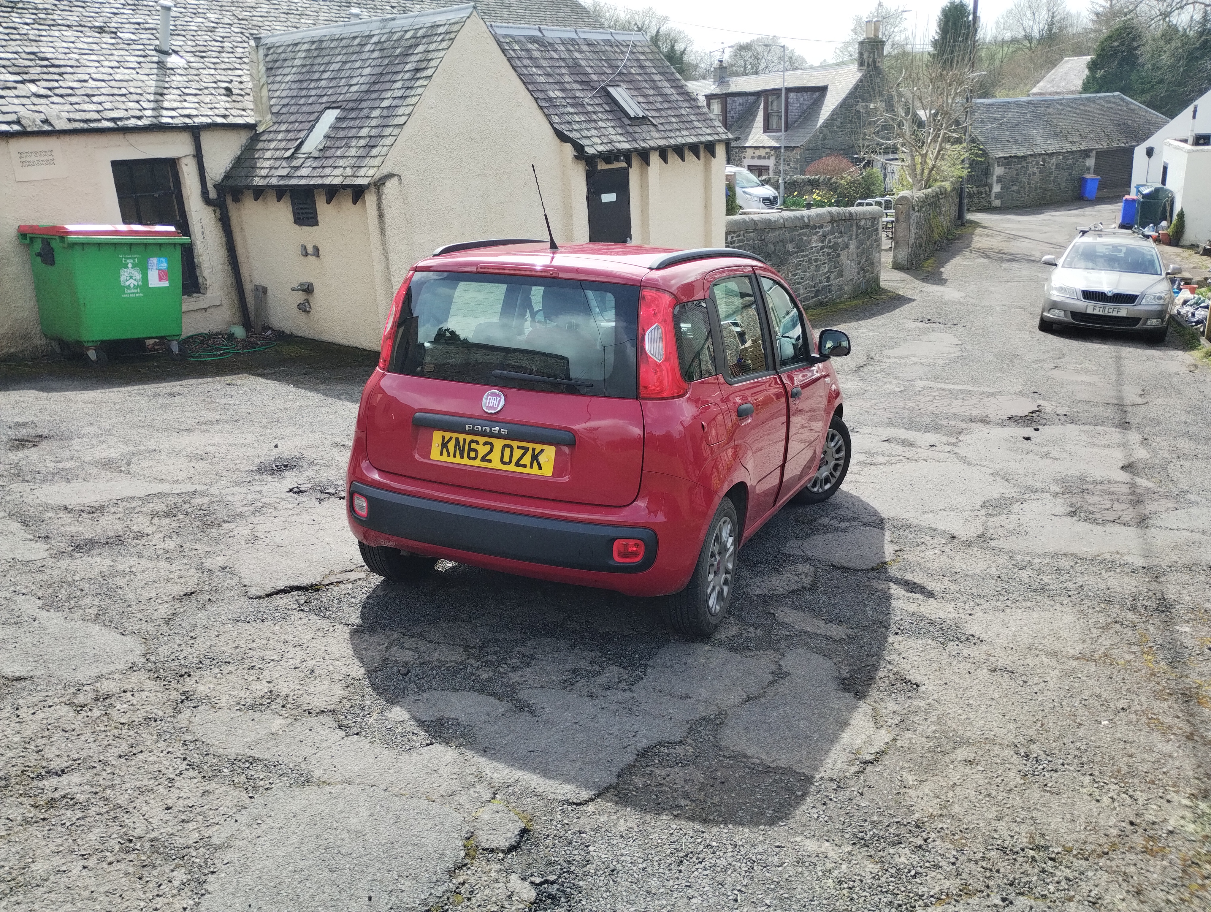

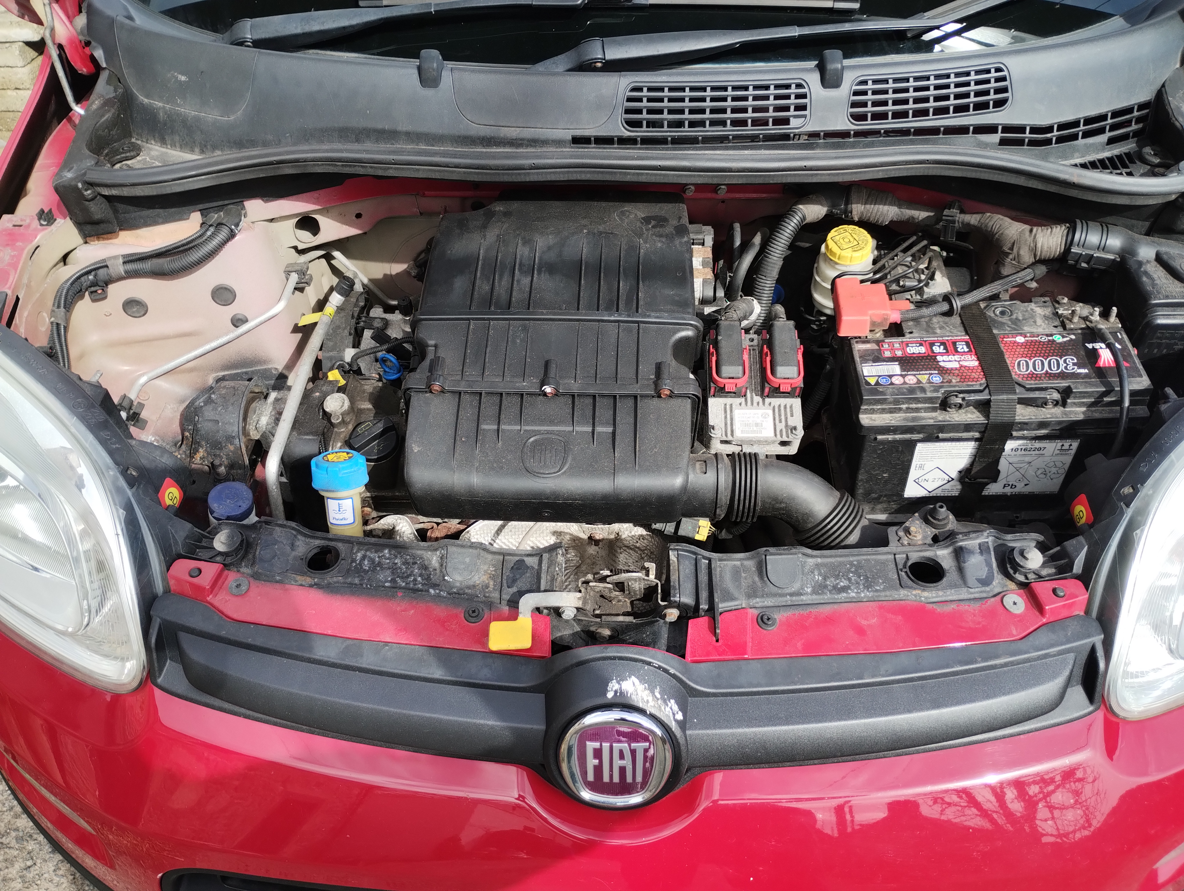

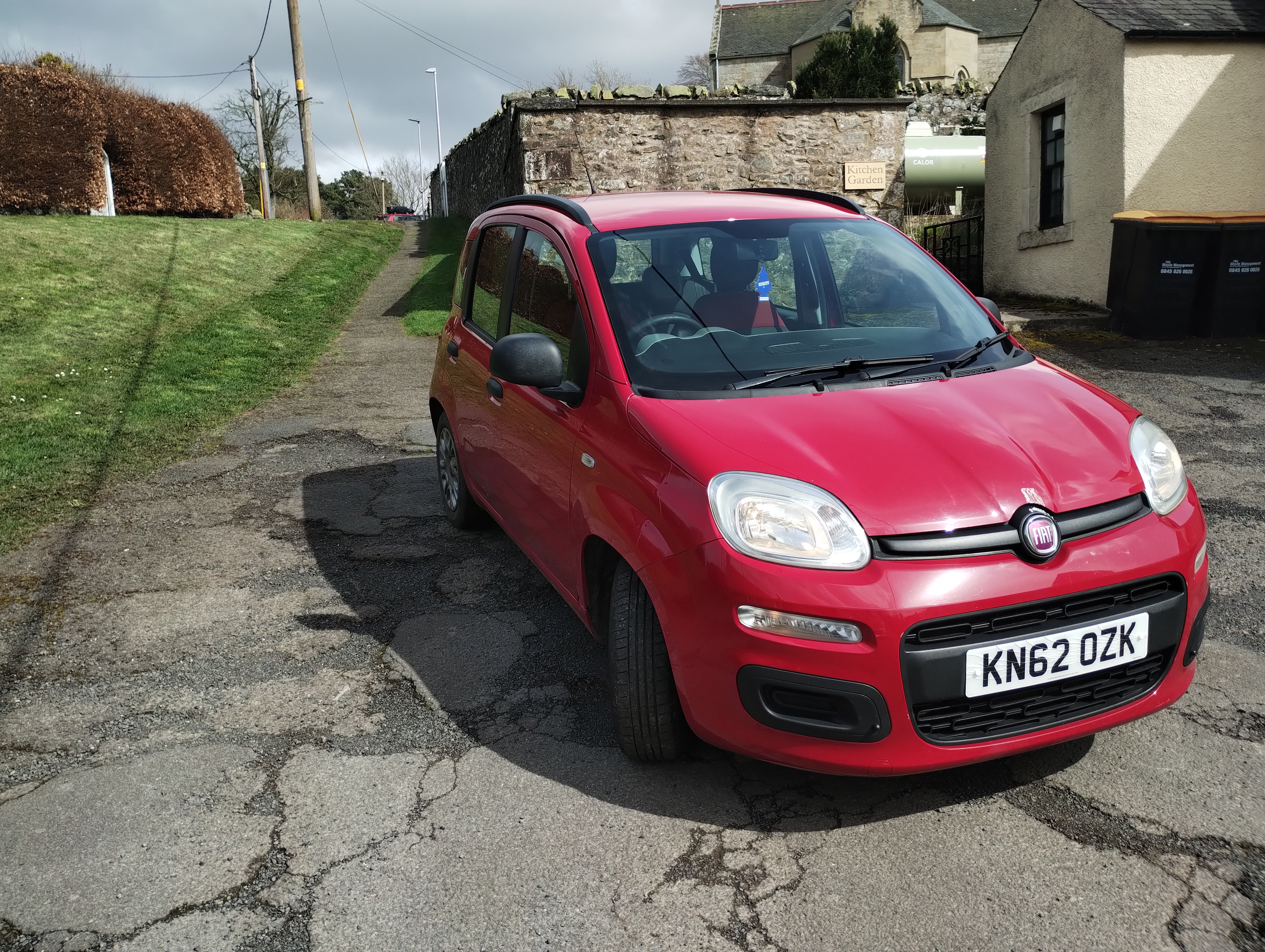

Thanks for all the advice. I was tempted by the older models too, but I've ended up buying a 2012 new model Panda this week, 98k miles. Quite reasonable condition, but no service history. It looks like it has had an oil change recently. Overall I'm quite happy with it, but a couple of niggles:
- clutch bite is a bit high, but I can get used to it.
- Headlights seem to be permanently on, I gather this may be related to a recall issue?
I guess I'll also need to decide whether to get the timing belt replaced...
Timing belt was quite easy on them. Sump on the other hand can be a real pain. Worth checking it for corrosion.

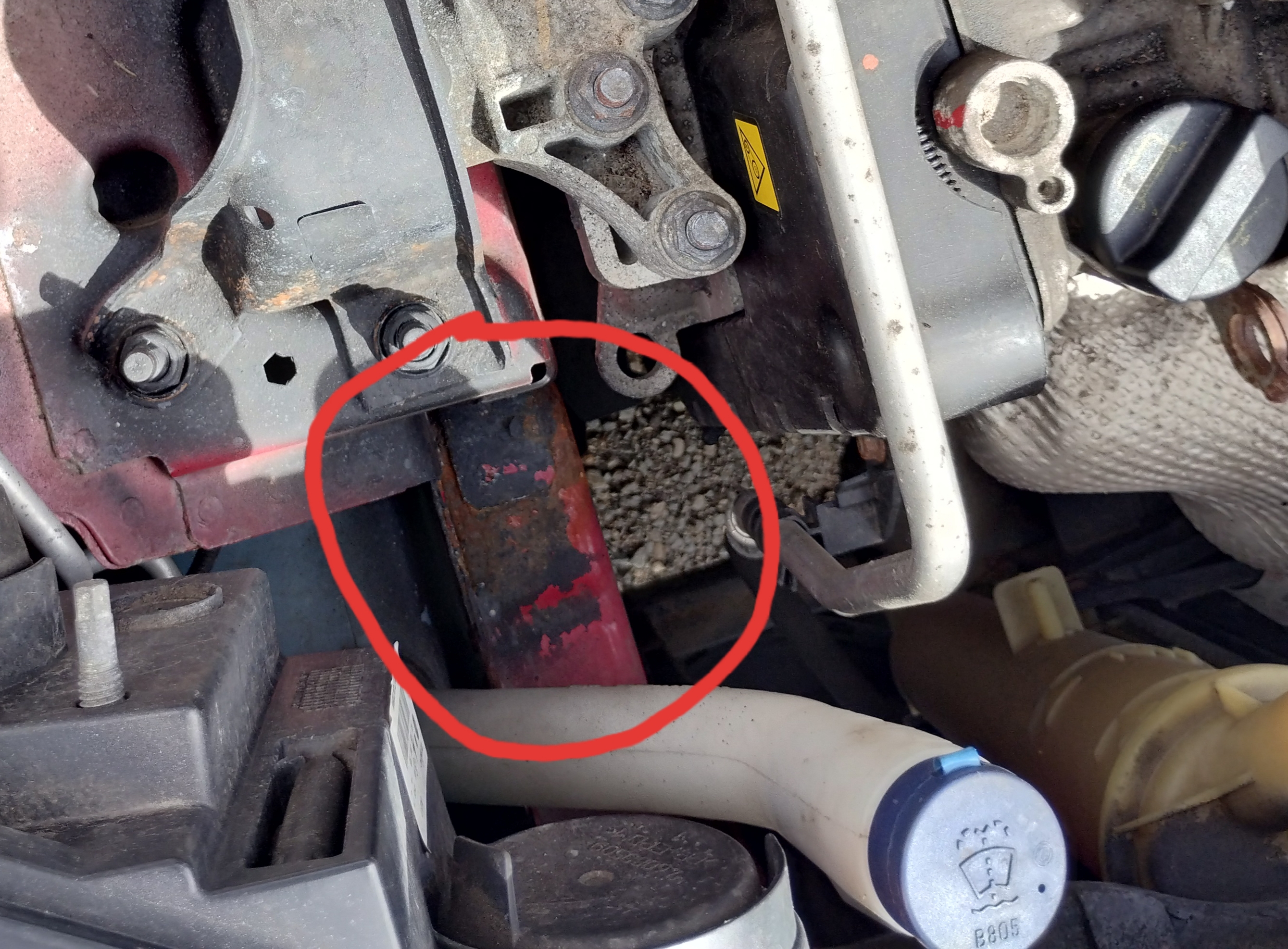

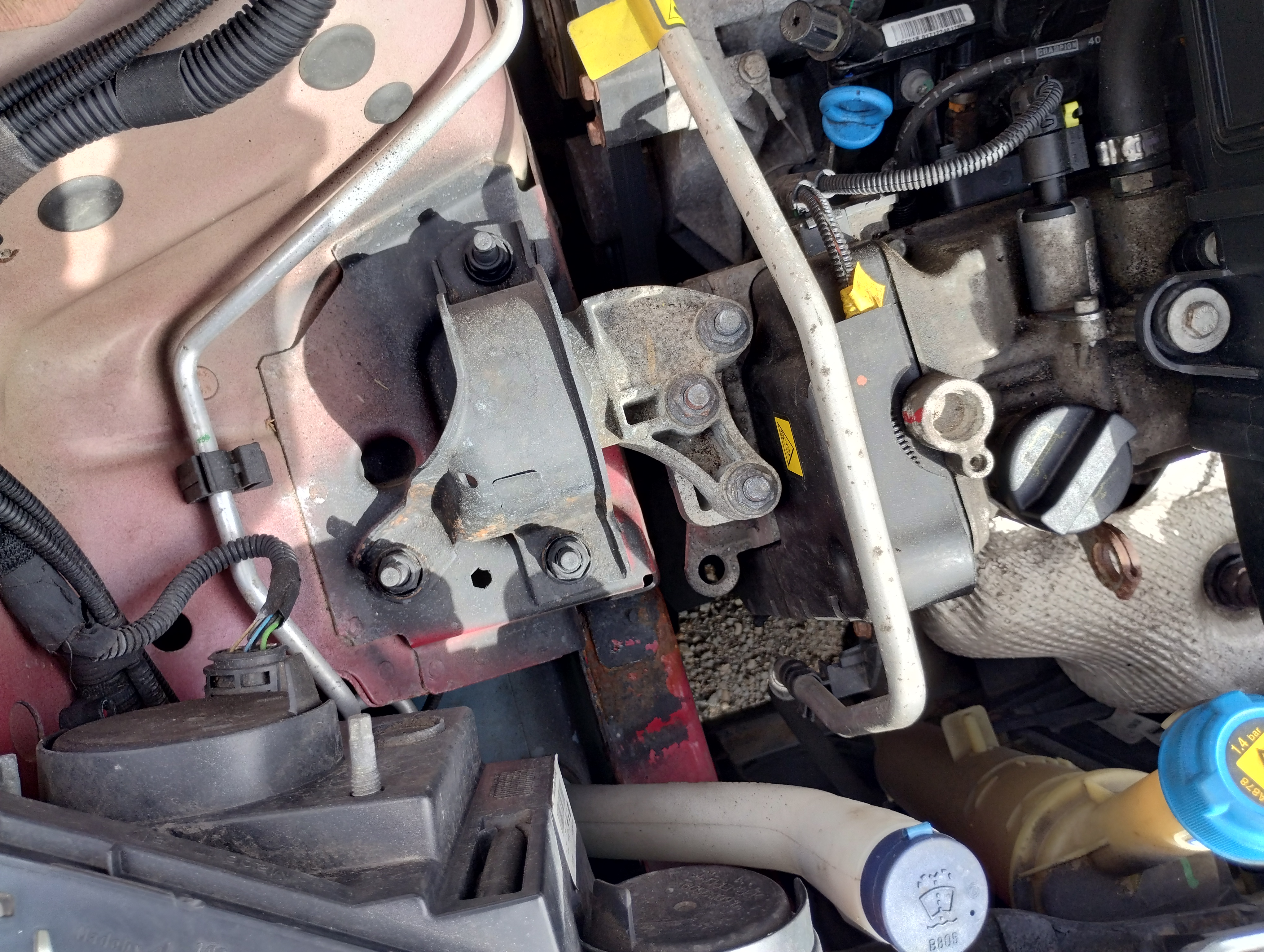

Congrats on your purchase, looks really clean for it's age, the only thing I would suggest doing though is getting some rust converter on that front leg in the engine bay as I noticed the slight surface rust on it when i saw the picture, I've marked it with a red circle in the pic, whoever owned it previously must of looked after it as red is notorious for fading quite quick if not kept on top of
