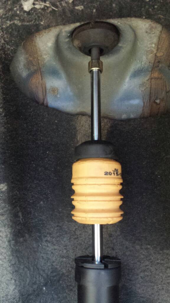

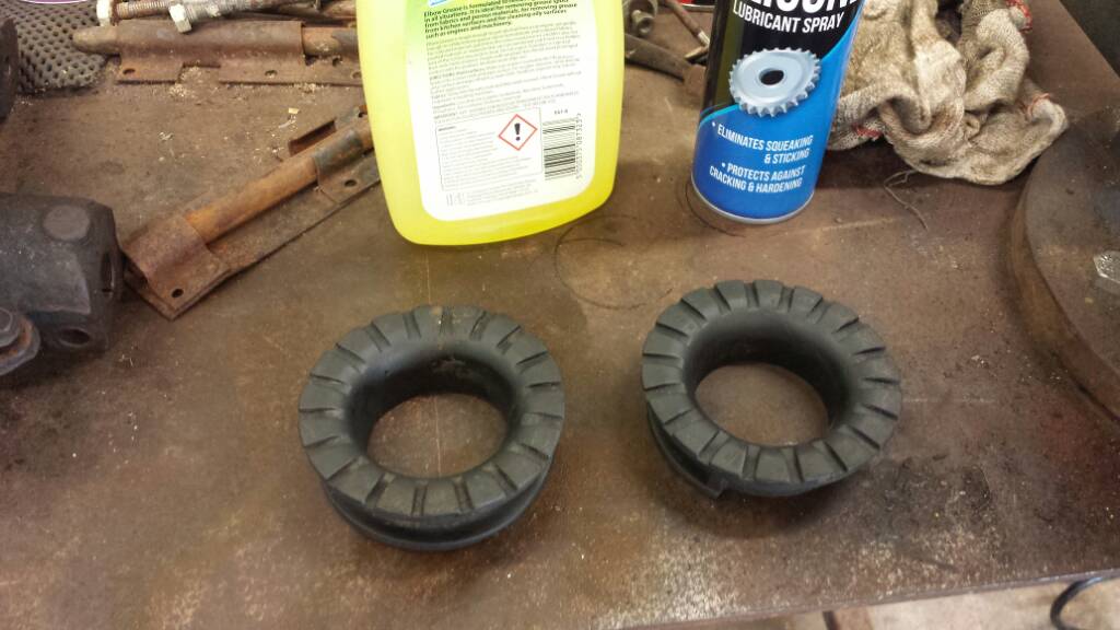

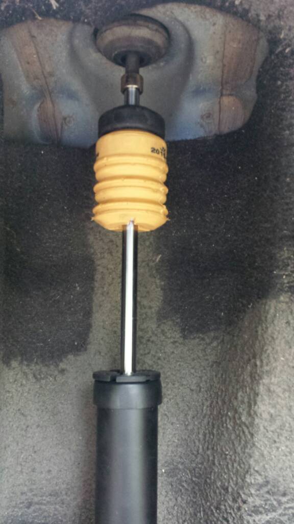

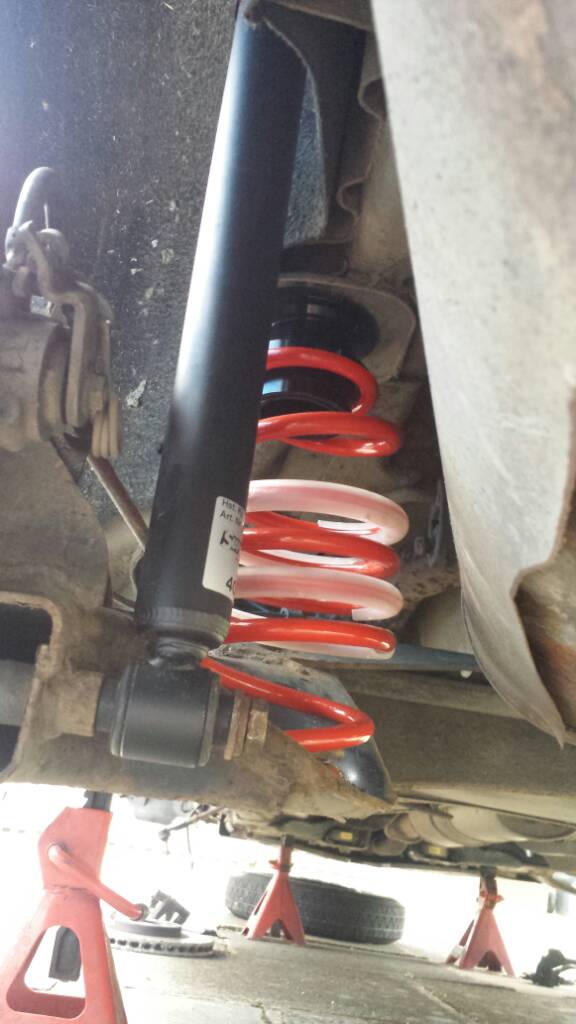

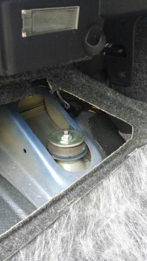

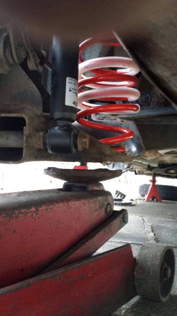

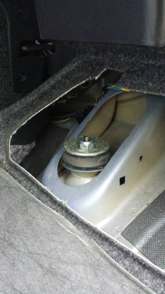

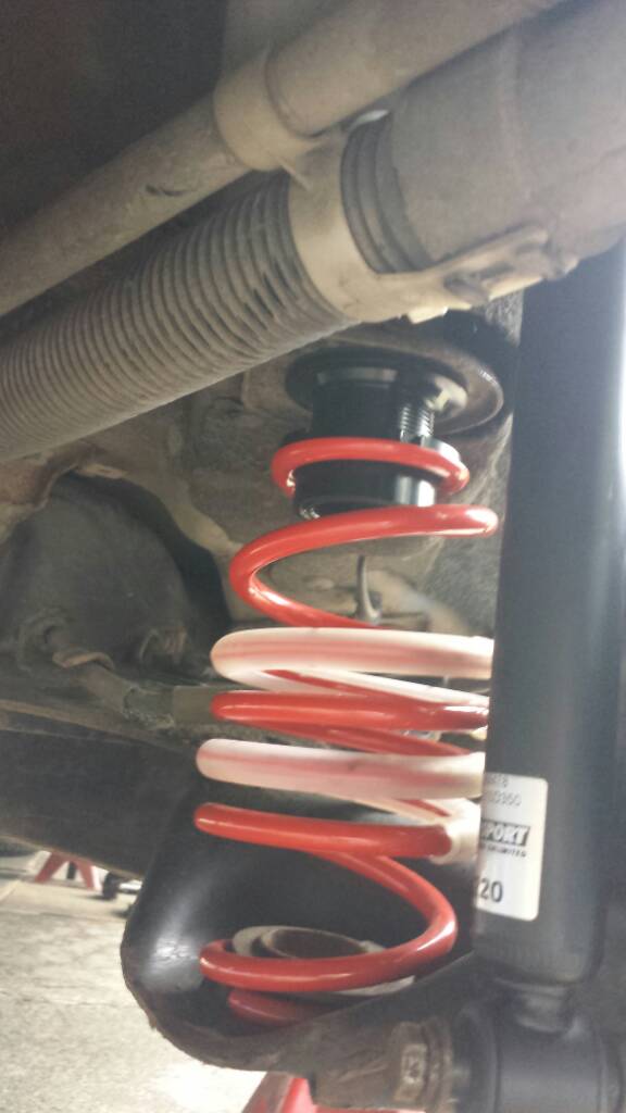

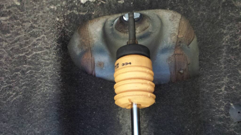

The instructions that came with the kit where very vague and it got me very worried, i need some help now on the rear end, i have fitted new springs and attached shocks to the rear beam.. in struggling with the top mounting inside the wheel arch.

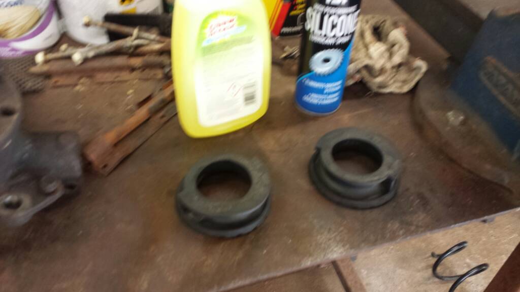

There is two rubbers, i have no idea which way round they go... each side on the rear where not identical so someone has most likely worked on it before and not put it back together properly so now im stuck.
Attached is a pic of the two rubbers, one small one and one large one but where do they go?
Okay so a few phone calls to fiat and suspersport... the rear end is done... would still like a 2nd opinion thought.
The biggest rubber whick is in the boot under the metal plate and bolt.
The smallest rubber whick is underneath meeting the other whick above.
I have nipped it all up tight then lowered the bottom, just need to remove the stands on rear then loosed and then nip & torque the lower nut to release strain on the bush.

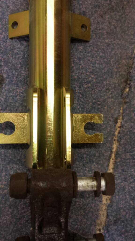

So the coilovers i got don't fit on the front :(
My hubs carrier wont slot in to bolt up.
It appears that fiat have fitted the abarth ones.
Can they be downgraded.
I have rang a few places and no-one has done it.
It was a big thing on vw's and was a direct fit (or so i was told)
But.. im worried about the hub itself and the drive shaft ends... will they fit a smaller hub carrier as a direct fit and is it safe to do?

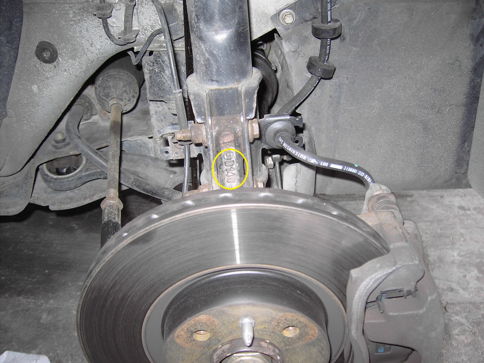

Would definitely not recommend downgrading any suspension parts. :nono:
There are 3 different versions of the cast iron hub carrier. For the left one, part numbers are:
50701137 Only fitted to early cars with the 1.2 engine.
50701139 1.4, 1.6, 1.8, JTD 80, 90, 105 and 115.
50701141 JTD 126, 136, 140, 150 and 2.4 Abarth.
There may be a 3 digit casting number on your hub carrier that coincides with the last 3 digits of one of the above part numbers (as in my picture below) to confirm which hub carrier you have. My picture is of the right side, so ends with 140.
Not sure, but I think only early cars with the 1.2 engine had the narrow top mounting hub carrier. If that is the case, then it's somewhat disappointing that the supplier has sent you shock absorbers that are only suitable for the lower power and weight car. If they were supplied as a kit, then the springs will also be unsuitable for you higher power and weight car.
I've also read somewhere that the dimension between the 2 fixing holes on the top of the hub carrier and shock absorber can be different. I don't recall which of the 3 versions is different.

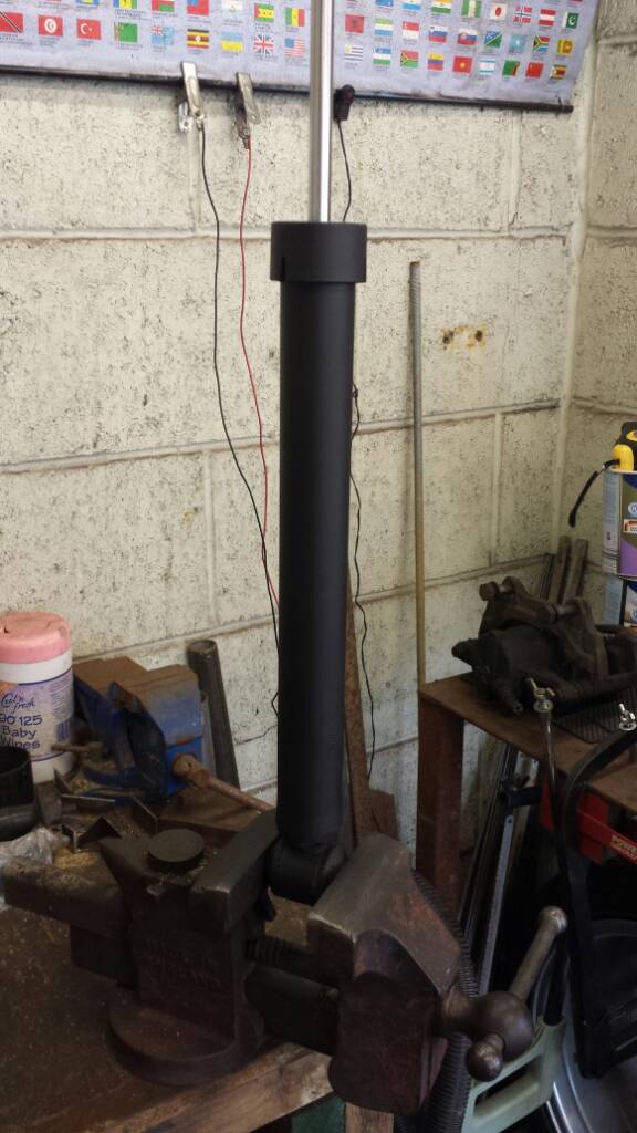

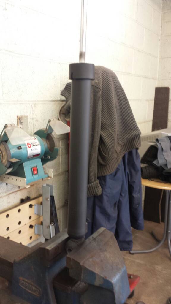

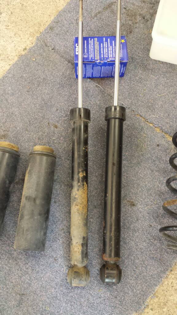

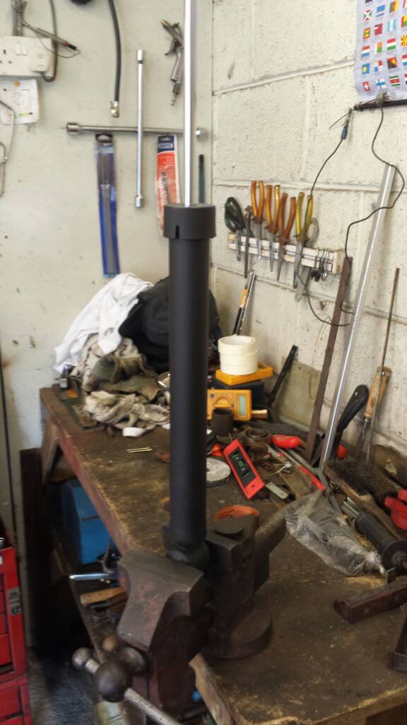

So then today... used emery tape on the rear shocks... got rid of the small rust bubbles... nothing major then sprayed them up with some satin black that has its own chemicals that include primer and an ethcher to stick to almost any metal... the results are second to none... the shocks look virtually brand new, pitty the springs are coated and peeling, didnt fancy touching them so cleaned them up with elbow grease.
Like an idiot.. I struggled, cut fingers, knuckles, bruised hands trying to push in rear springs and then realised... I forgot to let one jack down on the opposite side - doh... lowered other side and springs went in like a hand and a glove... wont forgot that one next time.
Rebounds on rear shocks are perfect, nice and steady... no leaking either...
Fronts should be here by wednesday and already have a plan to get them fitted quick.
I cleaned up all rubbers, casings, repainted rear shocks, and im yet to spray the rubbers with with some silicone spray stuff to keep them fresh (can't remeber the name but you will see the tin in my pictures)
This spray should help everything to settle down with less rough resistance off the rubbers againts the metal body until it wears out (about a week or so) all helps to protect the rubber bushes and spring locating rubbers.
