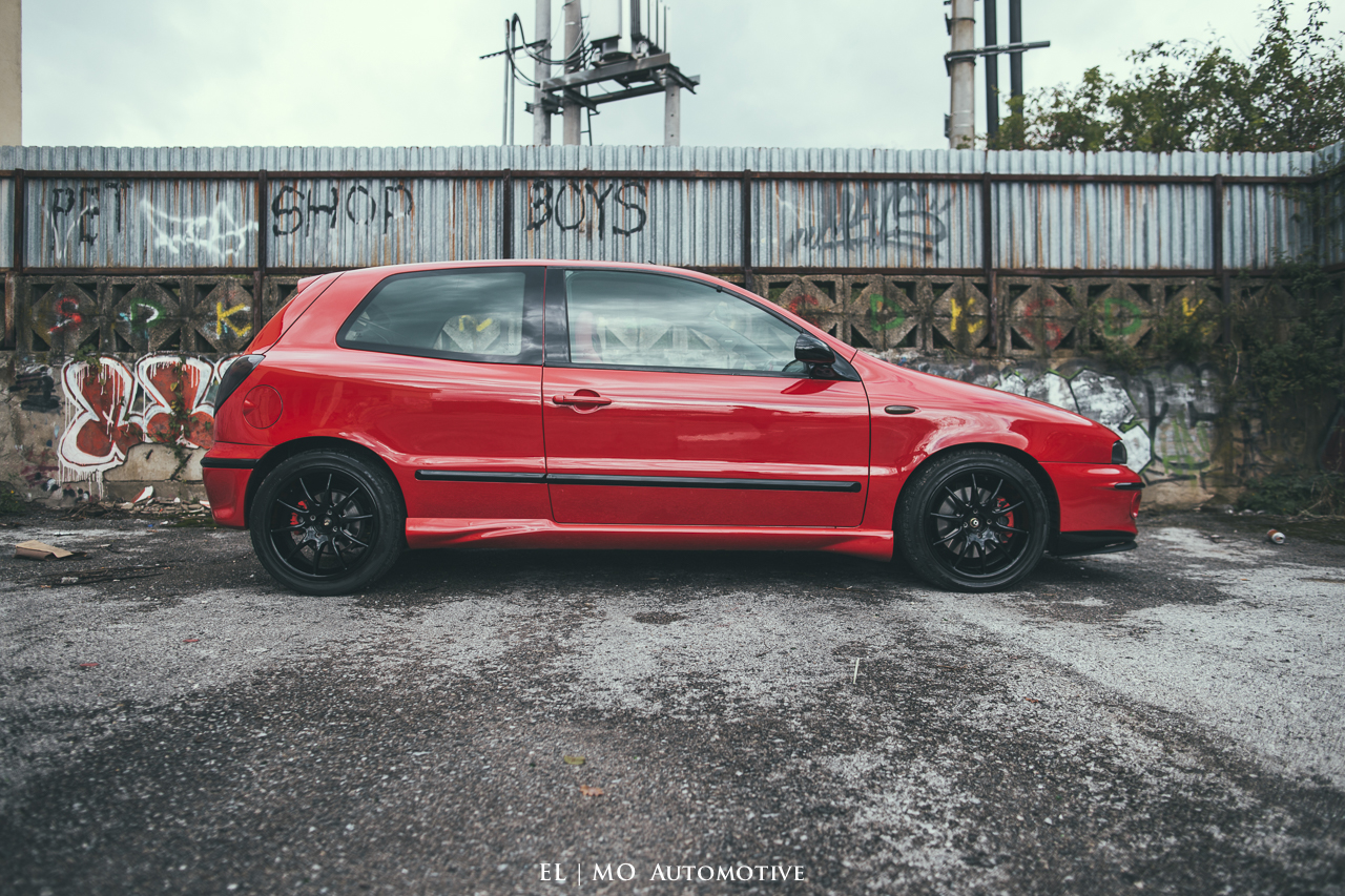

Hey guys,
Currently I am running static suspension kit from Weitec -35/-35 but I would like to go lower.
I would like to buy an adjustable kit, but not like KW for 850e and more ... Do I have some cheaper otpions???
Thanks for your advices.
Hm, Lambo, Delta? What are u talking about? :))
I just want to go lower, reduce a hole between wheel and wheel arch, to make a better fitment :) Is it something unusual or new?? :)

Well, I found one and actual solution for me at this point.
The good thing about Weitec suspesnsion, especially the springs is, that the springs are progressive type, so u can cut a few turns. I meassured everything, difference betweet front and rear and the result was I need to cut one turn from back springs. I did it and the back sits about 12mm lwer which is the perfect number t match the front. I also fit the 15mm spacers, put on Yokohama Advan tyres and guys ... the result is amazing! I can cut corners as hell, the car is even more stable then before adjusting these things and I am so happy about it! But think about warming up the tyres before cutting :))
