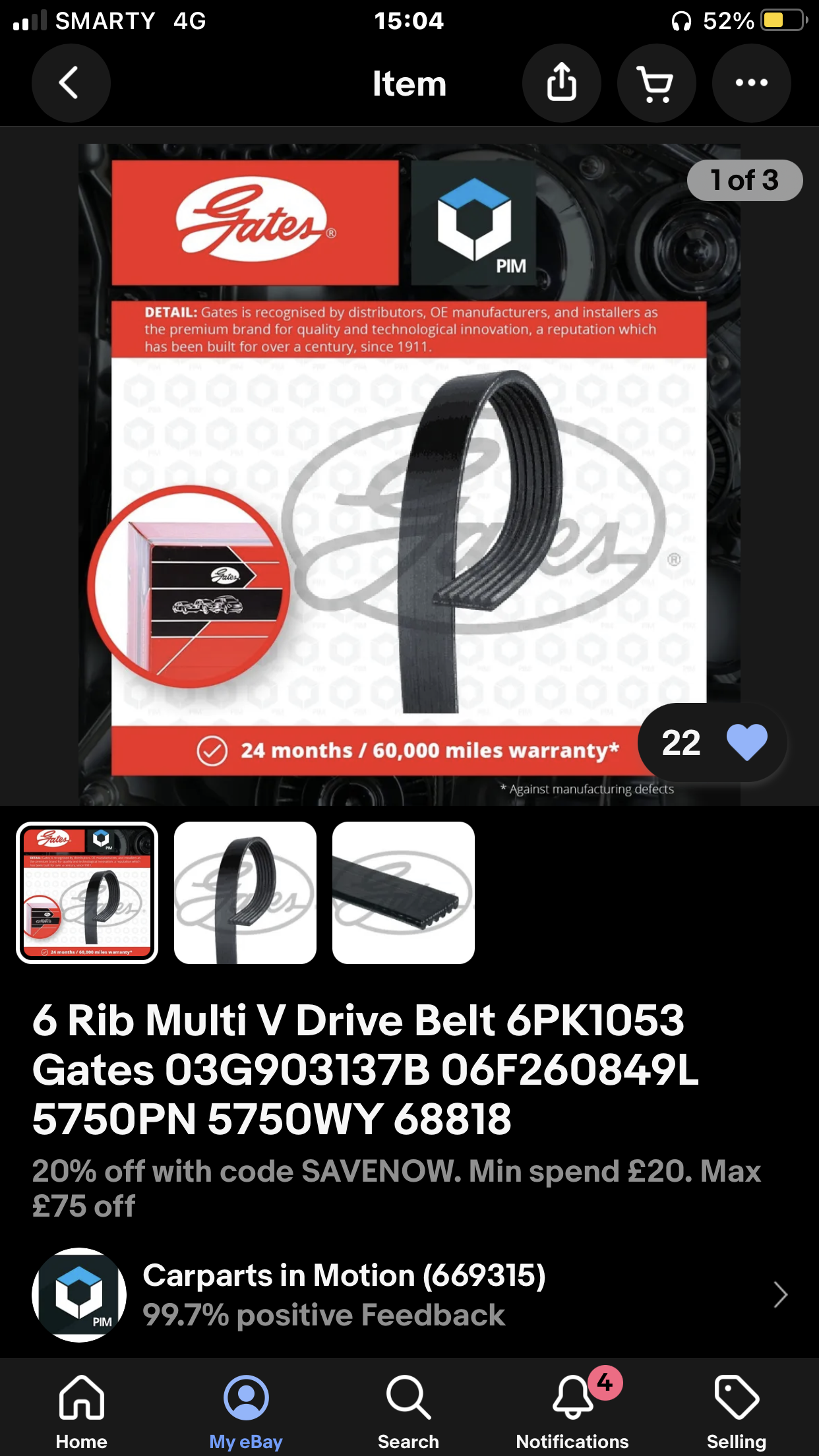

Hi All, just a quick post to let anyone who is struggling to find the correct belt to bypass the dreaded noisy A/C compressor.
I have a 07 GP SPORTING 1.9 Jtd.
On investigation we found that the 1.9 diesel aux belt pulley setup was listed in Autodata as the 1.6 engine!!
So anyway the belt we ended up choosing was a PK1053 Gates. This went around the alternator, tensioner and crankshaft pulleys but bypasses two idlers and the AC compressor.
Hopes this helps someone out
