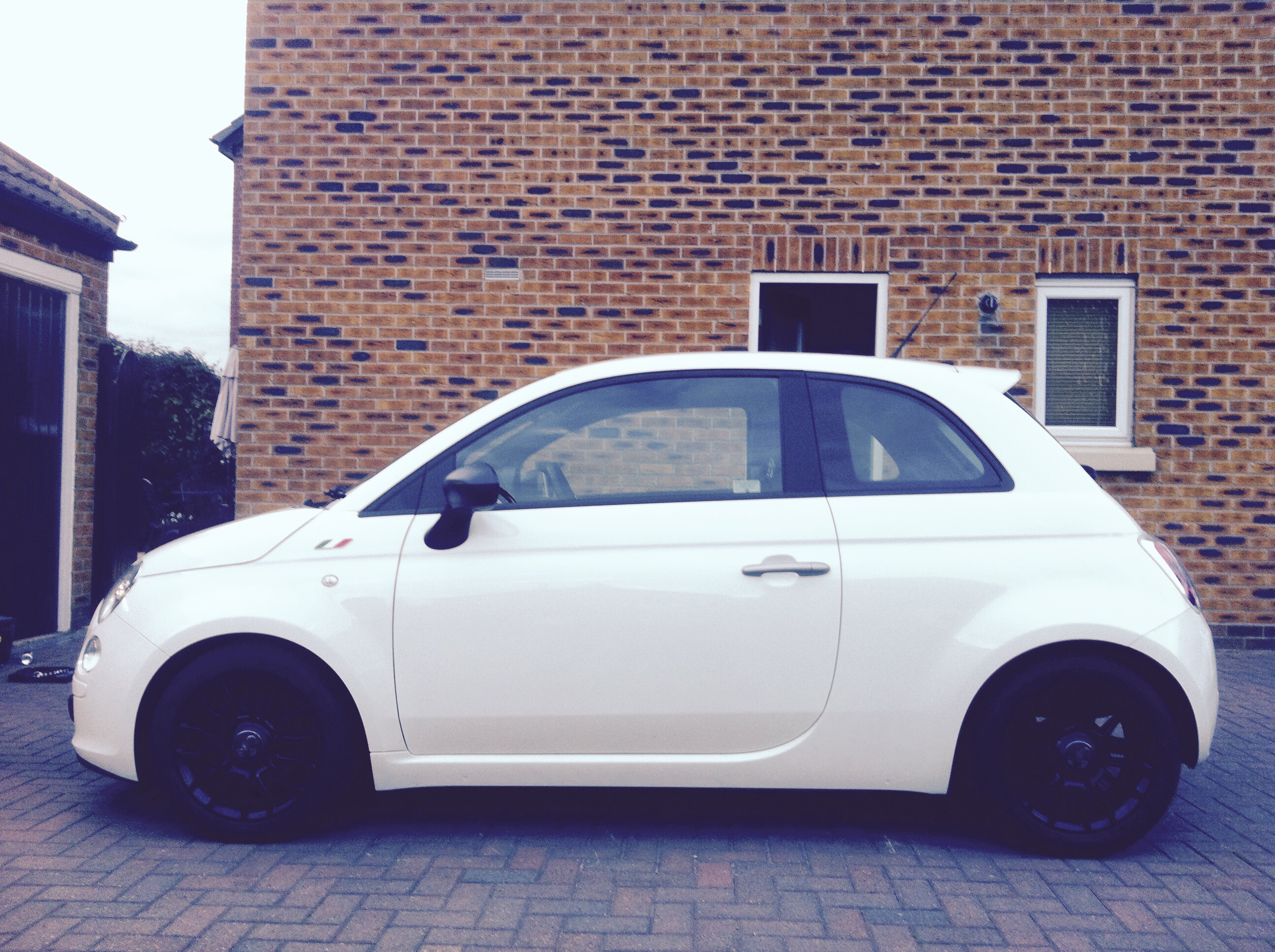

Here's what a 500 looks like on Koni FSD shocks and Eibach Sportline springs.
It's 40mm lower than standard and its a pain in speed bumps. Handling is really good though and not too harsh on bumpy roads.
I had some 595/SS springs at first but the ride height increased as they are designed for the heavier 1.4 Abarth.

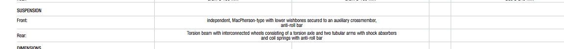

The upgraded rear beam started off in the Abarth. It wasn't from the Ka, it was just that the Ka had it from launch. Ditto the 500c
It's also not an anti roll bar, it's just a stiffened up rear beam and all cars built from the start of 2010 onwards will have it.
It's not an anti rollbar though....... The Italians are famously bad at suspension nomenclature, lots of Alfa Romeo's are listed as having multilink rear suspension when they have MacPherson strut suspension. My Panda 4x4 has an ARB at the rear, but that's because it has independent rear suspension.
I've never actually seen anything reliable which suggests that Ford somehow pioneered the stiffer rear beam, in the media all it takes is one person to put 2 and 2 to get 3 and the lie gets propagated and becomes "common knowledge"

So if Fiat say there's a rear anti roll bar, but in fact there isn't, what are they going to say if someone takes them to task about this?
Is there one, or is there not?
If you go back to the forum thread I linked, you get this as the final post:
In the short period of time I actually had my TwinAir I did peek at the rear beam and mine has the rear anti roll bar.
Still puzzled.
Mick.
I once looked underneath my car and there was a gibbon, Dawn French and Hitler. Just because someone calls it an anti-roll bar doesn't make it one.
