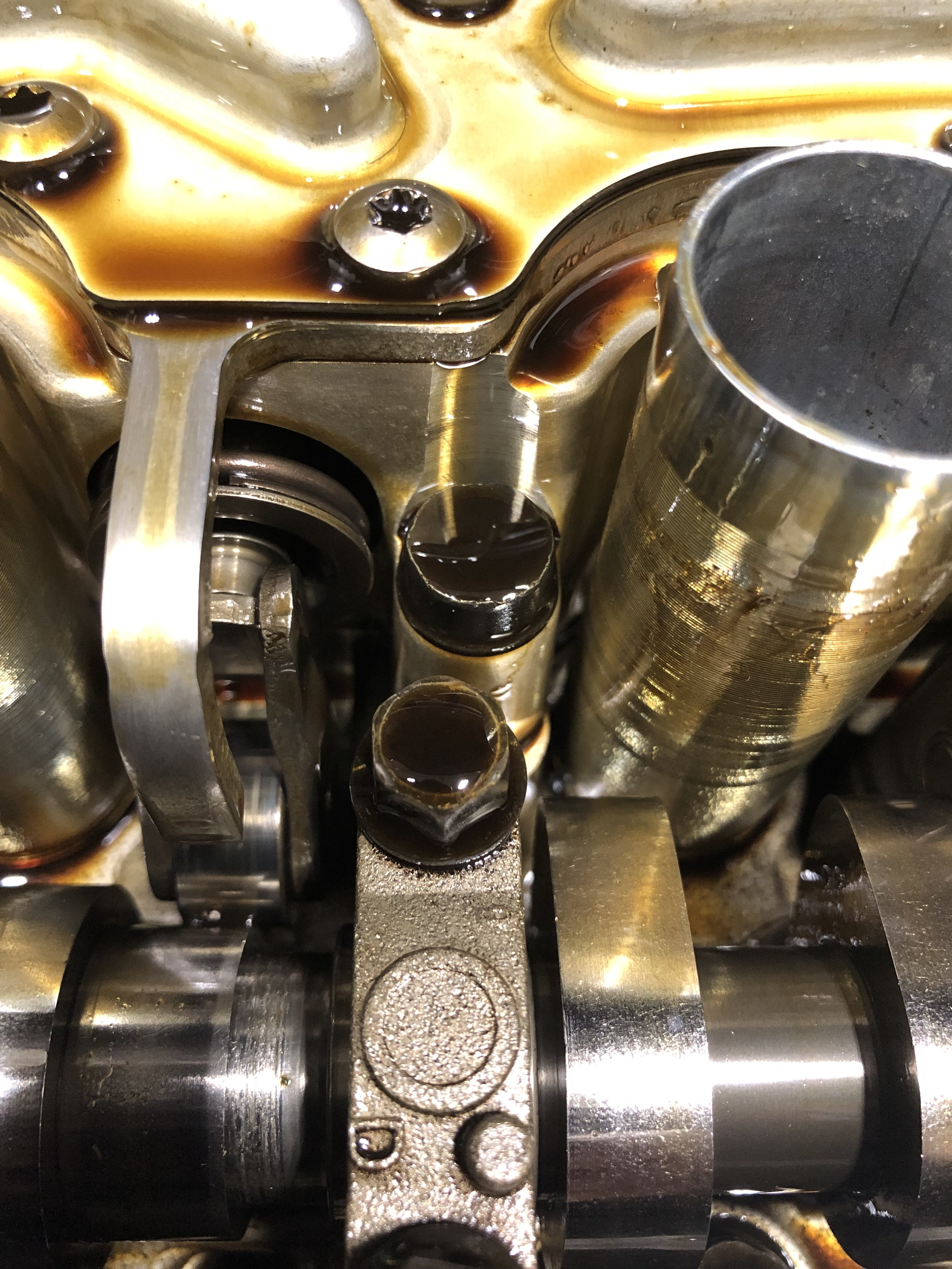

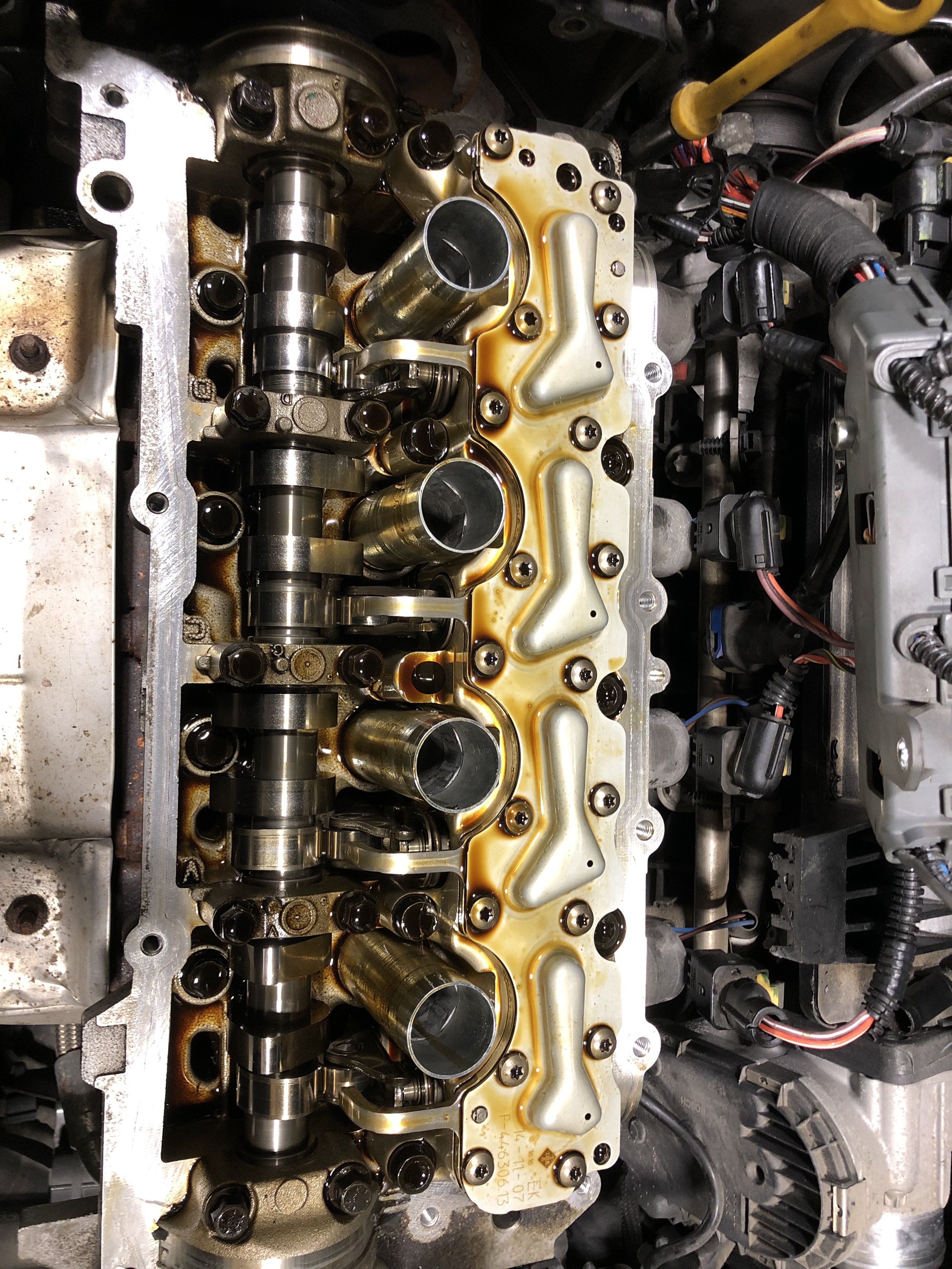

My sisters car has no compression on cylinder 1 and others 150 ish. Investigation found #1 intake rocker is not lined up to the cam lobe meaning sitting half off. Multi air box looks good and moving free but need to know what could cause this and if I need to remove the head and check the intake valves on that cylinder? Need a little guidance since this the first multi air box I have worked on.
I also did a dry and wet compression and made no difference. #1 plug was gas filed and coil had good spark and all other plugs were dark smutty looking. I replaced all coils and plugs and still missing on Cyl. 1
Here is the picture of the rocker misalignment

I know nothing about your model but from a 70 year old mechanics perspective it looks like a pressed on cam lobe has come adrift from the cam shaft in the last pic, not something I have ever seen.
If that is the case. you would be looking at a cylinder head off and a top end rebuild with new cam and follower/rockers etc.:(

Found the 4 followers are stuck. I need to buy one of the pot metal nuts on the multiair assembly so where is the best place to find them cam and fillers and gaskets. I did find a hairline crack in cam lobe for intake love on cylinder one. Help please

Just for my sake, as eyes getting old , was I correct that the cam lobe had moved on the shaft in your second photo? If so maybe the hairline crack/failure caused the "pressed on ?" cam lobe to move on the shaft resulting in the issue. If that is the case I wonder if any other multiair users have experienced it.;)

I think you are correct that the pressed on cam lobe that operates the multi air unit has failed and now spinning on the shaft.
The above would explain no compression.
I am concerned about the ops comment that 4 lifters are stuck......maybe they appear "stuck" due to Multi air system function.
I think I would replace the cam shaft only then check engine function.

Weird. I hav ebroken every part of a cars engine in my mis spent youth. I have never seen anything like that. I also thought camshafts are a cast item that is subsequently machined. Whatever something must have given the shaft a shoch to cause that, or its a manufacturing defect. I would contact Fiat. They ought to be interested at the least and might just help as this looks like a fundamental defect.

Press fit cam lobes have been around for quite some time.
A broken timing belt can result in lobes being twisted on the shaft leading to all sorts of hard to diagnose problems if engine repaired .......it is hard to spot a twisted cam lobe.
