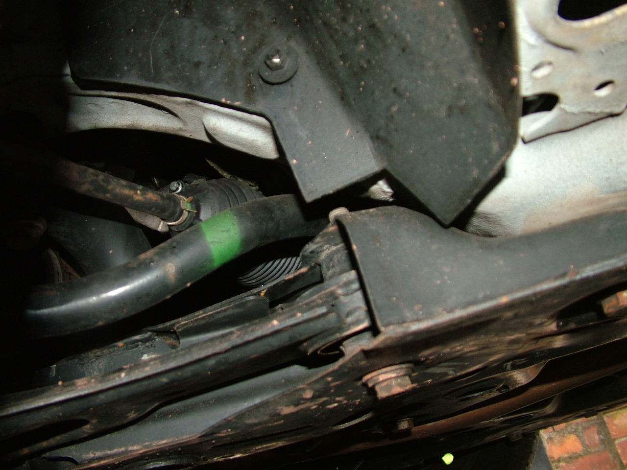

This is my 2010 Doblo Maxi Van n/s/f if any help as bottom tray off at present.

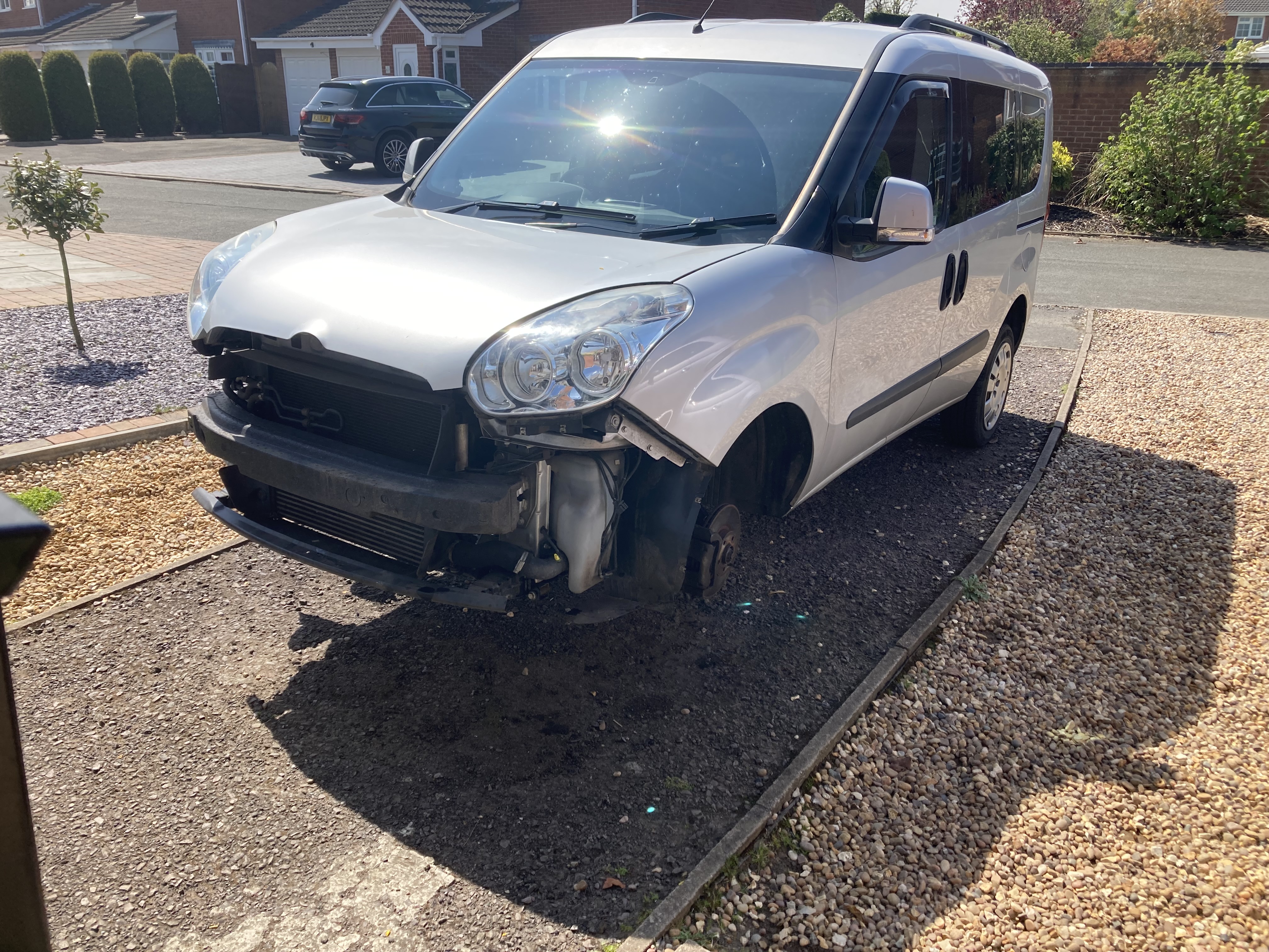

Two hours battling flipping crappy plastic fittings and rusted screws and only just got the bumper, undertrays and wheel arch liners off and out the way! Mine is the next model on and there’s two crash bar legs that have to come off just to get to that horizontal wishbone bolt……hence all the dismantling!
