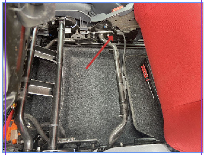

When I lift the Release Handle on the Passenger Seat the seat folds forward but does not move forward on the tracks.
I 'opened' the front seat and removed the plastic shelf and revealed the cable.
I see the cable has failed.
Anyone know what this Cable is called and is there a video on how to replace this?

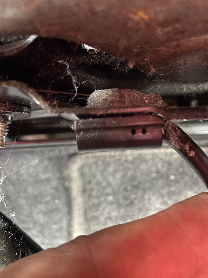

The cable frayed at the 90 degree corner - it runs from the actuating bracket, through 90 degree turn and in the middle of the seat the cable enters some sort of tube/casing.
On the weekend I will look at the tube/casing - maybe it is a junction point between two cables?

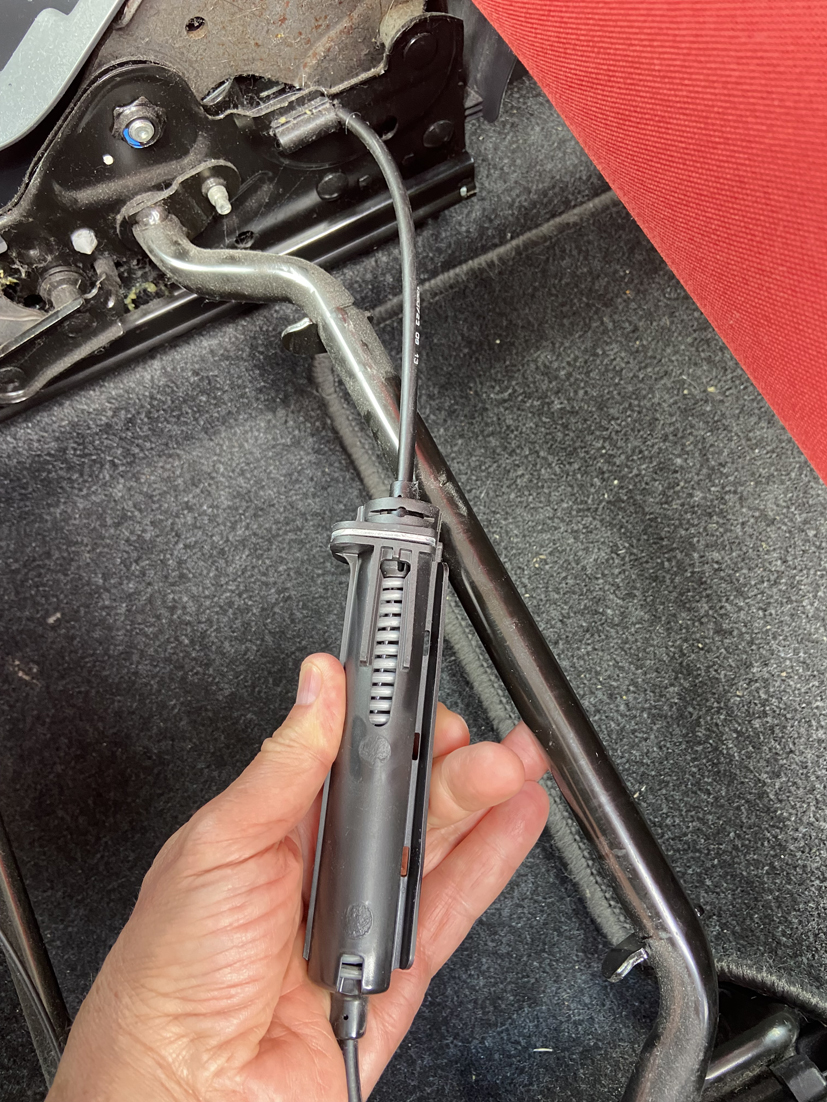

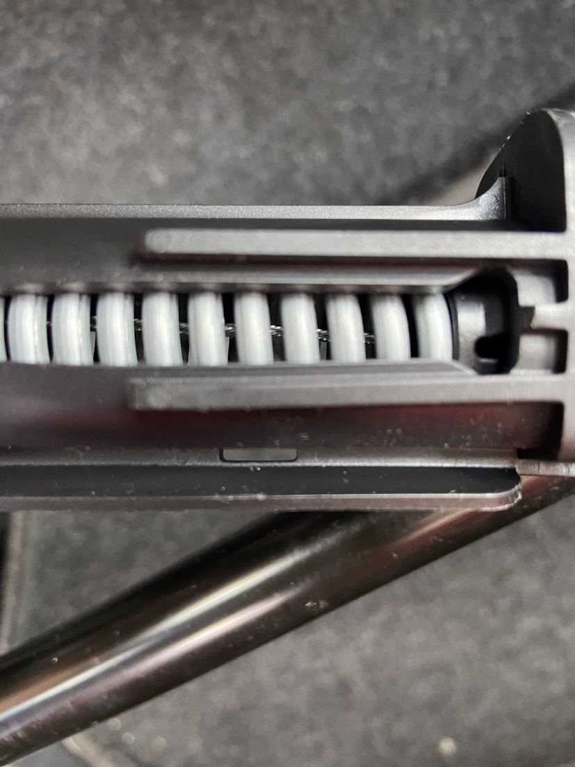

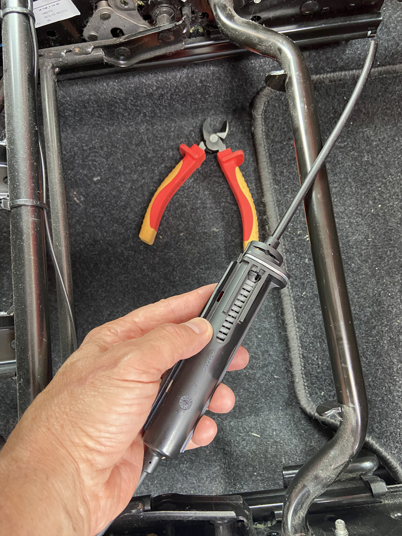

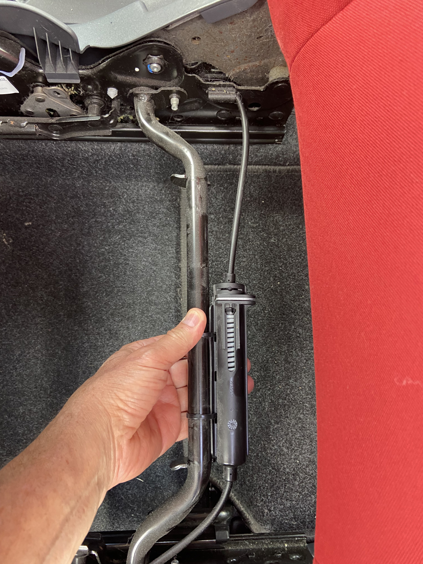

I had a look today - nothing is accessible.
I pulled the spring unit out and it can't be dis-assembled.
No use putting it back so I cut it out and threw in the bin.
We can still slide seat back and forward with handle at front = all good :)
Pics attached.
