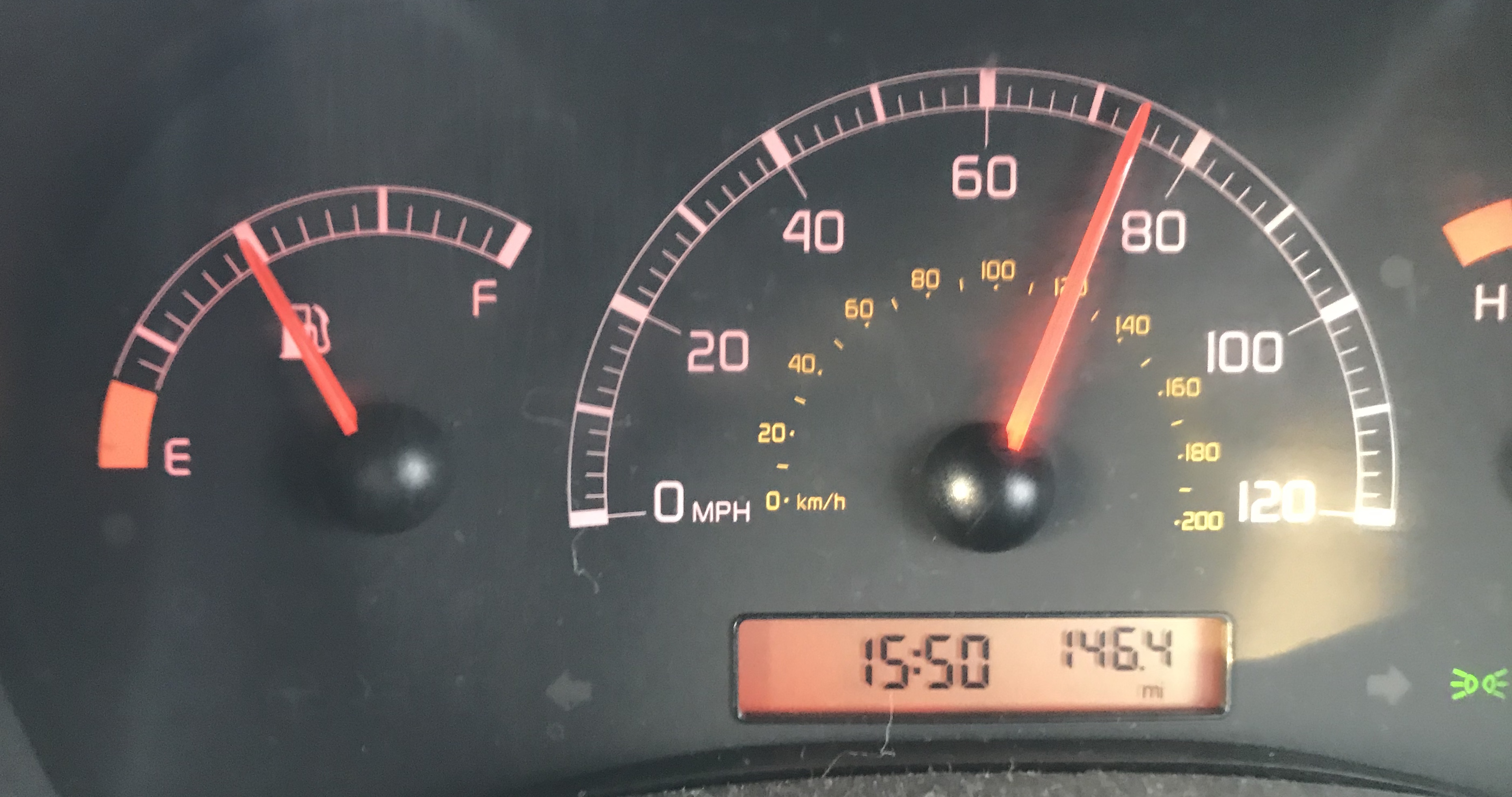

Hey Gman-
sorry not to get back to you sooner. The last 24 hours have been exciting, partially due to the most frightening drive of my life, shortly after I was on the thread the other night.
I should NEVER have taken the Panda up the A9 in the conditions of Tuesday night. Anyway; that's another story!

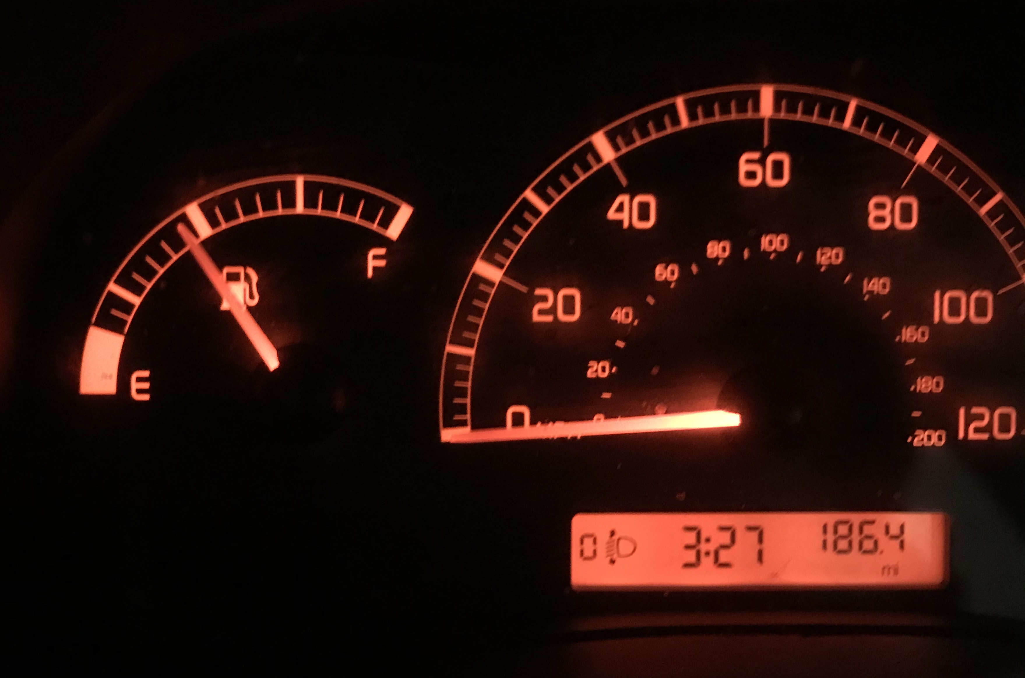

two images here; the first is (as shown) at motor speeds coming up from Lincoln last week, and the second (backlit & stationary) is the consumption as I reached Inverness on Tuesday night, at somewhat more sedentary speeds.
I'm sorry I didn't get the 2nd image at bangon the half-tank; I was unable to take a hand off the wheel at that point.
Thanks for that! Your first image is about the same as we get on shorter journeys mostly...
The second one is a lot more impressive. By that mileage, our fuel guage would be 2-3 chunks below where yours is. But that is with sub 10 mile journeys.
