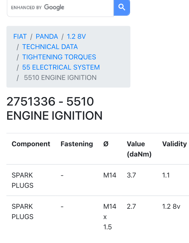

Our dear old friend John Haynes recommends 18lbsft (25nm) which is a decent figure for the likes of a M8 bolt to give you some idea.Not quite the same problem, but I cross threaded one a while back. My local man fixed this and charged 1 hour which seems pretty reasonable to me. Torque figure he quoted me was 18 somethings which is not a lot. If they have all been over done and the threads stripped Its a head off job I agree. New plugs havbe compressible washers so trying new plugs might help?
